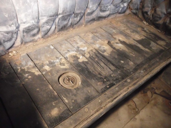

In tinkering with my 22, I see a sort of shelf on either side of the body under the seat that looks like it supported a set of boards over the gas tank similar to the one shown below. I have been looking through my books and can’t tell if the 22 should have one. If it should, it would be easy to make. I have seen posts saying that they were made from 5/16 thick boards.
One thing my car does not have is a board along the metal panel in front of the seat. Not sure if it should be or ever was there.

What is shown in the first photo is a factory gas tank hinged cover/lid/door for a touring or roadster. Note that it has two hinges near the seat back.
Depending on the year of the car and/or manufacturer of the body, they were wood or stamped sheet metal. The wood covers typically have two hinges while the stamped steel covers have three hinges. I'm not an expert, so you'd have to actually talk to someone that has actually researched it to see if they were ever dropped from production.
Some tourings also had a hinged sheet metal or wooden cover over the rear seat compartment (where you stored the side curtains and tools, etc.). I believe that the rear seat compartment cover was dropped sometime during the 1917 model year. Again, you would have to consult with an "expert" who has studied the subject.
Both my 1917 roadster and my dad's 1917 touring have stamped sheet metal hinged covers over the gas tank. These cars have known histories since new.

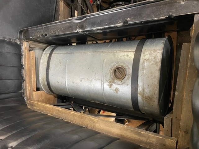

Does the car have the round gas tank or oval?
Keith
Keith
Reno Speedster
Topic author - Posts: 639
- First Name: Morgan
- Last Name: Blanchard
- Location: Anchorage, Alaska
Re: Boards under the seat on a 1922 roadster?
My car has an oval tank. From what little I know, I would not at all be surprised that there are great variations between the bodies. Since there seems to be great variation in so many other things. I am interested in getting the car to be period correct, but I recognize that the car has a history and things were commonly done in period to fix issues or make repairs. My goal is to have a good driving car that looks pretty nice. My seat springs sag a bit which along with what looks like a shelf for a lid got me thinking. I think I will make a lid when I get the chance. Not sure if I can find the crate material, but I can make do.

Is the frame around the seat made of wood or steel? If wood, the cover would be made from wood.
If it is steel, you would be able to see a couple of hinge holes in the frame where the hinges were riveted on, if it at one time had a cover.
Take a look at the photos in the post above and post a couple of photos of what you currently have.

I don’t see any hinge holes but I also think there is a chance that the wood is not original. Here is a picture.
