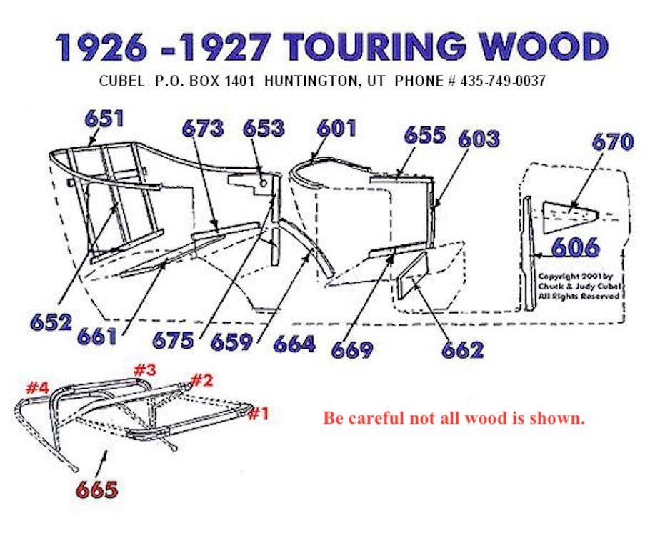

First we need a picture of the wood.
This is from Ford Wood. I used their numbers. They are great to work with.
Now for all the parts that come in a kit.

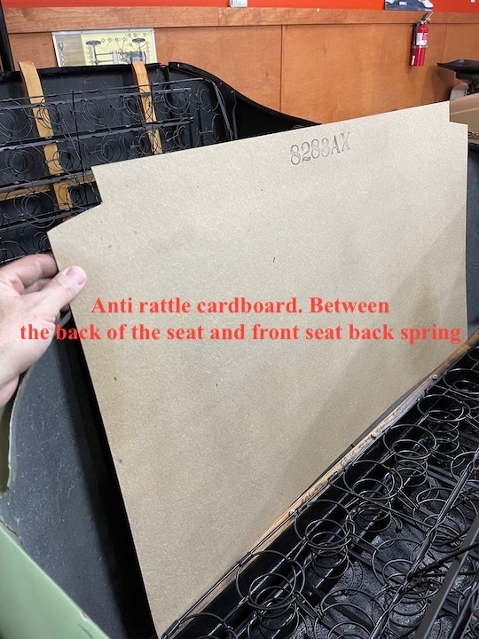

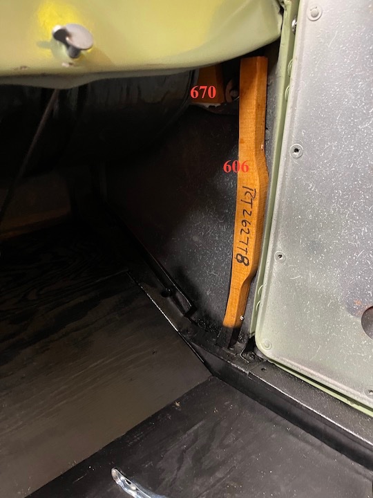

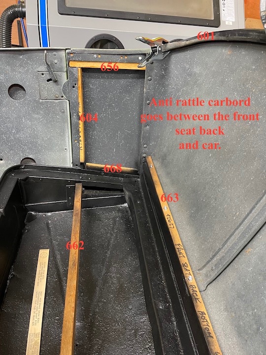

Now let's see where it all goes.
Mopar_man
Posts: 1195
Last Name: Govoni
Location: Fredericksburg, VA
Re: 1926/7 Touring Interior Wood By The Numbers
Post by Mopar_man » Tue Dec 20, 2022 1:11 pm

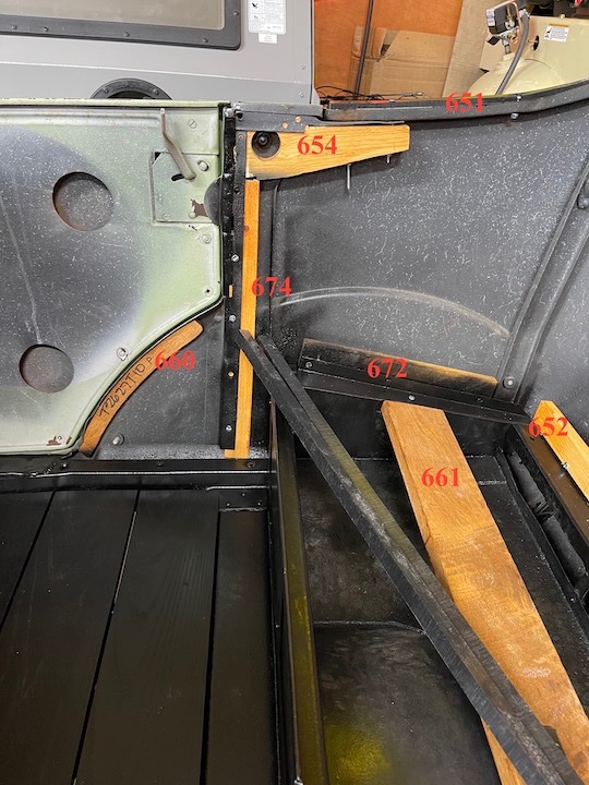

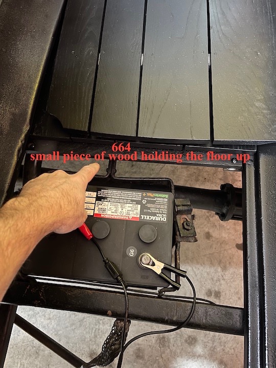

Now the back.
Now you will have to sand, file, shape and make the new wood fit the old body. But don't worry you'll never see it. I also stained the wood with Deck stain to protect it from water. The plastic tack strips are molded in with a heat gun.

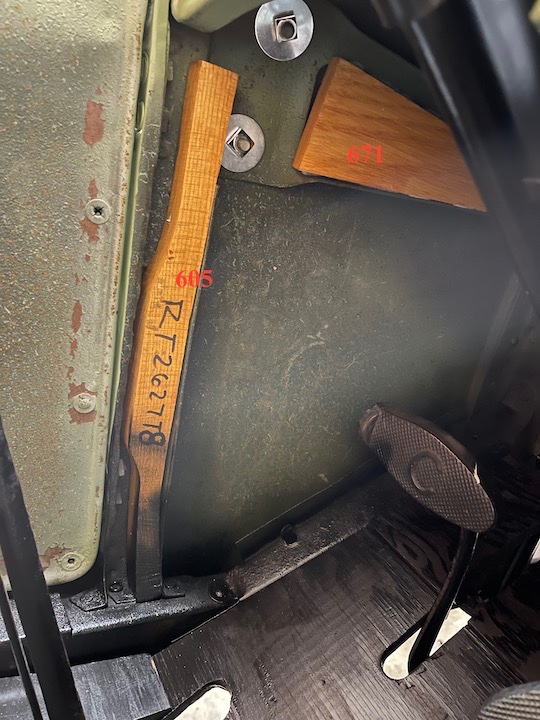

Robert, did the 662 seat spring support board come with notches at ends to clear the metal frame? The Fordwood drawing looks like there are no notches. I made a board for my Runabout and I notched it to make the top of the board flush with the top of the seat frame.
My car also did not have the 605 and 606 boards. I made them but have not installed them yet. I don't think I have the geometry correct. The metal flanges that 605 and 606 fasten hold the kick panels about 3/16" away from the body flange. If I install the kick panels, there is a gap between them and the body where I can clearly see the wood blocks. The bottoms of the flanges (see the yellow arrow below) also curves outward and makes the kick panels stick out there. I was thinking of beveling the face of 605 and 606 to let upholstery nails bend kick panels to meet the body flange. But, there would still be a gap at the bottom due to the curved flanges.

Mark,
Yes there are notches on 662 to support the seat spring. I had to cut mine a little more to make the board flush with the top of the frame. As for the other ones that you made I'd just sand them down to fit. I had to do a lot of sanding and filing to get everything to fit. I bet when I start to put the interior in I'll have to adjust some more. I can only imaging how much these care have been through over the years. Seems like everything has to be custom fit. I should have paid more attention in wood class. Ha!!
