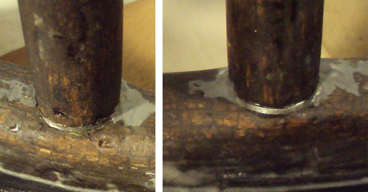

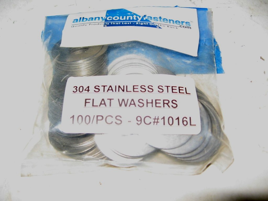

Hi all. I was recently faced with the task of shimming some loose spokes on my scrappy 1921 Touring.
After unsuccessfully trawling the local hardware or auto parts stores for anything that was large enough and thin enough for the task, I turned to my box of aircraft hardware and pulled out a bunch of AN960-1016L washers.
... which I then snipped...
... and slid in-between the spoke and the felloe.
As you can see, they are an absolutely perfect fit in both inner and outer diameter and the thickness (1/32") was spot on for my application (if you need to fill more gap, washer AN960-1016 (drop the 'L') is thicker, at 1/16")*
Many thanks to MTFCA member Ron Horton for the exceptionally generous loan of his spoke jack.
* this all said, I do not condone shimming the spokes on your car. I don't know what I'm doing. It is both stupid and dangerous. Buy new wheels.

Good solution. I found these on Ebay a few years ago, they are 1/32" thick stainless steel. :)

I use Chevy valve spring shims, you can get them in .015 and .030 and then cut them with tin snips. If you live in a dry climate, perfectly good wheels can dry and get loose. As long as your spokes are in good condition there is nothing stupid or unsafe about shimming loose spokes.

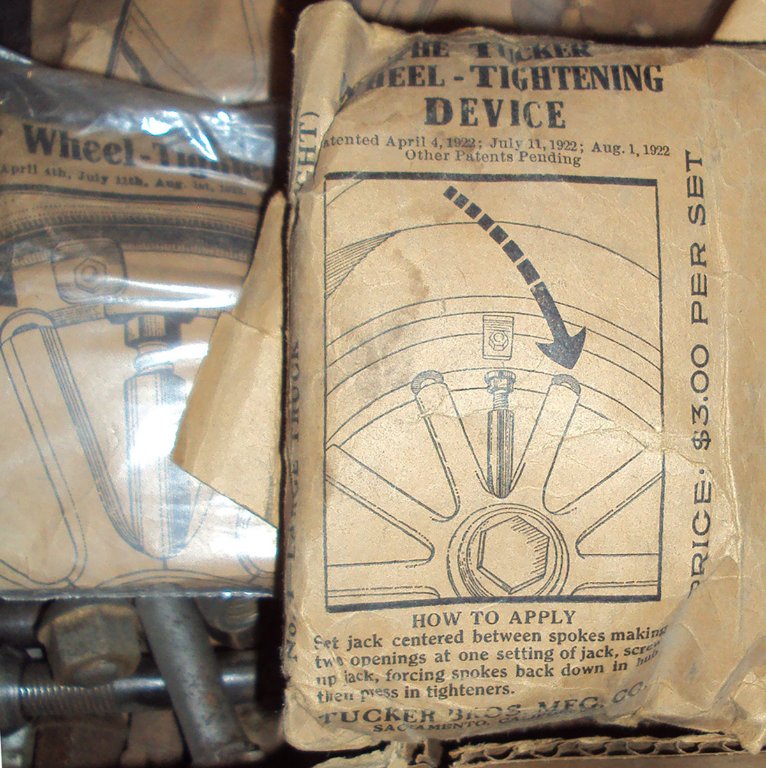

The install process picture shows the spoke jack on a complete wheel/rim/tire. There is less strain & possible damage to components if you remove or at least loosen the rim away from the wheel.
I did this process on a sedan 30 years ago. The wheels are still tight under the most harshest service.
The correct shim job requires shims added in pairs on opposite to each other spokes. Not all 12 spokes need be done. if 2 or 4 or 6 shims get all the spokes tight, you are done. Of course the spokes must be solid, including the tenons. Rotted wood cant be fixed safely.

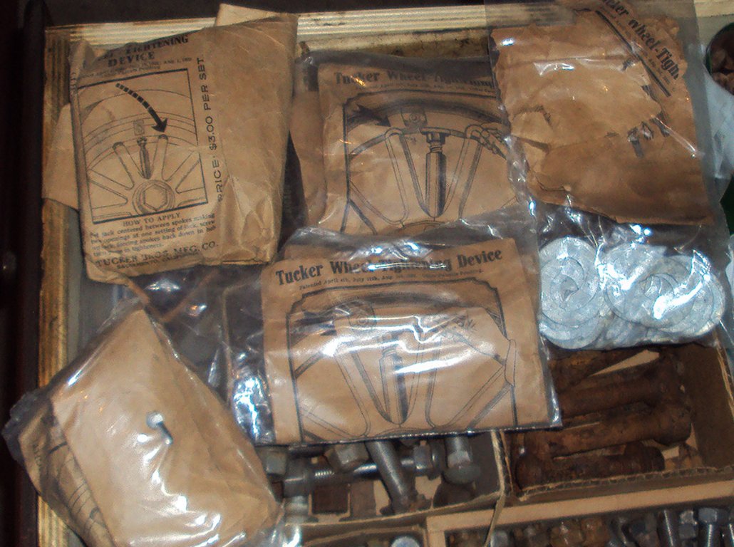

There is bound to be some stashes of these laying around.
Most of mine are odd sizes. I make my own from 16 or 22 gauge. They need no slot as I use them in wood felloe wheels that I disassemble.
As always, BE Cautious of Shimming or Rebuilding Wheels. New wheels from the Wheelwrights are the Best Insurance against Catastrophe.

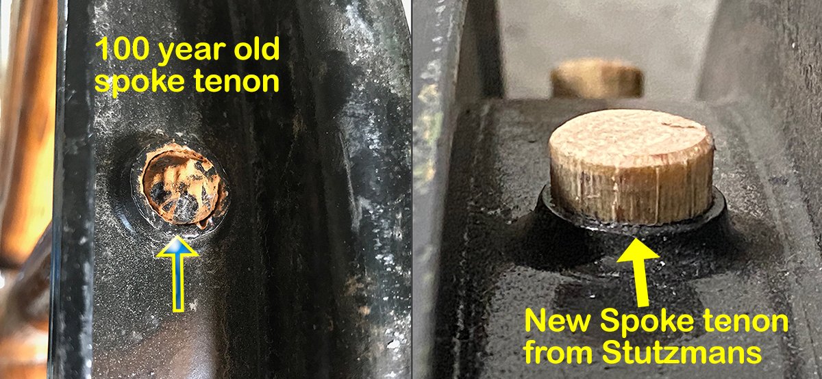

And if you use those split washer shims and spoke jack, you've loosened the tenon in the felloe and the bearing surface between the crescent washer on the spoke end is reduced to about 75% of full contact. The spoke is 'tight', but the tenon is loose and the endgrain of the old wood spoke is subjected to 133% of the original compression stress. Please don't drive near any of my family with this car. jb
