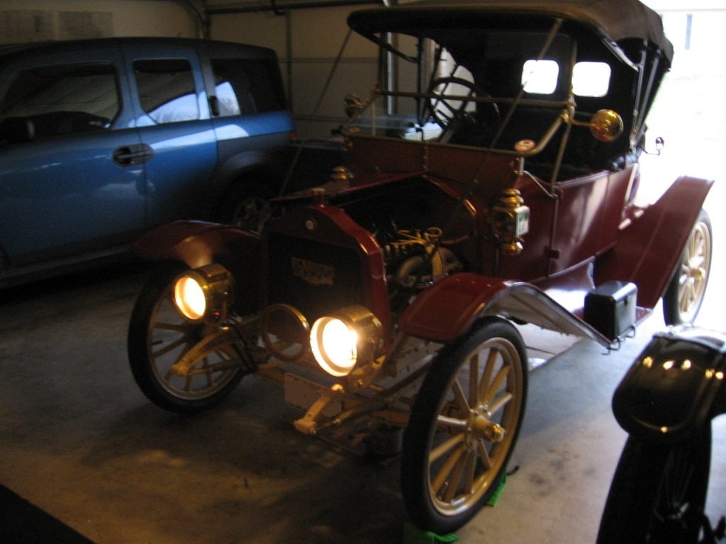

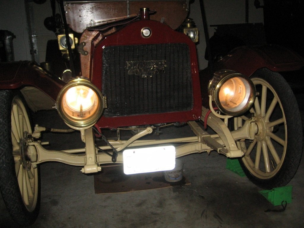

A bit OT, but here are a few pictures of the lamps lit on my 1912 Flanders. Note that the burners are oriented so that the "Y" faces parallel to the axis of the car. A lot of folks orient them so that you can see the "Y" from the front, this is incorrect.

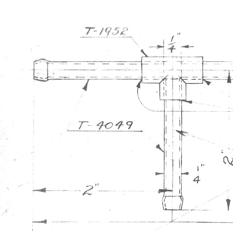

You need to fabricate the crossover pipe. It solders to the fins of the radiator.
The "tee" and two small 2-inch pieces of tubing are shown below. The single long piece
not shown in the cropped photo of tubing is about 14-1/2-inches on my Brass Works radiator.
It lays against the fins, "tee" on driver side of radiator, soldered, and is about 1/2" lower
than the gas hose holes in the side panels. The fan is close, so securely soldered.
If someone has the "factory" length on the "14-1/2" piece", please chime in.

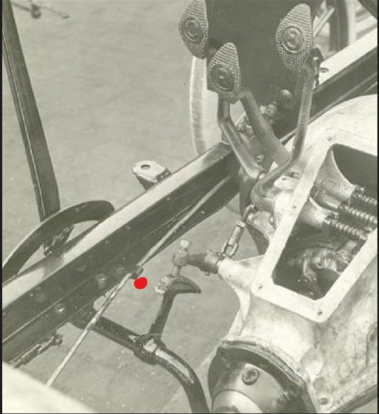

The "Rear Gas Line" is a single 44" long piece of your brass tube and is held by a single clamp as shown
by the photo at the red Dot. It slides forward through the hole in the wood engine mounting block.
The tube lengths are: Two each at 2-inches, one at 44-inches and one at 14-1/2-inches.
CROSS-OVER DETAIL MID 1912 THRU 1914

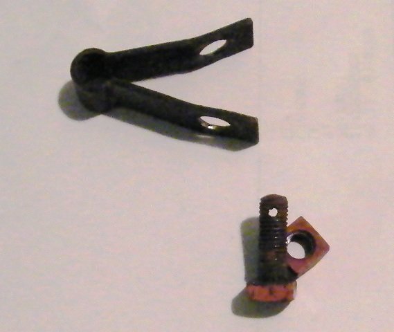

REAR GAS LINE CLAMP
REAR GAS LINE CLAMP
CLAMP rp.jpg (39.88 KiB) Viewed 2915 times
RED DOT NEXT TO CLAMP

Type in brass 1/4" Tee on ebay. With a little lathe work their tee is remarkably close to the original, It's just a wee bit smaller. I typed in 5/16 thinking the body would be larger. It was .010" smaller.

Does the original print give the total length of the tube?

It probably does and would likely be the bottom dimensional arrow.
That's all I have ever seen posted of that drawing.
