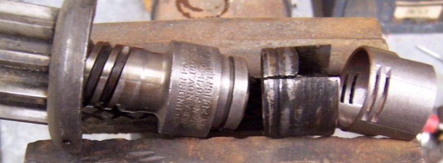

You can usually tell from a close visual inspection if they're okay. Post a bunch of detailed photos of it and we can be of more help to you.

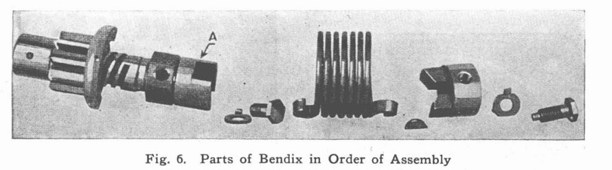

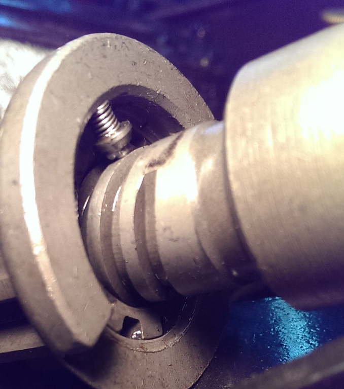

Clean the Bendix very well, then as Jerry noted, check visual for the working condition. Look for cracks in the drive head, loose counter weight ring, torn thread holes in the shaft, and presence of the drift pin, etc.
Then if good, then oil with engine oil, and spin the gear by hand to have it run up and down the threaded shaft without sticking. Then of course use a new spring, and new fasteners, be sure the bolt heads are proper height or they will impinge on the inside of the Bendix cover.
The drift pin is very important to keep the Bendix gear out of the ring gear when the engine is running, vibrations can make the gear move toward the ring gear if the pressure exerted by the drift pin in the counter weight ring is compromised.
