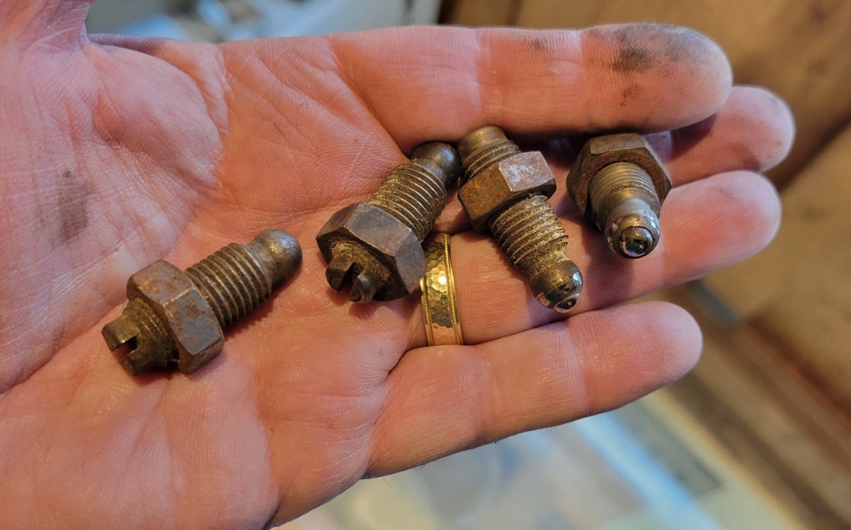

What are these? They were in with some Model T tools and parts.
They kind of resemble clutch finger screws. Opposite of the slot end is a spring loaded ball. Model A perhaps?

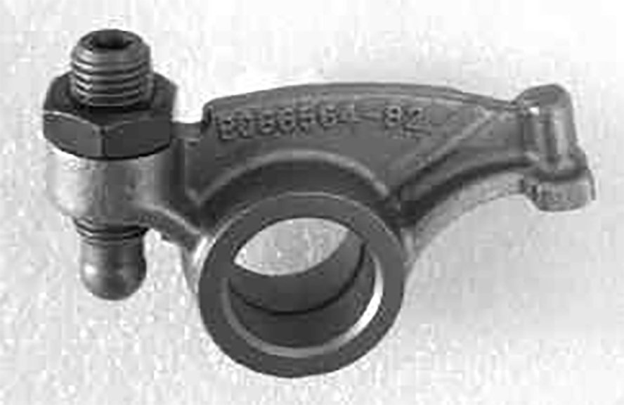

Part of the rockers on an overhead?

Look like rocker arm/push rod adjusters. Could be T over head or another overhead car manufacturer.

Reminds me of Y block Ford rocker arm adjusters.

Most of those pictured appear to be 216 Chev.
