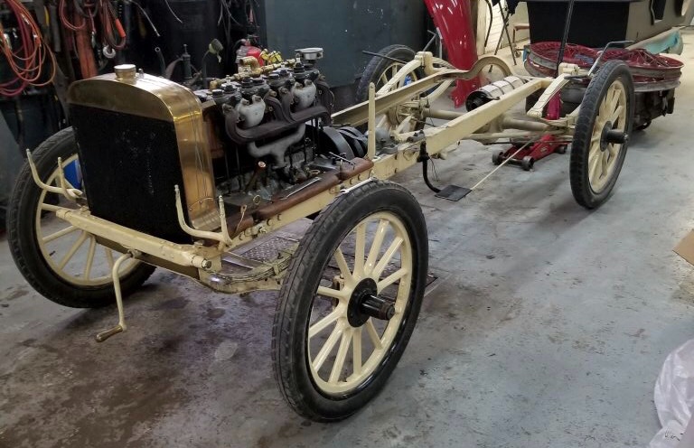

Something one doesn't see everyday - 1905 four cylinder Ford with her clothes off....

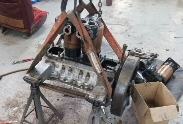

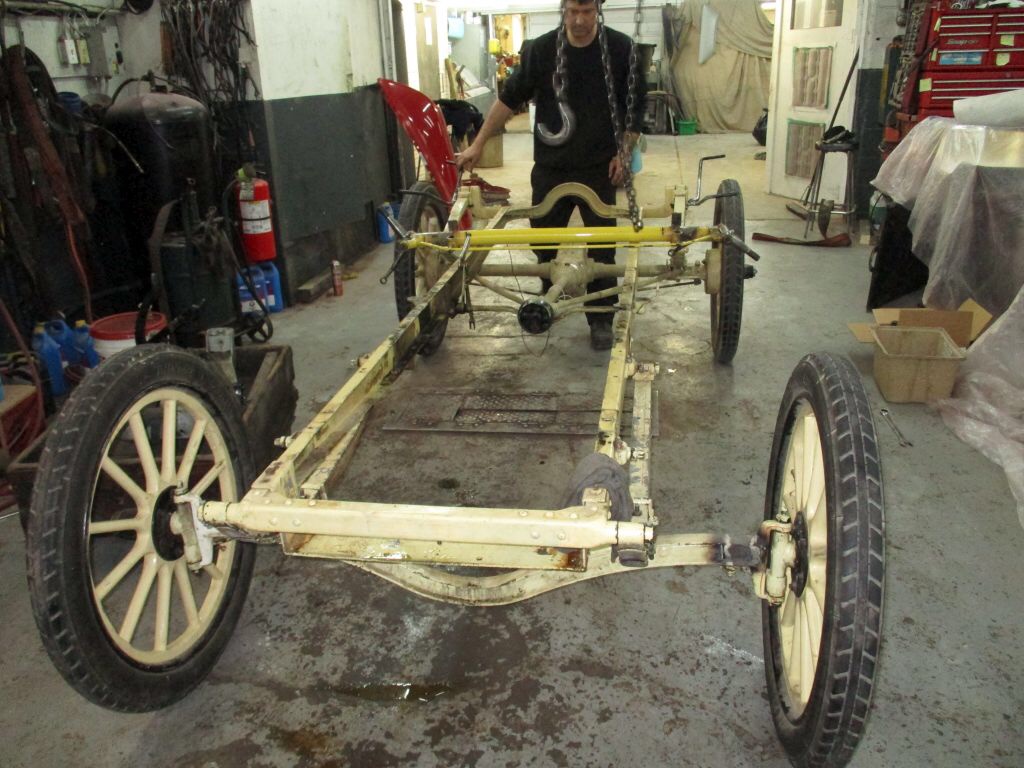

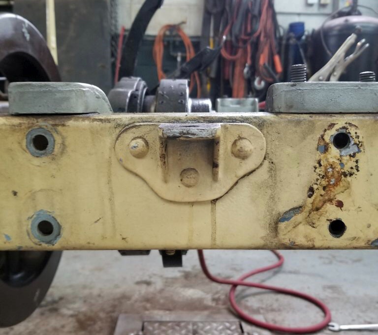

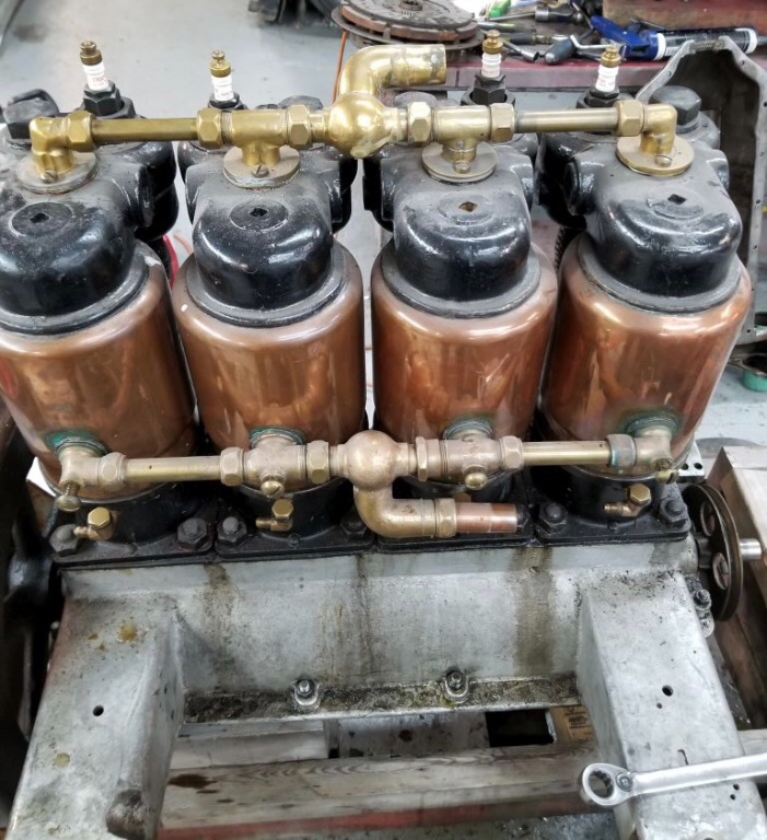

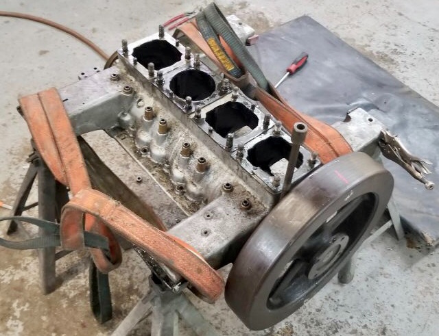

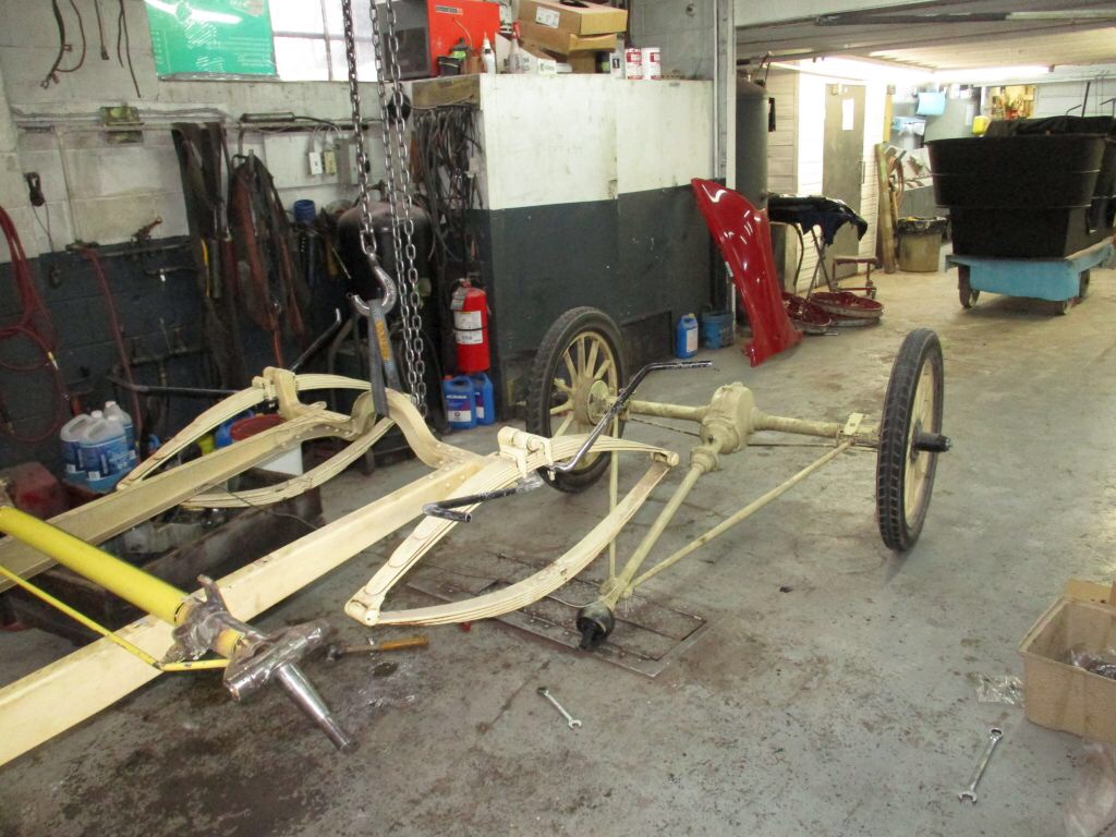

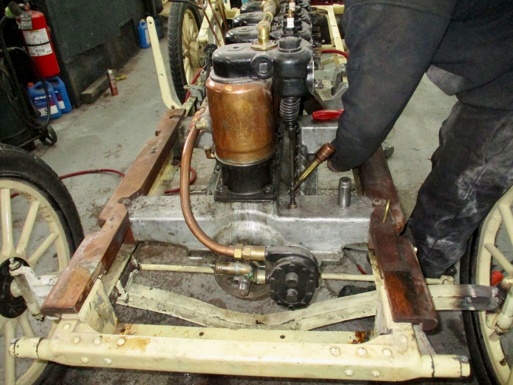

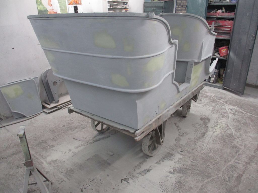

The "B" is at Fawcett Restorations in Whitby, Ont., Canada. Peter and the guys are getting it all apart. The body and hood are in primer, and the motor and chassis are apart now:
Rob

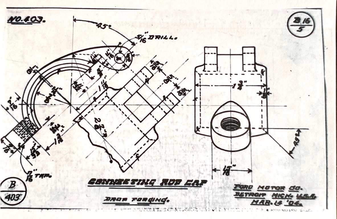

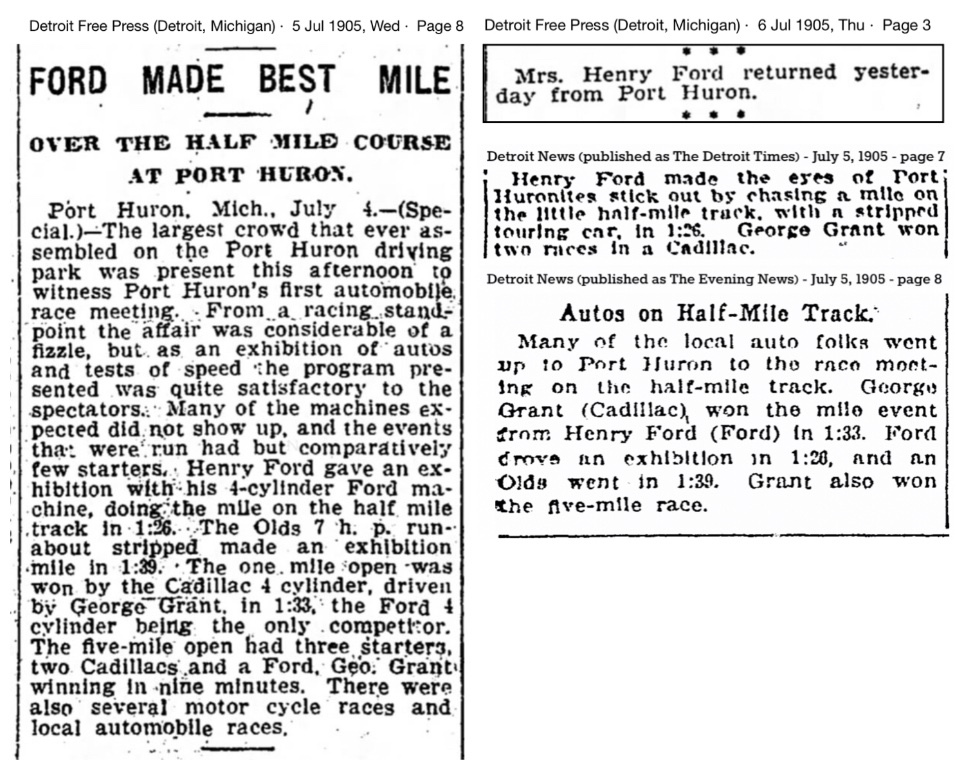

I'm posting this to show how early Ford Motor Company had the "B" drawings. Ford ordered 250 of their patented differentials from American Ball Bearing in early 1904, and I believe much of the chassis on the B was actually planned for the four cylinder air cooled car Ford announced they were going to begin marketing in late spring/early summer 1904:

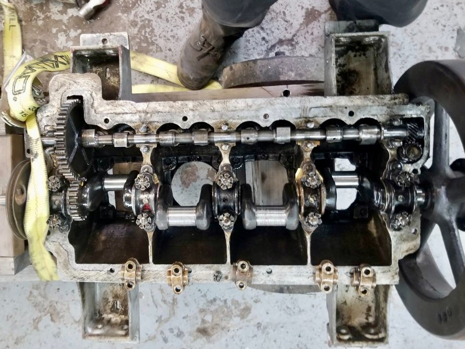

Thanks for the pics Rob. Especially of the engine. It will never cease to amaze me of the engineering and manufacture of these early engines, and that they actually RAN!!

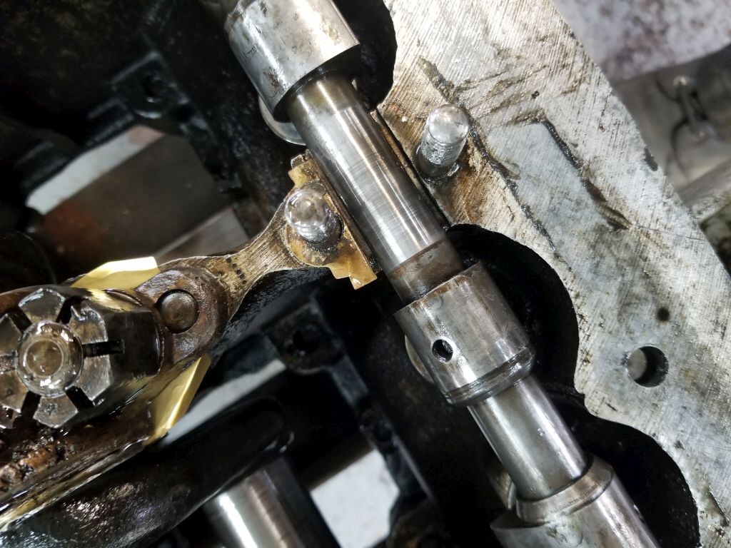

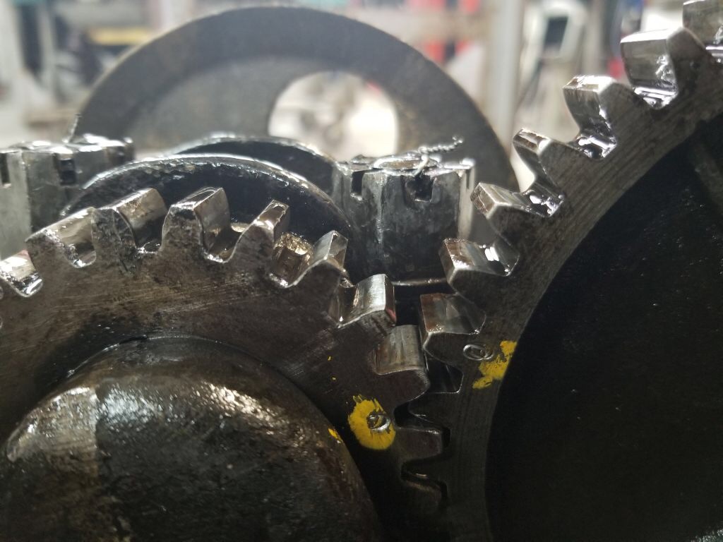

Rob, is it just me -or is the timing on the crankshaft gear and timing gear off by one tooth??

Thanks guys. I am always impressed and in awe when looking at the early Fords (through the Model T), and the progress Ford was making. When most low cost cars were one cylinder, Henry Ford, from the start, used two cylinders. For 1905 (beginning in late 1904), Ford, like many high end producers, went to a four cylinder car. In addition to Ford, several high end well known producers came out with a four cylinder model. Then, in 1906, Ford again went one better (actually 2), with a six cylinder. Each time, his next model was the lowest cost in that class.
Brent, we've had a hard time deciding what valve timing combination to use. The B seemed underpowered (283 c.i. with 1700 lbs. chassis/body). Set on the original (dots) timing, it started great, but seemed sluggish. We're still not sure where to run it. Accounts I've read indicate the car should easily be capable of 40 mph. Ford advertised it at that, as well as advertising the F at 35 mph and C at 30 mph. Both the F and C that I'm familiar with will make that time easily. Our Model F runs very easily at 30 mph and 32 actually is a "sweet spot" for it.

Looks like the cam was retarded one tooth. This probably had a huge effect on how it ran, and not in a good way.

Re: Something one doesn't see everyday - 1905 four cylinder Ford with her clothes off....
Dan,
It didn't seem to make a big difference. However, when we changed it (to where it is in the photo), the car no longer started on spark after priming. Initially, I could pull it through three times after choking, and then start on the switch every time. Who knows, our "electrical/timing" problem may be carb related....?
While the B didn't develop the racing reputation of the Model K, Henry Ford did put it through it's paces. In this article, it made about 42 mph on a 1/2 mile track, turning in the fastest time in Port Huron at a local race in 1905:

Rob, I concur with Erik and Dan that it appears the cam is retarded by a tooth. As I am sure you already know, advancing the camshaft timing generally picks-up low-end power but at the sacrifice of higher RPM power, ...and so retarding the cam could/should have made it have its powerband stretched into a higher range. FWIW, I would think the location of the valve timing should not have affected the starting as this should have had more to do with ignition timing since at TDC (-or just after) both valves should have been closed to seal the compression/explosion when the spark was introduced. If this later valve timing did affect it, then I wonder if a mis-broached keyway on a timing gear has valve timing affected where the vacuum on the stroke on the subsequent cylinder (-after TDC) is not optimum.Erik Barrett wrote: ↑Fri Jan 13, 2023 2:14 pmTiming is everything, as they say. Must have not run real well.
Have you considered having the camshaft profiled? In our motorsports world, we have access to a mapping machine called a Cam Doctor. I am sure there is a shop near NE, IA, or Ontario that has one (-or something similar) that can map all 8 lobes for you. The software will follow the 360°rotation of each lobe on the shaft and it will tell you what the centerline of the cam is, and if any of the lobes are advanced/retarded in relation to TDC on the crankshaft, and even how much duration or lift it has at any given location. It would be a piece of mind to to know if all lobes are pinned in the proper location, -or whether you have one or more where the pin was mis-drilled causing altered timing. You may also find the timing mark was mis-stamped at the factory?? In the motorsports world where we are trying to extract every ounce of efficiency, we subscribe to the theory that 4 Ponies hitched together will outpull 2 Ponies and 2 larger Horses hitched together simply due to the harmonious pulling of the equally yoked, ...and I realize I have digressed in a different path for this engine however since the cost is not that great to have this cam profiled, you and your team may want to explore this a tad and see if it would be a value for y'all to know the specs of each lobe and its relation to each cylinder's TDC.

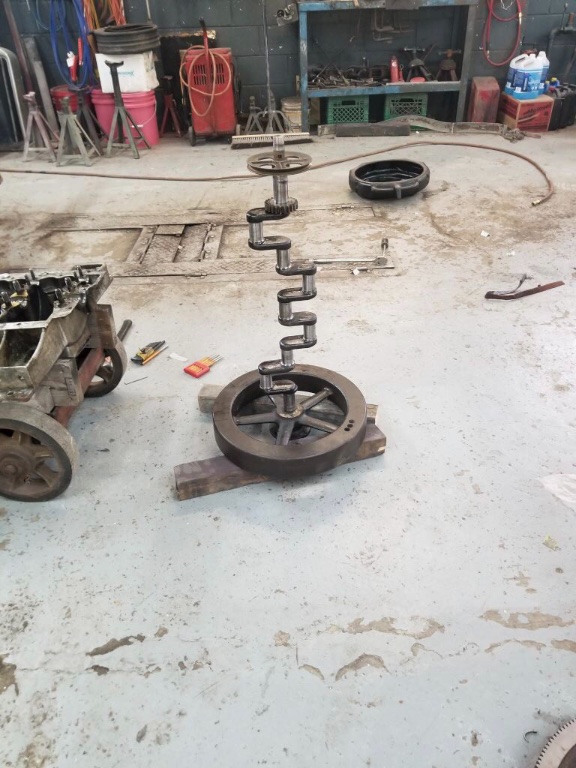

Thanks guys. Just received some bad news, cracked crank. Ouch. But, better to find out now than later.....

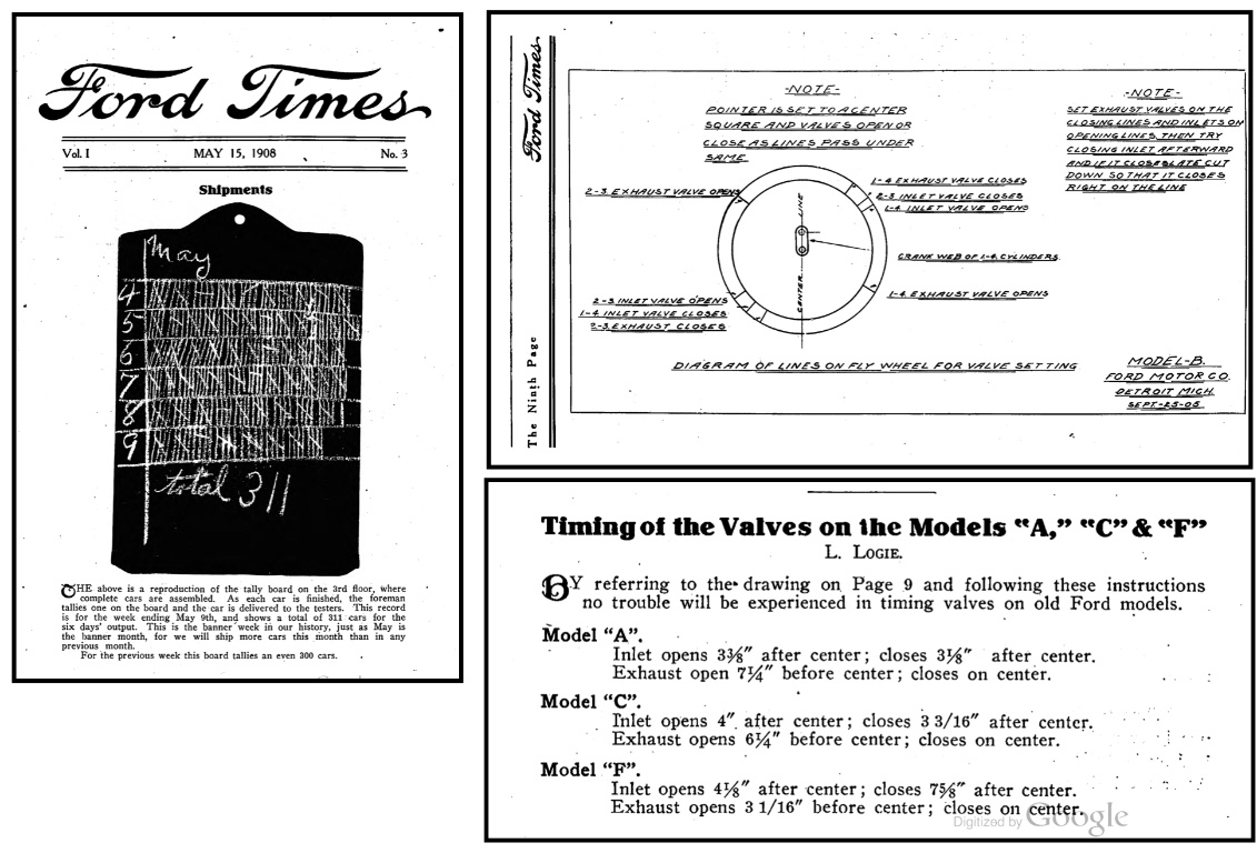

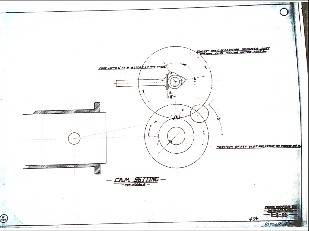

Brent, Erik and others, this is what little I have regarding cam timing the Model B. First, a drawing from THF Benson Library archives, (thank you Kim D.), all rights apply THF. I believe the drawing date is March, 1904:
From the May 15, 1908 Ford Times, with a later FMC drawing date of September, 1905:

One interesting thing I see is that the Model B had a 5 main bearing crankshaft. I didn't know any 4 cylinder Fords had more than 3 main bearings.
