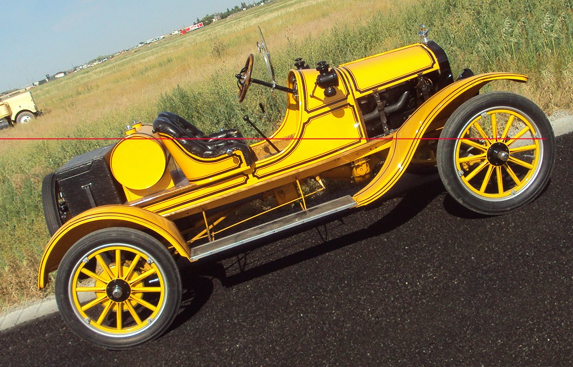

I have mentioned before about backing the Speedster over Jackson pass. Filling the tank in the last town would have prevented this. I provided this pic to show what grade can be possible. You can imagine the difference between full and empty. At the time, we had the gas tank under rear seats, so it was even more of a climb for the fuel.
Steering is definitely a challenge. Joy walked ahead to warn of oncoming traffic from around corners. A bus load of tourists stopped to enjoy the spectacle. As it leveled out, I turned and continued up driving forward but wasn't able to stop to let joy jump in. She walked the last two miles to meet us at the top. I wouldn't want to do it again, but it did get us over the top.
