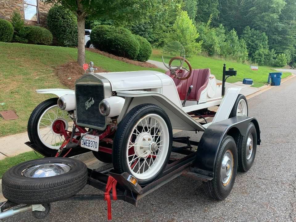

I have a 1927 Hot (as in fast) Speedster. It has original brakes. What are my options? I know that skinny tires on the two rear will not stop me like modern brakes, but lets have a fighting chance?

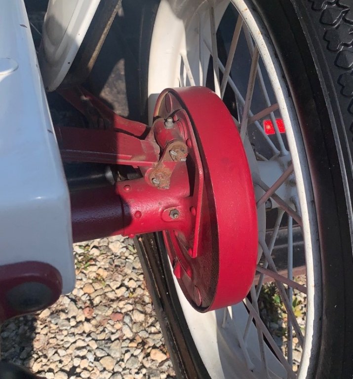

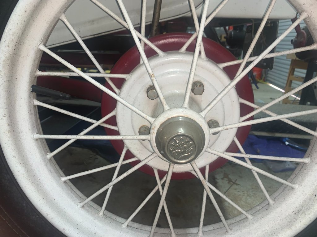

Here are my rear brakes, now

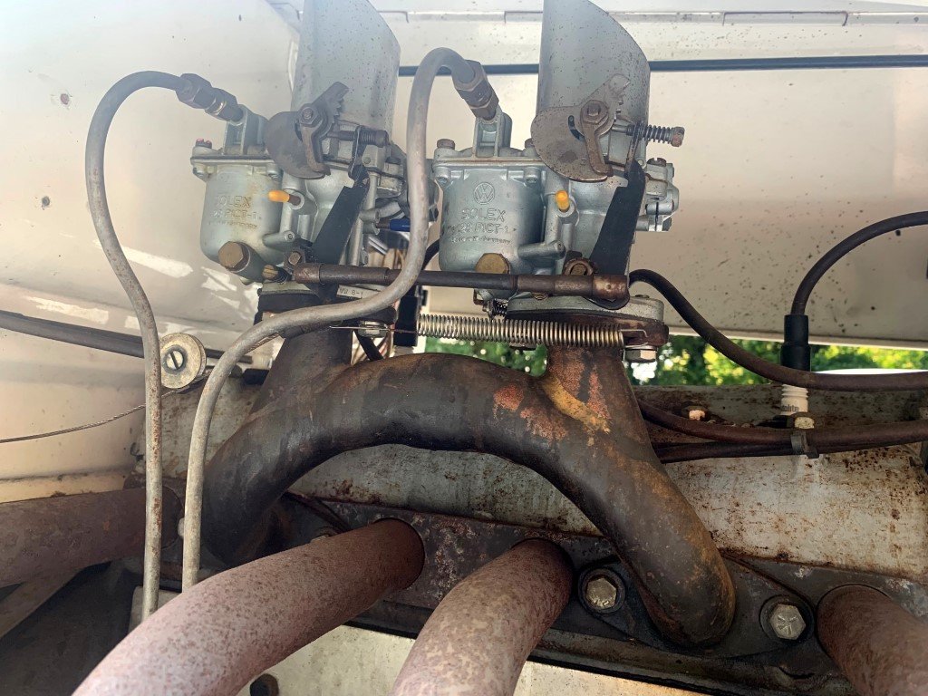

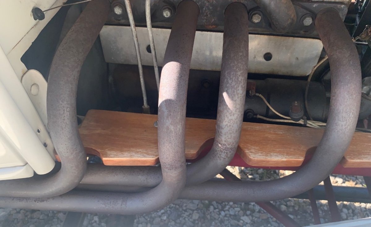

Here are a few goodies that need to be stopped when needed!

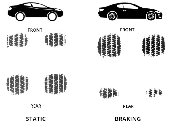

As noted brakes are only part of the problem. The real problem is with the tires size. The amount of contact a tire has with the road, footprint, is called contact patch. I couldn't find a calculator for Model T sized tires. Motorcycle tires are constructed differently. I think this image is somewhat self explanatory if you think of the width & PSI of the tires on your Model T and weight transfer when braking.
