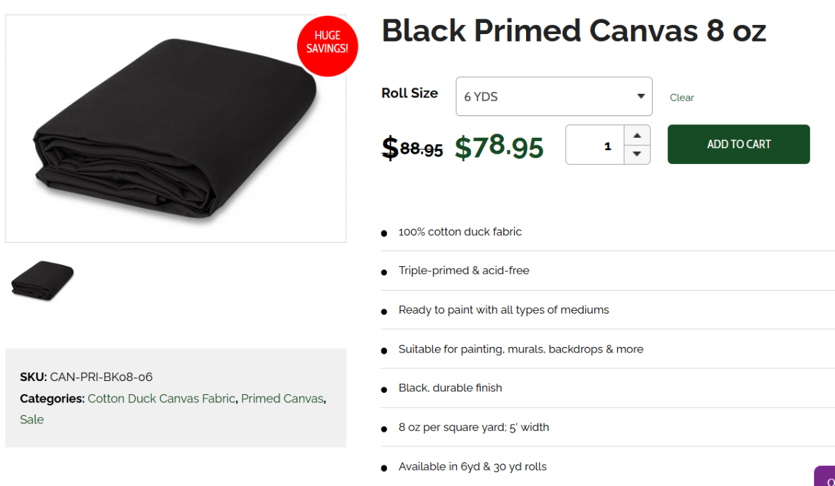

Did some internet searching.
https://fredrixartistcanvas.com/archives/1376
When primed, pure cotton duck canvas is ideal for oil and acrylic paints. However, primed canvas can be expensive. Fortunately, cotton duck canvas is available for purchase either primed or unprimed. Besides price, some artists prefer to purchase raw (unprimed) cotton duck canvas for ultimate control over stretching and priming. Others prefer it simply for convenience, as raw canvas rolls are super portable and lightweight.
This company sells black primed duck canvas https://www.chicagocanvas.com/product/b ... nvas-8-oz/

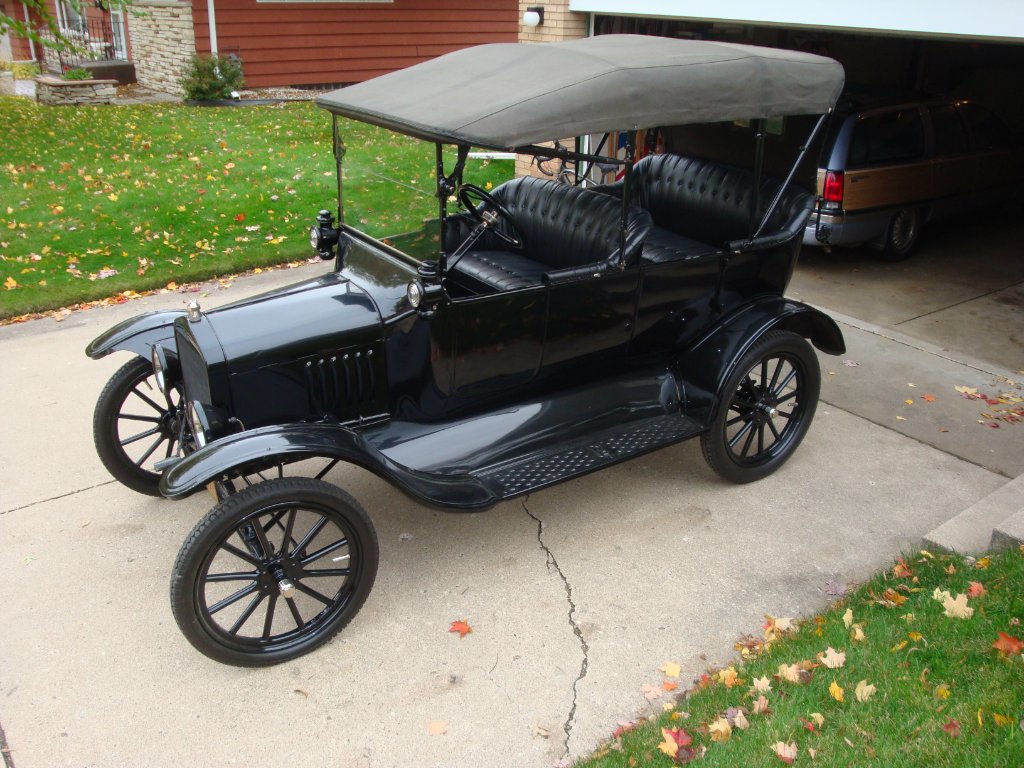

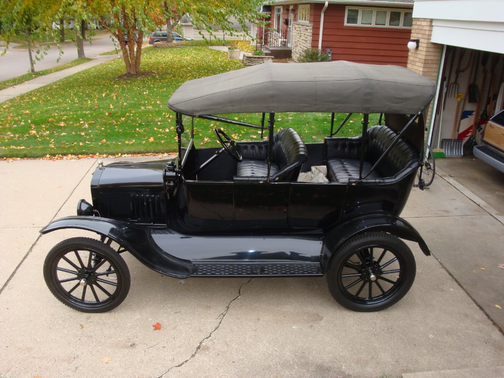

It's similar to the canvas convertible top material my father installed on his 1917 touring back in 1951 (because leatherette convertible top material wasn't available).
The only difference was back then the material was cotton on both sides of the rubber layer whereas today, the top side is acrylic so it is resistant to fading.
Here is the over 70 year old top so it has faded. (Years ago, my dad would also treat it with TopTite black top dressing to darken it up but that product was manufactured in the 1920s - he probably purchased it from Fenstermacher Auto Supply in Minneapolis which had a lot of NOS items in its inventory in the 1940s and 50s.)
https://www.haartz.com/products/stayfast
https://www.google.com/search?q=stayfas ... XUy7KP44AM
https://www.modeltupholstery.com/index. ... yard-goods
