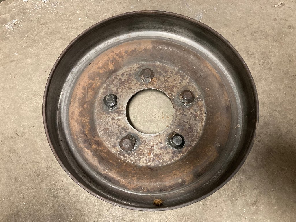

Langs sells a tool that is used to cut the swagged portion of the stud off.
They also have a tool use to swag the new stud
You will need new studs
I notice that one of the studs (upper right) is welded to the brake drum
this weld will need to be removed with a die grinder
the studs should be a push fit in the hub and need to be swagged for the proper fit
