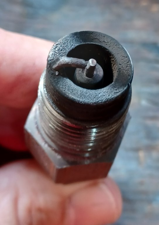

Keith..at least to me, many others may have differing opinions, but this plug I think shows I got my carb on my '13 set up pretty good. #1 plug, the one that will carbon up more than the following three. The rest on this car are even cleaner. This plug has around 10,000 miles on it, and is showing some electrode wear.

That really looks good. My plugs were dark, looked like it had been running rich before. I know I've had it all over the board trying to figure out how to tweak the fuel mixture, which seems to change a bunch as it warms up. I haven't taken the carb off yet, just took the bowl off before the first start to make sure it was clean and pulled the filter out of the sediment bowl on the valve, both clean as a whistle. Pulled the bowl off again after the first start, still clean.TWrenn wrote: ↑Fri Mar 31, 2023 10:32 amKeith..at least to me, many others may have differing opinions, but this plug I think shows I got my carb on my '13 set up pretty good. #1 plug, the one that will carbon up more than the following three. The rest on this car are even cleaner. This plug has around 10,000 miles on it, and is showing some electrode wear.
