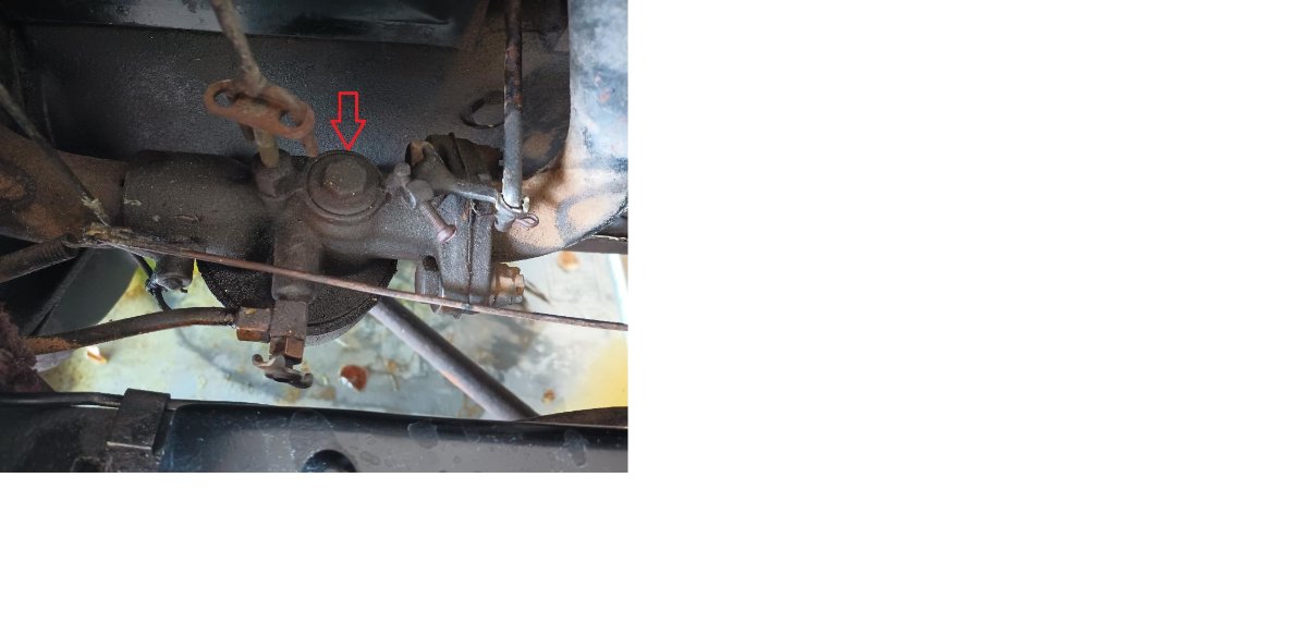

I need to do some carb repairs on my '17 touring car, but I'm not able to ID the carb. Hopefully I've attached a picture. I've added an arrow indicating a cap on the top, between the throttle shaft and the needle, that my help in identification.
Thanks for your help, Maury Dean

Kingston #6100 Model L-2, Used in 1917 and 1918. I hope this helps, Russ Furstnow
