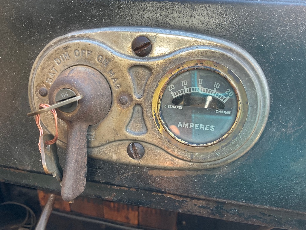

Looking for input on an electrical issue. Running on either BAT or MAG, my ammeter is showing 20A charge. Light switch is off and lights not yet connected. I removed the cutout cover and the points are clean. Voltage at a high idle is 8.9v at the GEN terminal. I realize that I can adjust voltage down to 7.2V with the 3rd brush, but am wondering what might cause such a large charge rate? When reversing the ammeter terminals I get a 10A discharge. Until I figure out the issue, I have removed the cutout and grounded the genny.

I'd try another ammeter.
You need a good, fully-charged 6 volt battery with good connections for the generator to work as it should. If you test voltage with the engine running at high idle with a charged battery, it should not be over 7 to 7.5 to volts, and less is probably better. Current should max out at 4 to 6 amps.
20 amps is crazy high. The ammeter should read the same amps under the same conditions with the connections reversed, except the + and - will be reversed.

The reading you get when reversing the terminals on the ammeter is what you should expect with the lights on (+ or - some running on BAT). Not sure what your getting with the lights off with the reversed terminals. If properly wired running on MAG only reduces a small a amount of amperage that the coils use when running on BAT, they are two separate circuits.
All the stated causes are possible. But it would be best to have the ammeter setup as you did with t he reversed connections and report back the results whren running on BAT once with the lights off and another reading with the lights on.
You also needs to state what ammeter you are having the issue with. Large or small, original or repro.
Some small repro's have had issues. Old ones can go bad as well

Yes, it is a repop Ford logo small dia. Ammeter complete with MADE IN CHINA sticker proudly plastered on.

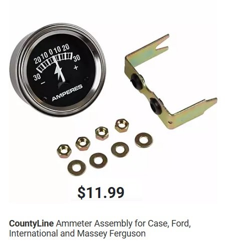

The best choice is to buy an ammeter adapter that is used to attach the small 1926-27 ammeter in the earlier ignition switch panel.
Then, you cut or grind out the center section and any modern two inch ammeter will fit and work.
That is especially good, if an alternator has been installed that will provide more than 20 amperes.

The problem was solved in April 14, 2023. It was a faulty ammeter

I was told the new small ammeters were greatly improved.
I have converted a few with this one from Tractor Supply, but it is made in China too.
There have been no known problems!
