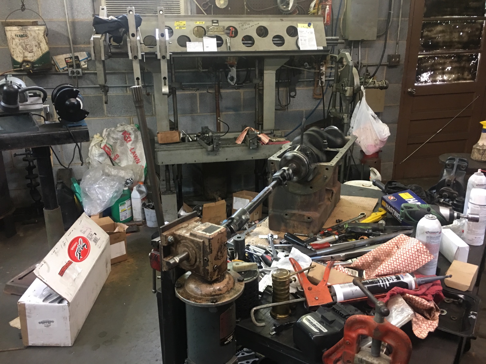

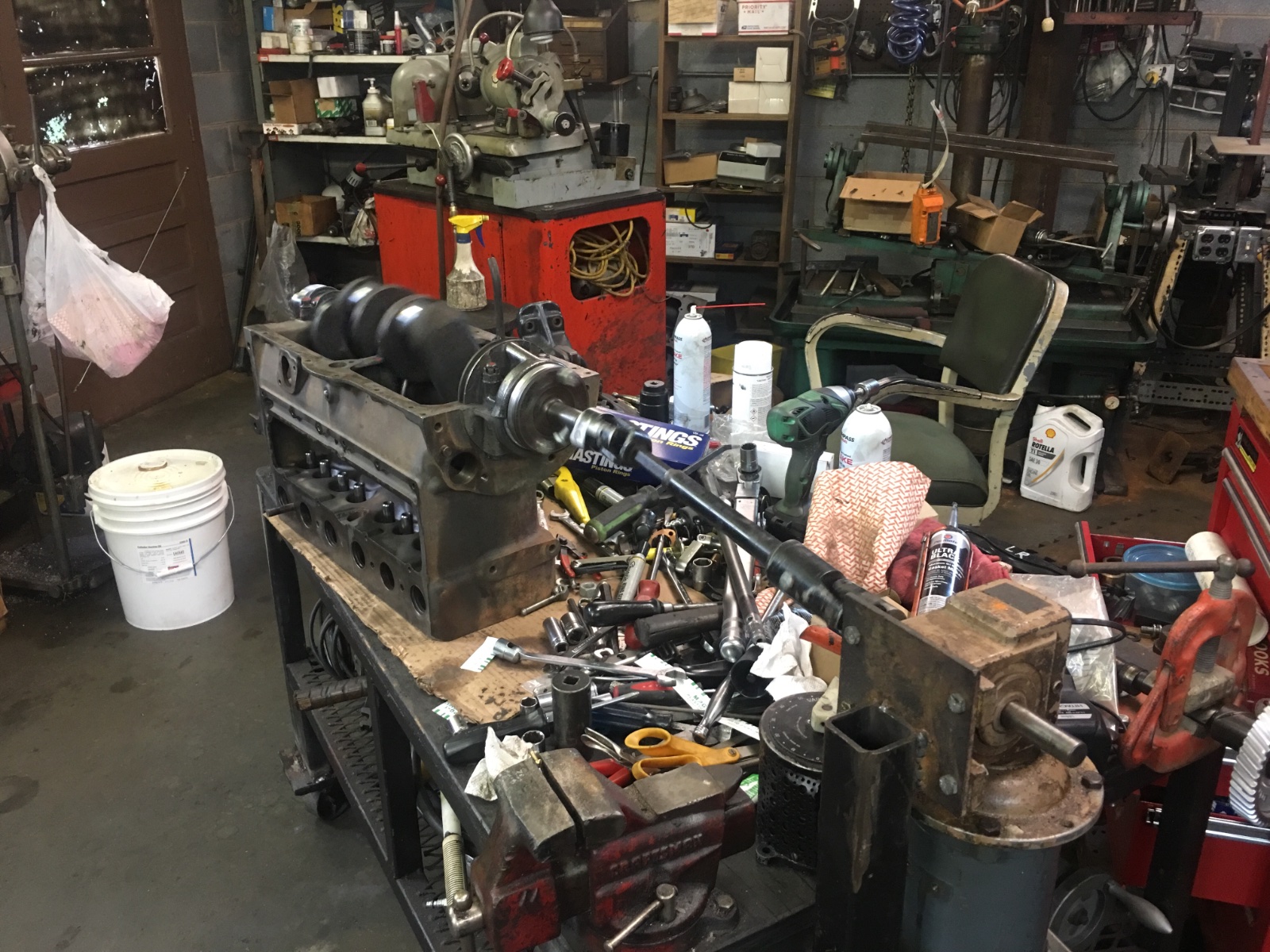

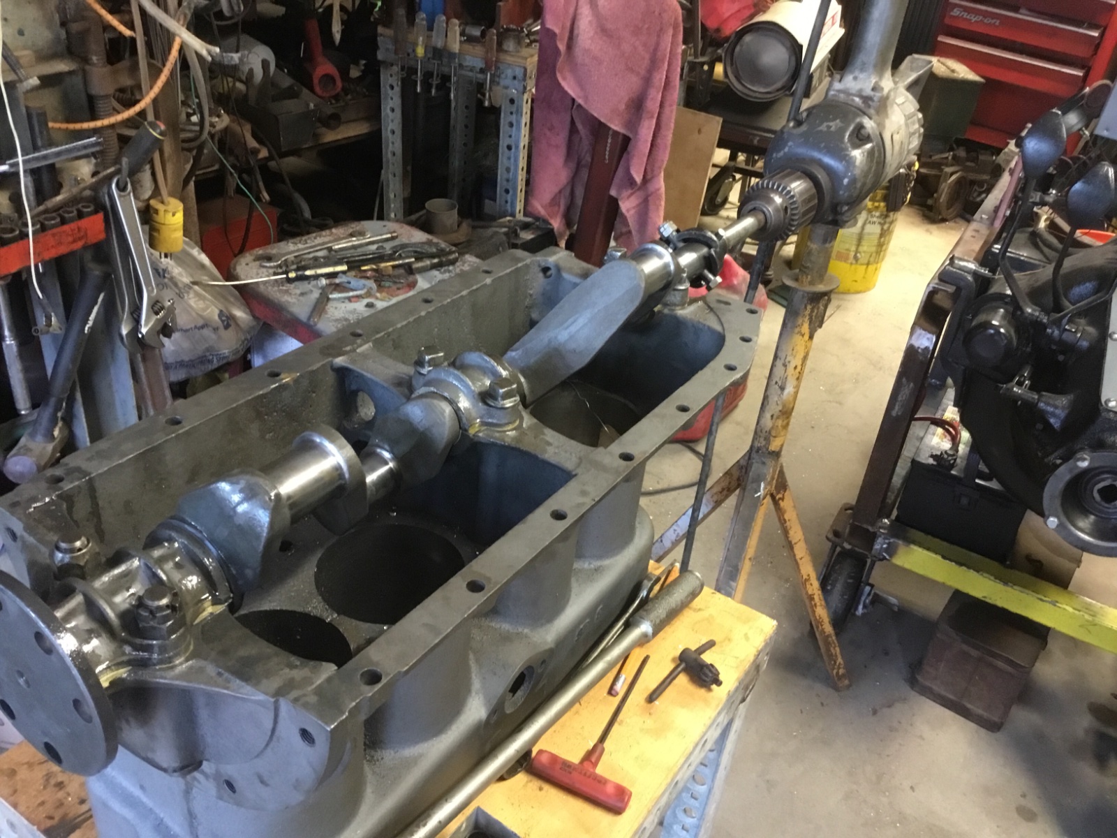

Please show the set-up you use to run your shaft in.

I blue/scrape any high spots and use Timesaver to set my rods and crank.

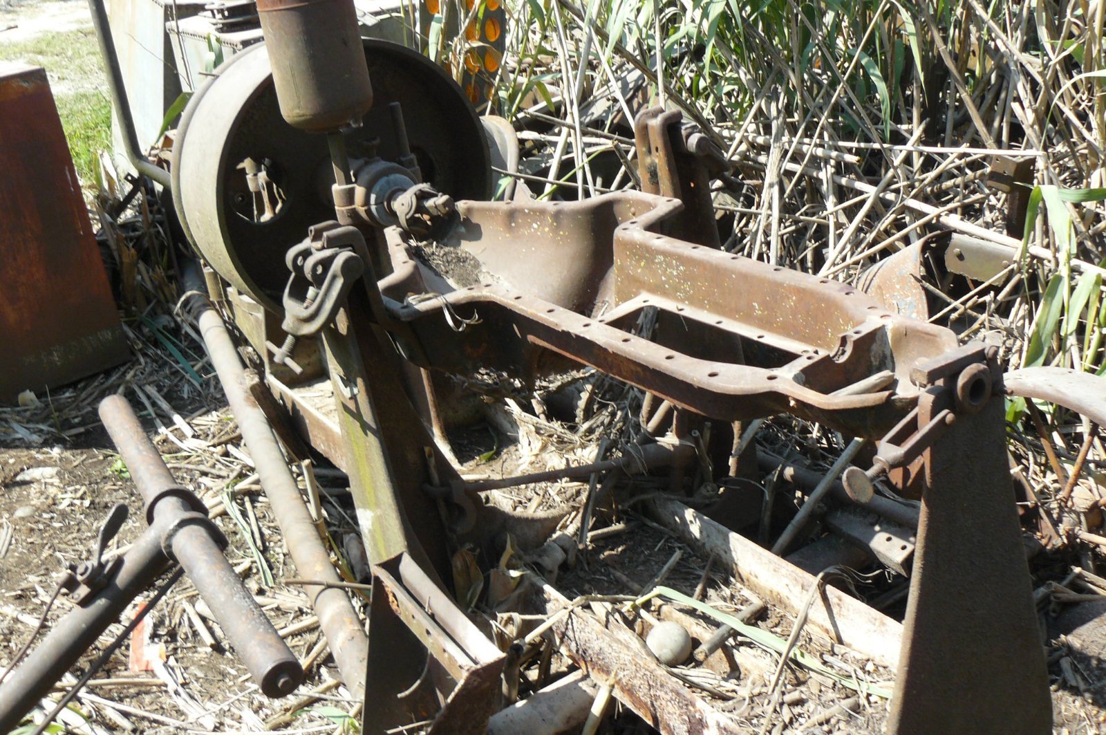

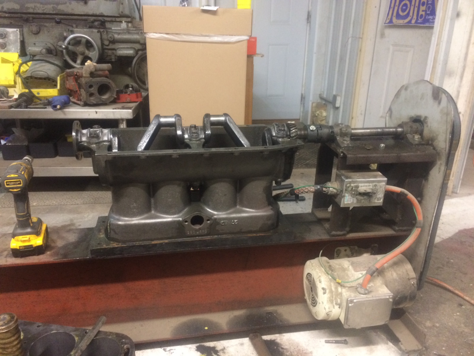

i guess i could use this!!!!!!!!!charley

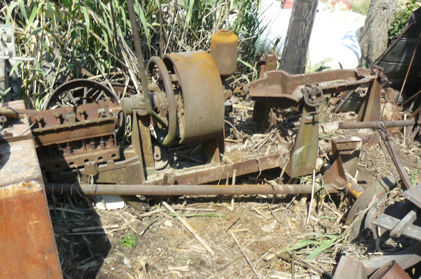

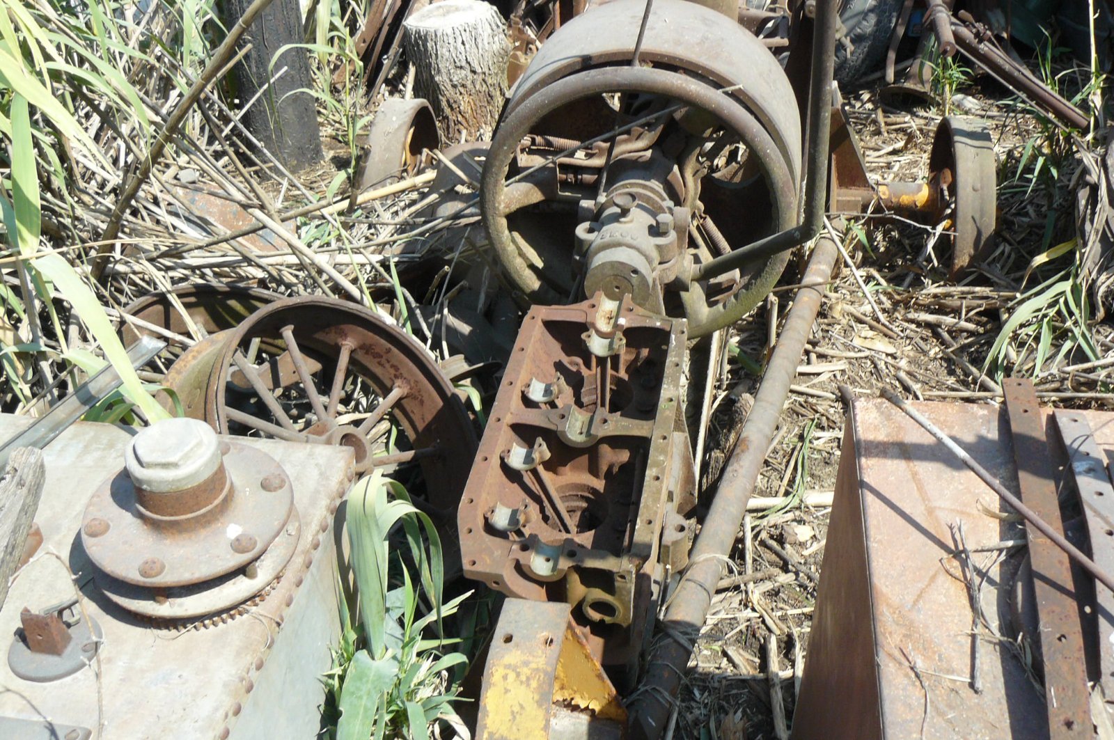

ok.charley
motor stand.jpg (20.71 KiB) Viewed 9332 times

scrap maybe not,as i have been offered $5000.00 for it.oh looks like sandblast and go to work. charley

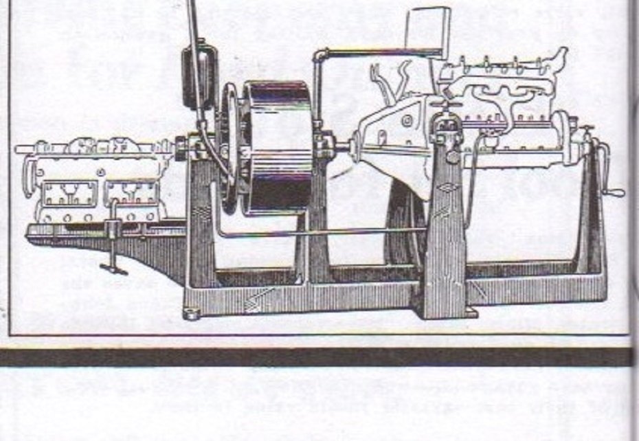

How is it driven? is it flat belt on the drum or are the inturnals of the drum an electric motor?
This diagram shows the complete engine has a fuel line, is the engine being driven or for driving?

it is run off line shaft,but motor can do the work, also motor can be started with it. charley

If the engine was driving the crank in the bare block as shown in the picture, it would be turning the crankshaft in the wrong direction.

do you think it would matter??????????? charley

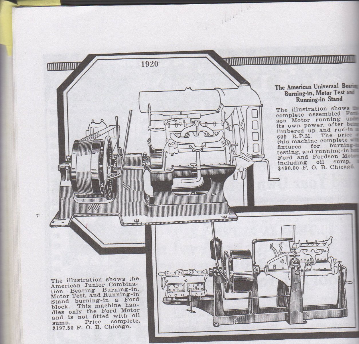

Found an original ad, my question answered, for running in the complete engine as well, neat tool wish I had one :cry:

After I finish line boring I burnish the Bearings to the crank with time saver in the same setup.
