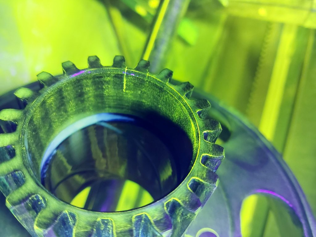

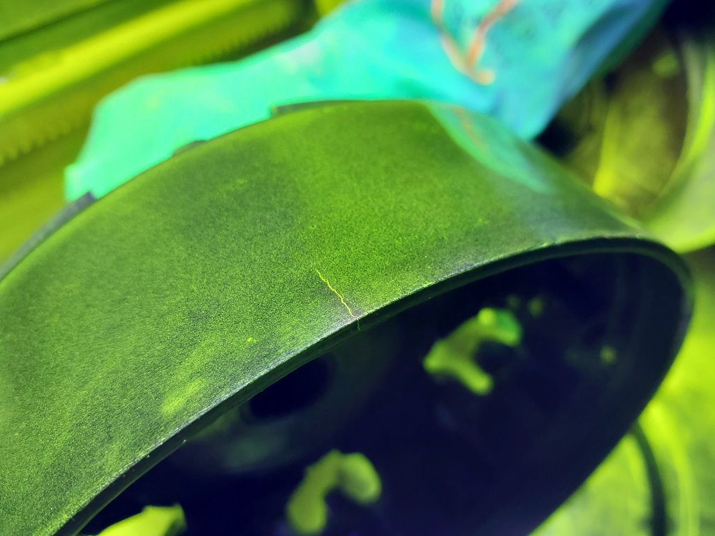

My slow and my brake drum failed the crack test. Does anyone have drums for sale that I can use to build my 1926 transmission?

Beat, I can help with your requirements. Postage from here to you is not likely to be a great deal more than it is to the USA from here.
Alternatively, it is not a big job to change out the cracked gear on your slow speed drum,if you can find a replacement. Email me if you need to.
