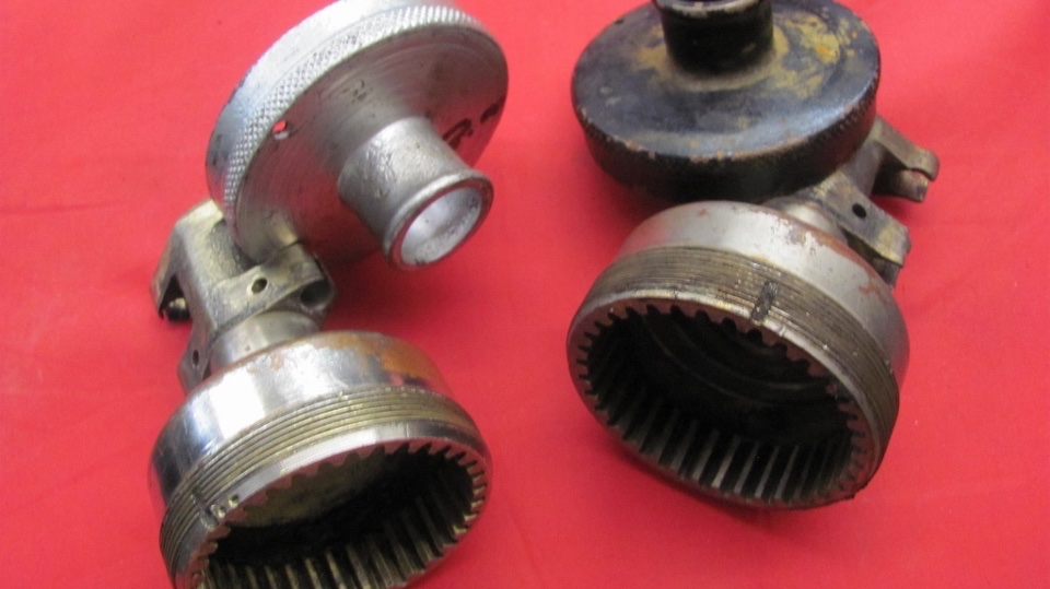

Now that I have my steering gear case and control arms separated, I found pitting in the cover and control arms. Is this something that can be smoothed out by a nickel plating company or should I look for an un-pitted set. The gear case is brass so there is no problem with that. Also, I need any recommendations as to who does a good job of nickel plating. Thank you for the help.

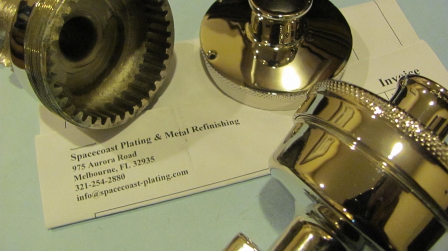

Locally nearest bigger town is Daytona, and with all the auto stuff there, some good shops. Last sets of steering cases and caps were done by Spacecoast Plating. Top notch work, only couple of weeks too. Good email contact, was able to get quote over the net by sending them pictures.
What was sent....
What was received....
What was sent....

They filled all the pits with undercoat plating of copper and then high polish before the layer of nickel.
If you look at the top photo, before parts, Click in and zoom the photo up, and see the neck of the silver painted cap, you can see deep pits. Those were not visible after plating. That painted cap was a $2 swap item, now looks NOS.
