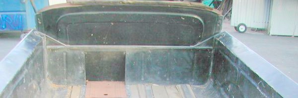

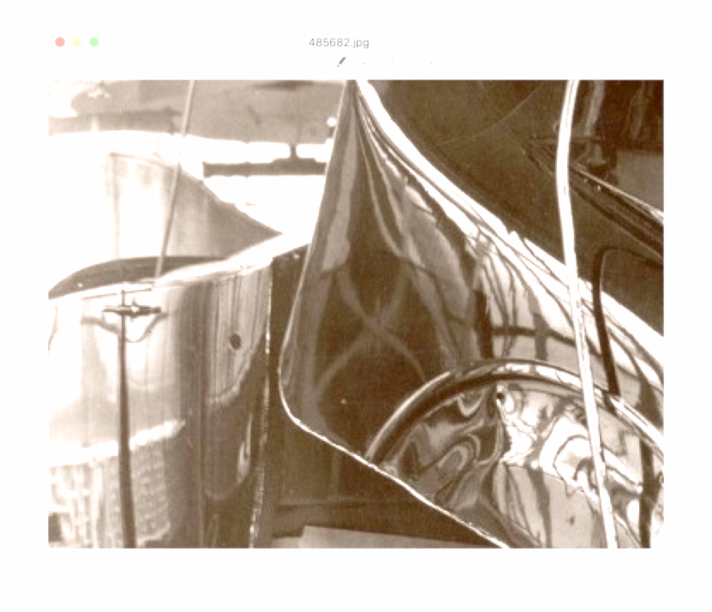

Here are pics, and one close up of a Nov.1925 mfg. runabout pickup. Was told this T was always a pickup, and it does indeed have the missing holes and captive nuts in the rear panels. Therefore this body could not have had a turtleneck installed, and all the decks have mounting holes for this spot.
rear edge tack strip.jpg (57.43 KiB) Viewed 7195 times
Note no holes in pillar.

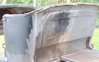

Another body, with holes in pillar, this one is unknown date, but has the early bed with front stake pocket at the body.

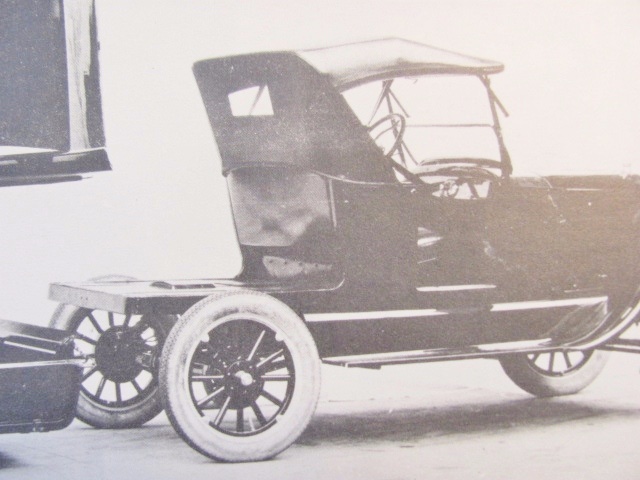

Ford factory photo, maybe prototype of the Improved Car runabout, showing how the pickup bed and deck can be interchanged. This is famous photo of the plain panel.

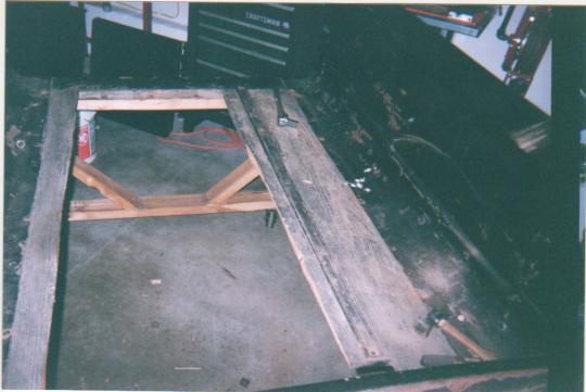

As for the metal deck pan, Richard, I recall on my Nov. 3, 1925 mfg. date (engine 12,635,xxx) the bed wood little carriage bolts were very short length, and since the metal pickup bed rides on channel below the curved lower sides that the bed boards fit to, there wasn't any contact of the square toothed washers or the small square nuts holding those bolts that go through the metal bed strips.
Don't have any photos of the underside, but this is the upper as removing the old wood boards.

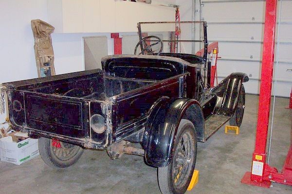

Original Nov. 1925 mfg. Improved pickup, has all the features of factory to me, note the stance.
Can confirm this one did have the nine leaf rear spring, as used on sedans, needed for the anticipated loads the Ford could haul :)

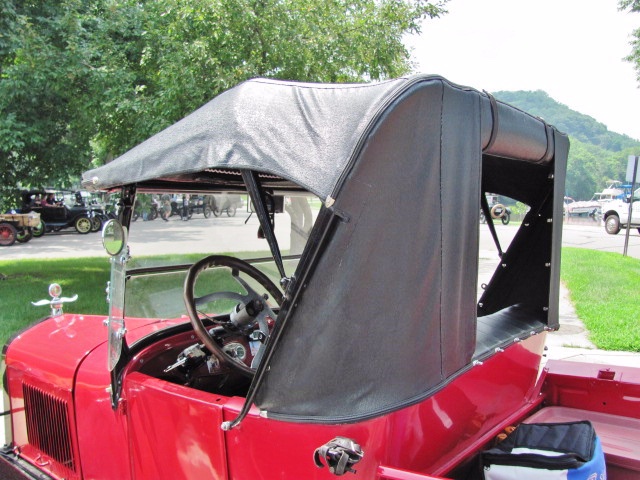

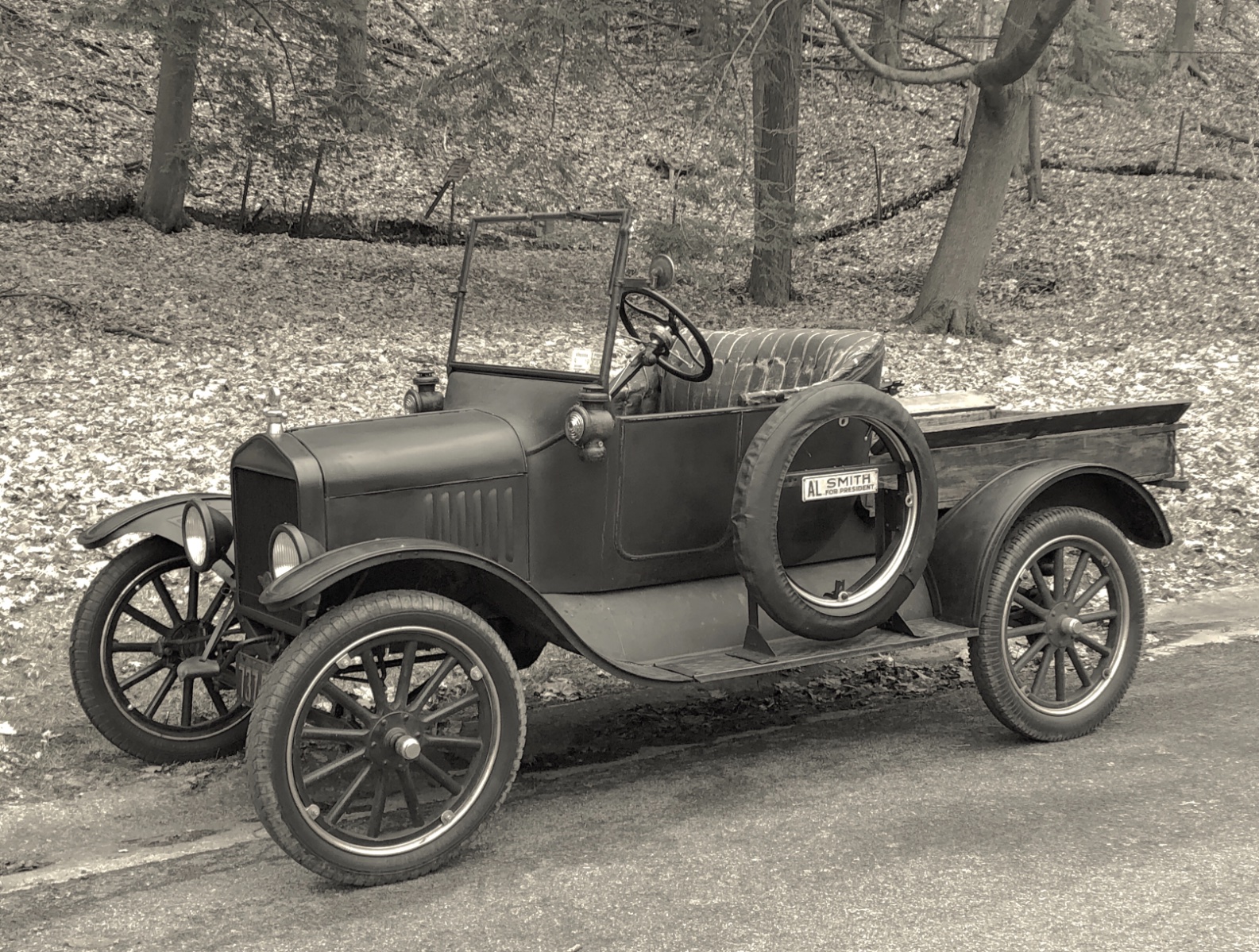

Here is my ‘23 runabout with an original “slide-on” pickup box and side mount spare. Also the same car with the turtle deck and rear spare mount. The holes were pretty close but not exactly.

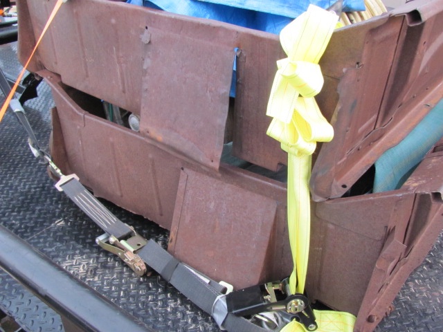

Photo showing later '26 beds with filler plates. The top bed is molested on the kick out for the battery lid (trap door), likely was used as a trailer. Both show most of the filler panels, these panels are riveted to the bed, so they are usually there, on these later '26 beds, or the remains of metal under the rivet heads if the plates are missing. Note both beds have the front stake pocket back about 7"
