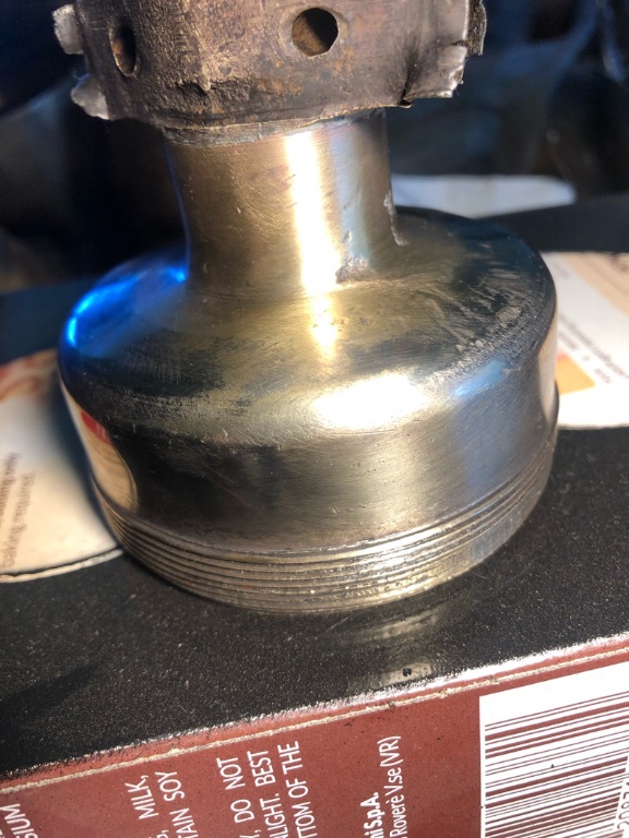

I’ve been thinking about buying one of those Caswell kits to brass plate some parts on my 14. I’m building a speedster but I’m using an Overland body, that’s why it’s not a T part, but it could have been. It’s nickel era but I was just going to paint the column since it was solid rust but I thought I’d at least disassemble it and paint the quadrant and levers black. I then got to thinking about those Caswell videos and others about plating so I thought I’d give it a try.
All you need is one gallon of vinegar, a little salt and about $25 worth of nickel you can get on eBay. I used a 6-12v 10 amp battery charger for a power source. You can make as much of the solution you want for cheap instead of buying it and pour it into any container you want to fit your parts. You just hang a piece of nickel from each side of a container filled with vinegar and a little salt, then hook electricity to each one. The solution is ready when it turns blue-green. Then remove the strip from the ground side and attach the ground to the part you intend to plate by a copper wire used to hang the part in the solution. Leave the positive connected to the nickel strip. It helps to move it around. I pour the solution back into the vinegar bottle for next time.
This is the second part I plated. I plated it once then sanded it smooth and plated it again. I could probably keep doing that until it’s perfect. It was solid rust long ago. Just an idea for anyone wanting to try for 1/3 of the price of the kit. I still need to figure out the brass.

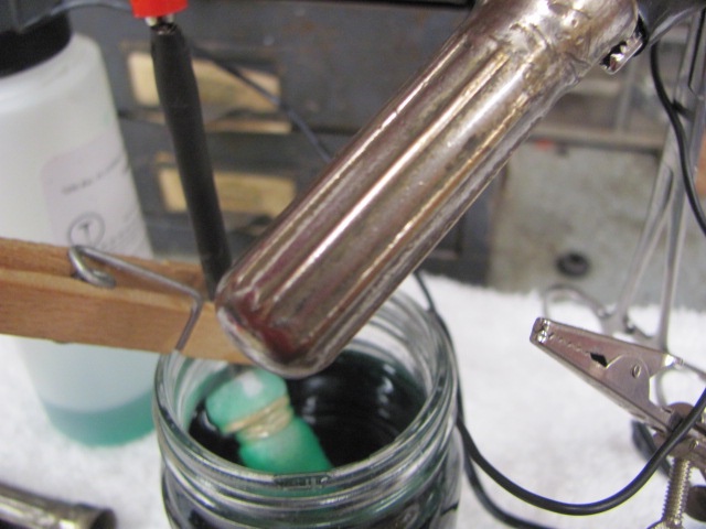

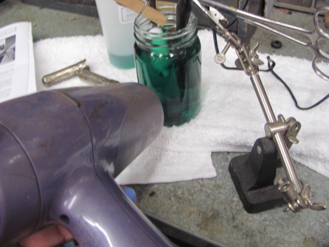

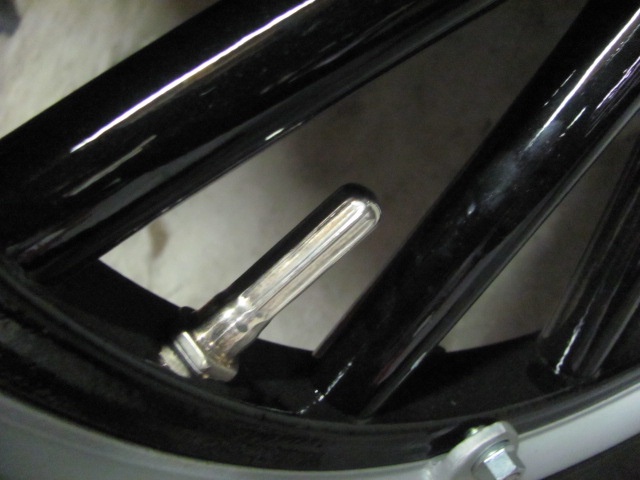

Bought the little Caswell kit for nickel to do plating on dust covers.
Choose covers with some remaining old nickel on them, and used the kit to re-plate back to shiny nickel.
Here is the before:
Parts were scrubbed clean first with lacquer thinner to get down to only metal surface, having the pieces really clean helps.
Found that heating the solution a bit (used a hot air gun) helped the process. [/b]
