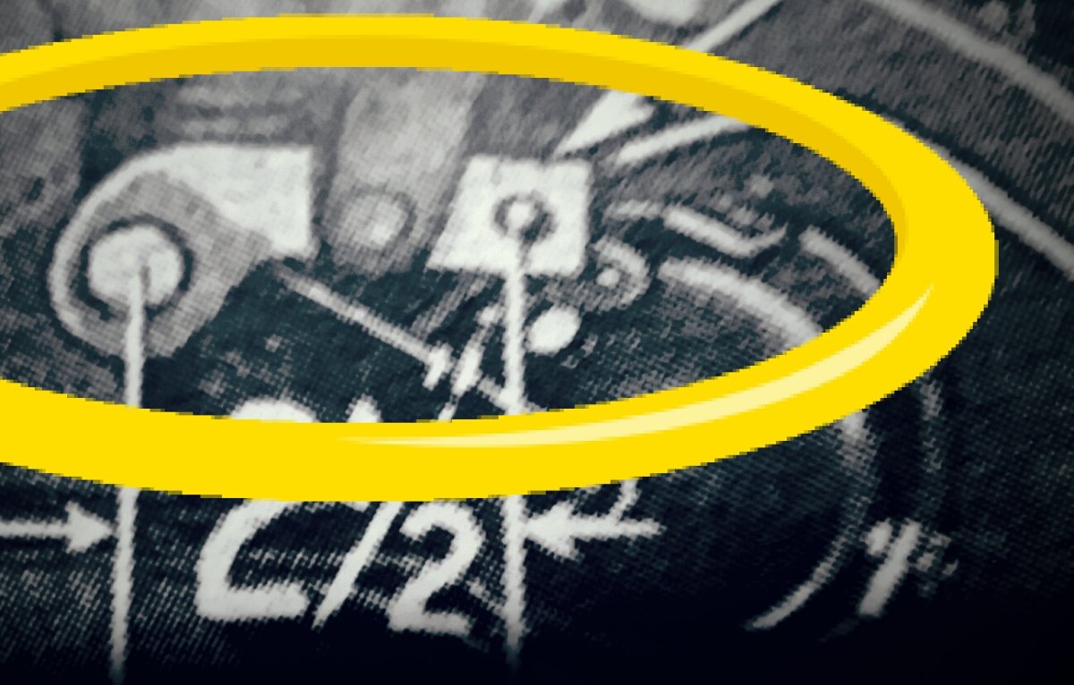

Is this tool labelled "B" sold by a retailer, or fabricated individually?

It would have been quicker for you to check the vendors on line catalogs than post your question with photo's here. but to answer your question, Langs, $1.45

This tool only works for FORD type roller timer’s.

Beware, as others have stated, the Ford Service Manual timer gage the vendors sell is ONLY reliable when using a Ford timer and a Ford roller. Other timers have different internals, brushes, or different rollers.

This tool only works on stock roller timer
Best way is Crank ratchet pin is parallel to the ground this puts piston TDC half the time set and run and fine tune as needed

Here's a pic of my homemade timing tool from 2 yrs ago. It's a wood paint stick. I had never seen the picture in the manual until the other day. I used my other T to make this one pictured. Manual dimension is 2.5 inches from center of each hole. Mine is 2.75 in.
