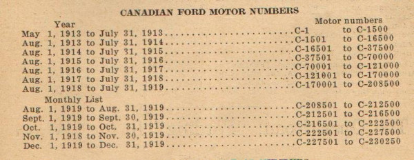

I pulled a rolling chassis with engine fuel tank firewall a
And radiator out of a barn engine is stamped c56627
Any help dating year of production would be appreciated

Canadian serial number.

Per the MTFCA Encyclopedia the engine number can not be used to date a car(hence identify one) just the engine. Reason engines were replaced over time.MichaelC1972 wrote: ↑Sat May 27, 2023 10:51 amI pulled a rolling chassis with engine fuel tank firewall a

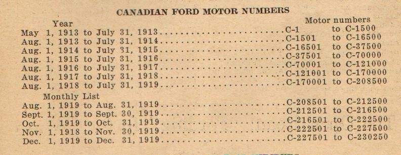

Here is some info on Canadian Numbers & production volumes https://www.mtfca.com/discus/messages/1 ... 40611.html
- Posts: 4694
Re: Help indentify car
Canadian Car. Either a late 15 or early 16 from the list of engine numbers posted above. It would be a good source of parts for someone who had a car of that vintage. Otherwise it would be hard to find a body for it unless you use a reproduction body or make it into a speedster.

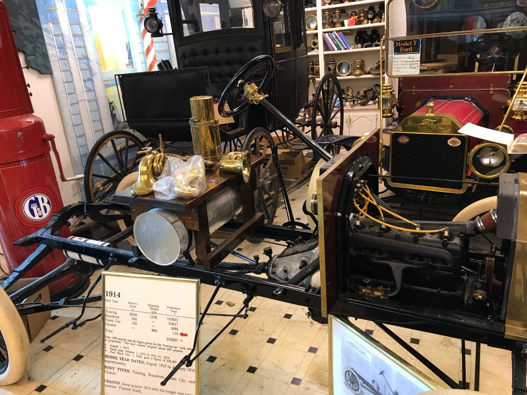

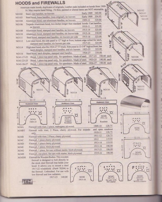

- Posts: 6587
Forgot to post this photo - it may have never been a "car" but just a chassis that was sold without a body
This is a picture from Craig Beek's Model T Museum --
the firewall & hood may also help id the year
