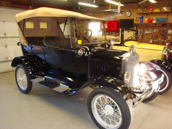

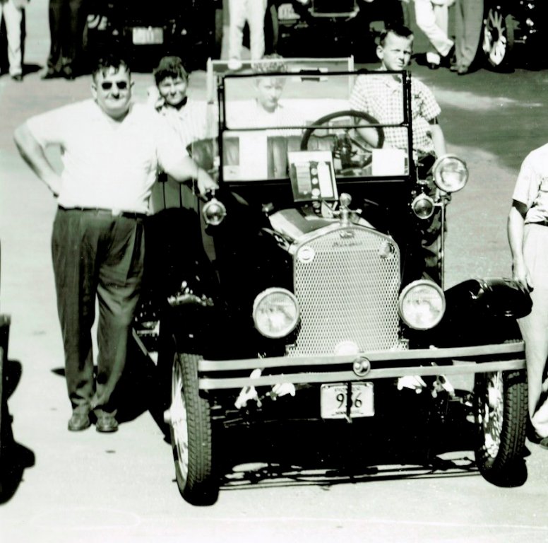

The late Louis Seekon of Minneapolis, MN had a 1924 touring that he dolled-up with a number of accessories including a radiator stone guard.
He was a talented fellow.
Instead of being a period accessory, he may have fabricated the stone guard himself in the 1950s using off-the-shelf materials. The main part of the stone guard was flattened expanded metal sheet/lattice that you can still purchase today. I can't remember if the trim around the perimeter was flat metal or a split tube.
If I recall correctly, it had a three-point mounting - one tab each for the left and right radiator/radiator shell mounting studs and nuts and collar that went around the base of the radiator neck.
The first photo below was cropped from a panoramic photo taken in 1959. The second photo is of the car that I took in 2016 when it was still in Minnesota after Jeff Perkins acquired it - sorry about the poor quality.

Wow, gotta wonder how the restricted airflow affected the cooling...the guard looks nice for sure, but also looks like at least a 50% reduction in air flow. Better have a flat tube radiator!

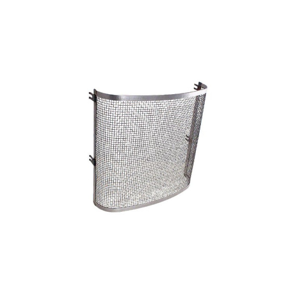

The color pic stone guard looks like a very good adaptayion of a amodel A stone guard.
Craig.
Craig.

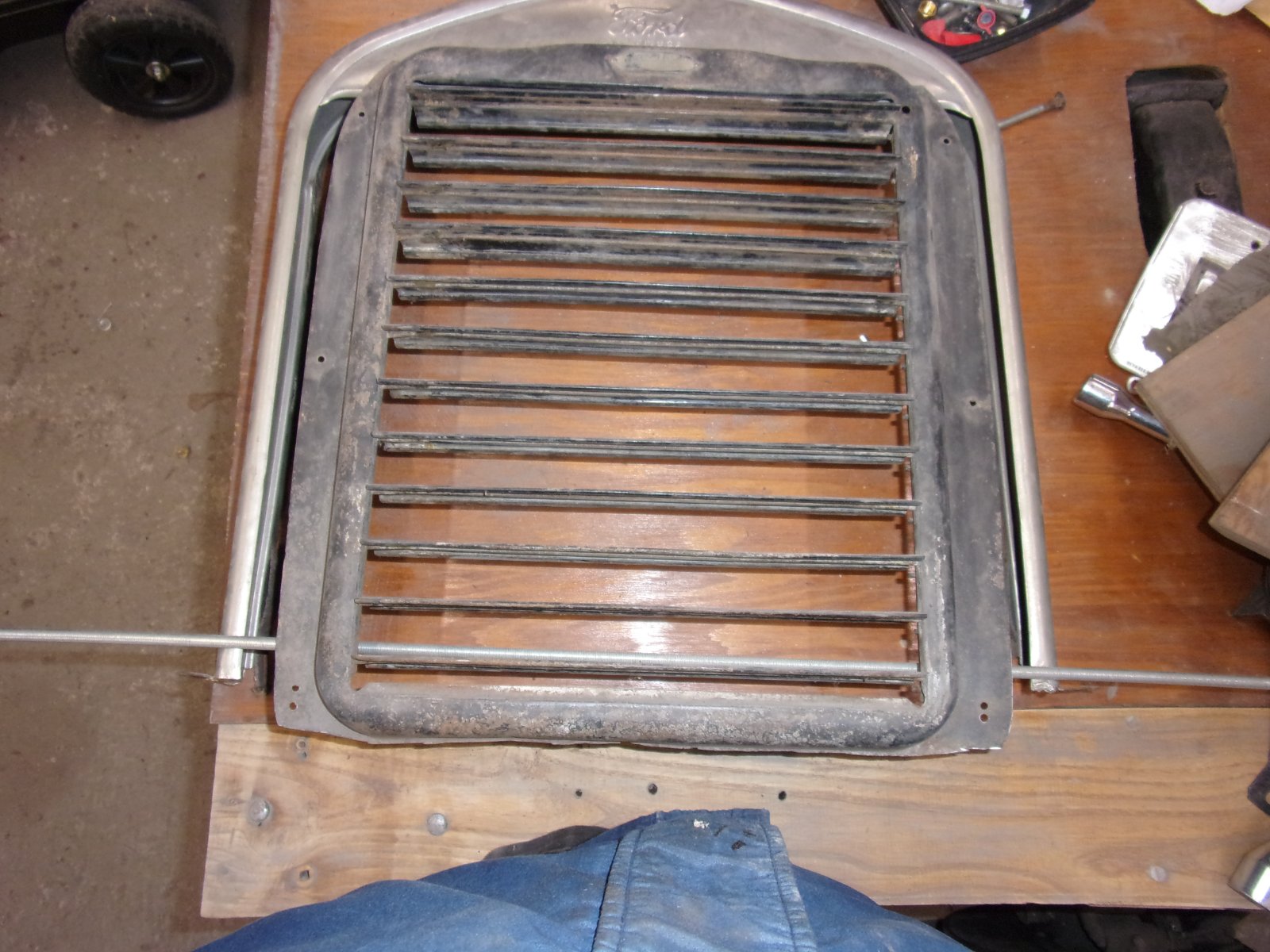

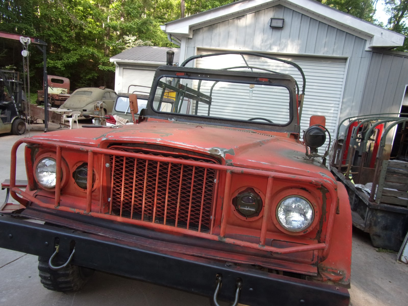

I have installed a radiator shutter on my WWI ambulance project. Not that it gets that cold down here in GA, but I like the look of an "armored" radiator on a military type vehicle. Even in the open position, it looks like it will provide some protection. On my 1967 Kaiser M715, the military installed a brush guard for the radiator, but no protection for smaller debris, so I installed some wire screen, using existing grill holes. I am considering coming up with something like this screen for headlight glass protection for the ambulance.
Just some more food for thought.

Stone guards were very popular accessories for hobbyists during the 1950s through the 1980s for the big Classic automobiles and model A Fords. I actually knew a fellow that made hundreds of the model A versions back in the 1960s (he lived near where I grew up and went to high school). A typical model A hobbyist, he welcomed me to stop by and chat occasionally when I was riding my bicycle in the area. All the jigs and tools to make the stone guards were set up in his garage next to the unfinished model A he never had enough time to work on. The ones he made were beautiful and he sold them all over the world through ads in model A magazines.
The big Classic stone guards were made by others to fit Packards, Cadillacs, Pierce Arrows and dozens of other marques.
They were in fact reproductions of original era accessories. Jack Passey had a few original ones on some of his cars (I was fortunate to get to know Jack early as my dad had gone to college along with Jack's younger brother for a year or two). I was often allowed to wander through his incredible collection of Classic cars. Even though Jack had given me permission to open hoods and doors anytime I wanted to look closer, I never did unless he was standing right there with me.
I have seen a few originals and era advertising for stone guars for model T Fords, so I know they were made and did exist.
However, like many after-market (or even factory options) accessories, they really weren't all that popular when the cars were new. Like wire wheels or step plates on 1925 or earlier factory bodied model Ts, they just don't show up very often in era photographs. I would expect that on model Ts. They were practical and utilitarian cars, owners rarely were willing to pay extra for such frivolous bling (to use a modern word for it?). But even on the great Classics, other than factory and sales photos from the era, stone guards are not common in era photos. Packard's (and other) sales departments loved to show the cars with the factory optional stone guards, Tripp lights and sidemount mirrors. In random street scenes? Such options are not often seen. (The mirrors are seen much more often than the stone guards and Tripp lights because they do have a practical use.)
If you can find the right types of interlace wire mesh? Making a period correct looking stone guard would not be difficult. In the 1960s, that correct mesh was still being made and could be ordered in various sizes large enough to make a few stone guards. I suspect it must still be available today as I have seen recently manufactured off-road lamp covers made of it. However, I have no idea where to get any. The stone guards are little more than small angle-iron carefully shaped to match the radiator shell, the wire mesh cut to fit neatly inside and brazed into place. Simple flat steel brackets brazed (or more correctly riveted?) to the angle iron to mount to the chassis and radiator neck. Nice ones then were nickel plated up until about 1928, and chrome plated after that. Utilitarian versions were likely painted black.
I clearly remember seeing a nickel plated one in an era auto parts store photo some years ago. But apparently I don't have a copy of it on my computer (I looked for it a couple years ago?).
If you think you would like one? Go for it! Even a good reproduction gives people a chance to see some of what was available back in the day.
Just for reality's sake? Probably ninety-nine percent of all model A stone guards today are postwar reproductions (made by at least a dozen major suppliers including my old friend). Probably nearly ninety percent of the stone guards on the great Classics are also postwar reproductions, whether the current owner believes it or not.
