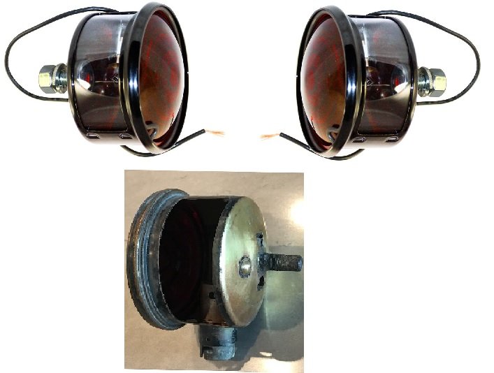

We have the left license plate and light.
For the right, I bought a worn out light and broken license plate holder to modify and drilled the holes in the fender.
I remove the bayonet socket and weld in a dual contact bayonet socket (like I did on my '50 pickup). It should have a tab for a ground wire.

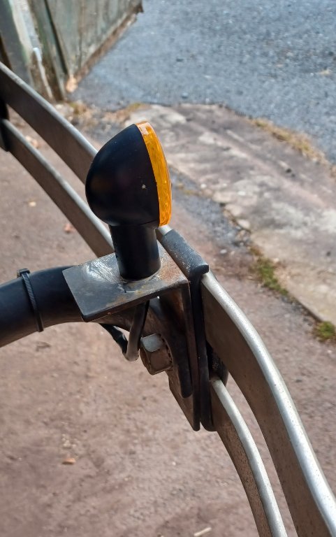

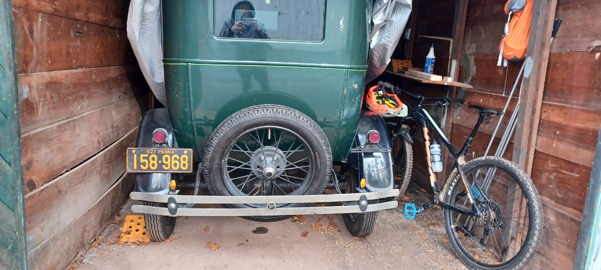

On my '27 Fordor I installed 6 volt motorcycle turn lights I found on ebay with brackets that bolt on with the bumper. I like the look and they are plenty bright for people to see.

Turn & brake will not be stock so throw caution to the wind. I like the model A Duralite tail lights, they have tail/turn & brake and look
somewhat correct. The Signalstat 900 turnsignal switch can be had with indicator lights in it from some of the T suppliers as well as the amber
beehive turn lights for the front. Suppliers sell them in 6 & 12 volt. I would stay away from cheap solutions. One thing people forget is that DOT
requires any light on a vehicle work reguardless if it is factory equipment or not.

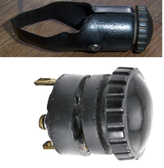

Planning to use the column mounted horn combo light switch for a horn & turn signal switch. Have the switch and several casings that mount on the column. Used pictures from the Internet. Haven't taken any of mine yet.
Also to use taillights (like the drivers side repro) with an amber bulb dual filament bulb (led). Will point the license plate window outward for visibility to traffic on the left & right. The center bolt makes easy mounting, Some rerouting of the wire connections will be required,
