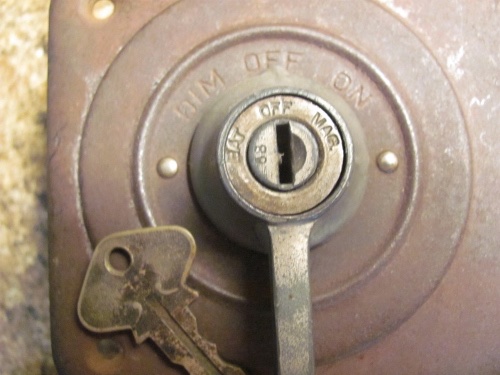

Hi all,
I am trying to figure out what this number is stamped on the ignition switch. What do you all think?

Looks like number 64

+1 for Bill's #64. BUT, I would suggest you try any and all Ford keys you have access to. I found my ignition switches will work with MORE than ONE key. Maybe, take your switch to a swap meet, club meeting, car show and ask if the people will try their key in your switch. I'll bet, there are more than just one numbered key that will work.

Looks like 64

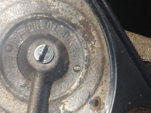

I looked very carefully at the switch and took pix from different angles/lighting. I got a repro #64 from the vendors and it doesn't turn. I wonder if a. the key is wrong; b. there is some problem with the tumbler.

Well, it's not a 54 or a 74, so it's got to be a 64. Have you tried your key by slipping it in at slightly different depths? Two things can happen. 1. The lock cylinder is made of pot metal and can grow in length. When it does, it's as if the key is now too short and is not going in deep enough. Often, the solution is to slightly file back the shoulders of the key, at the top of the shank, to allow it to go deeper. 2. There can be small bits of the cylinder material that have broken away, at the top & bottom of the key slot. Your cylinder looks like that has happened. This can allow the key to slide in too far. Hold the key back just a bit and try again.

I loaded the picture into my photo editor and cranked he contrast way up. I agree, 64.

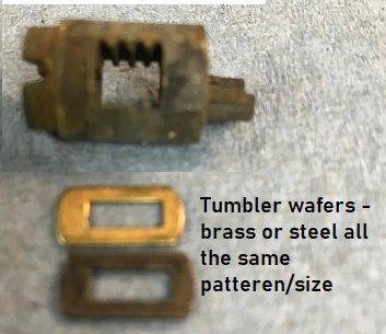

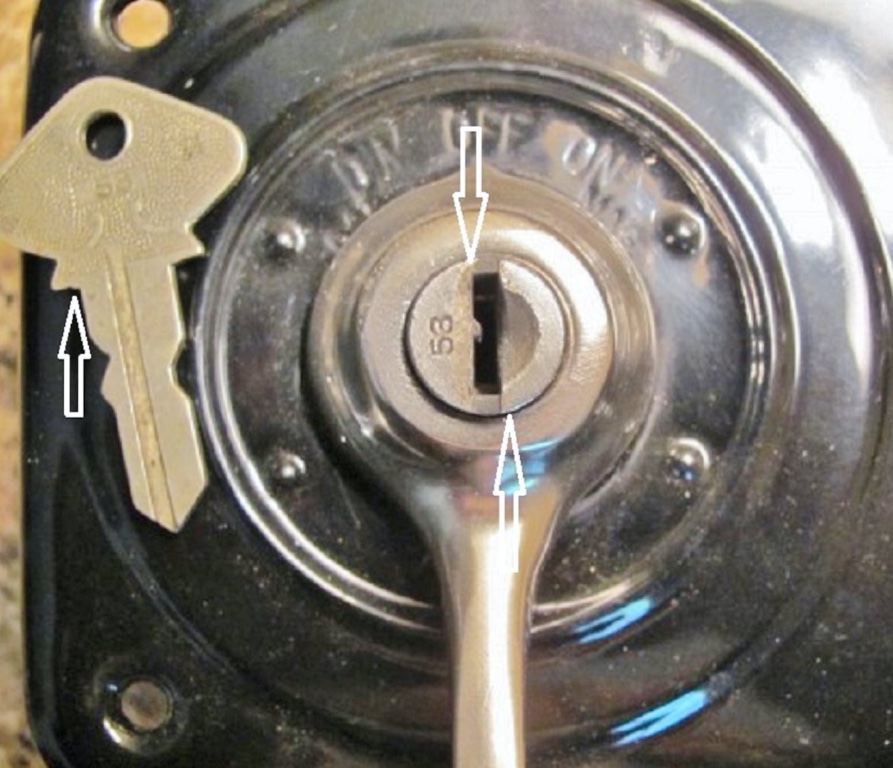

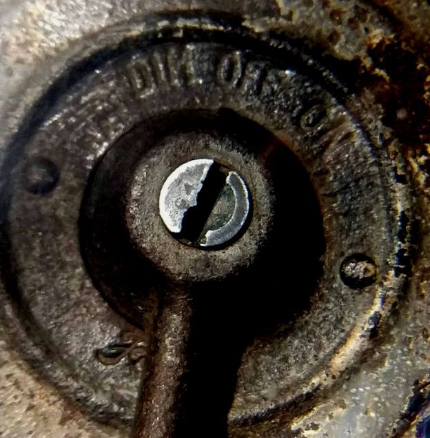

I agree with Jerry V. Your pot metal cylinder is missing a couple small chunks above and below the key slot. Try pulling the key out slightly. It may be going in to far.
Far to many times the reproduction keys are incorrectly blamed for not working when the 100 year old, worn out, swelled, and gummed up pot metal lock cylinder is usually the problem.

Good of that fix, so your key can operate the switch. As others noted, the pot-metal tumbler gets very worn out over the years, esp. with hard snapping of the switch, rapid key placement and removal, and even hanging a wad of other keys on a chain that dangles from an inserted key.
The design is made to give protection to the soft metal tumbler, as that tumbler has two corresponding recesses in the face.
Note the Model T key has mating notches that engage the tumbler and rests on the recesses, that helps to prevent too deep key placement that can lock the innards up. Plus it gives the proper leverage for the key to turn the switch to BAT or MAG.
Taking care to insert the key gently into an old switch tumbler will help preserve it.

There is a bit of missing pot metal at the bottom and top of the key slot as Dan's photo shows. Thanks Dan.
Question: would anybody try to fix that by putting a tiny bit of epoxy there? It would be like brain surgery precision. I'd like to hear if anybody has attempted it. I'm not sure I would, but I might if it could be done.
Or.... maybe I'll just leave it alone and be cautious about inserting the key. I'm not actually using this switch as I have 2 Improved cars, but I may in the future.

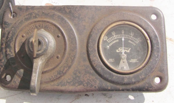

Dan's photo has 4 rivets holding the switch on. Mine has only 2. Is this an early/late thing? Which would be which?
John
John
- Posts: 4045
Re: help figuring out what this key number is

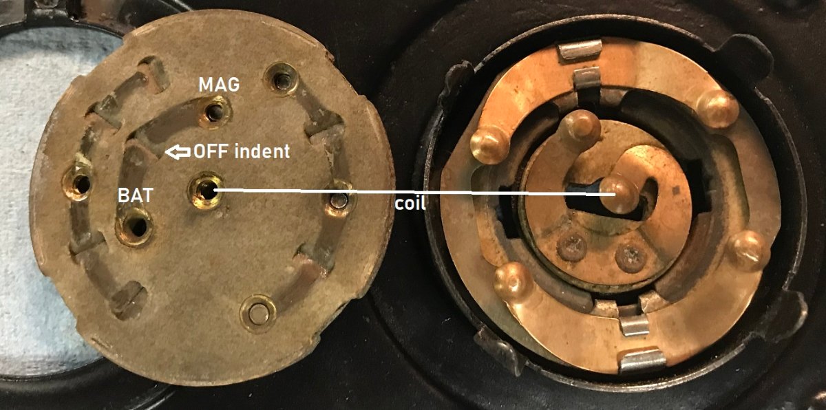

The multiple rivet switch plates are early, there are many variations, esp. the early closed cars in 1919 that were first to have electric start, these used a unique switch without a panel and the ammeter was also separate up to about March of 1919. The open cars followed. Switches then came combined on a rectangular steel panel with the ammeter, and were made by several companies early on. Ammeter varied too in design, the early ones are very distinct. Then Ford kinda settled on a particular design, that is the common 2-rivet plate after about the 1920 model year, perhaps 1921.
Early 4-rivet plate.
Early 2-rivet with Bat and Mag on the center collar of the large cast nickel plated switch handle.

NY John T ..... Your 1926 year switch assembly was always mounted with two rivets on either a painted or plated mounting plate, that is oval sized instead of the earlier rectangular sized plate..... Except on the 26-27 TT TRUCK that still used the earlier rectangular plate mount assembly.
