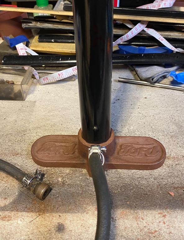

Spent some time refurbishing my tire pump. Cylinder all smooth and shiny.
Forgive the modern hose clamps. I cleaned the hose to tube connection. It was clogged tight. It pumps air and does inflate a bicycle tube. There’s no ball bearing in it. And I didn’t remove the valve plunger.
What color should the base be? Right now it’s red oxide.

Don't bet the farm on this, but I think all black would be correct. I left the tube polished brass, but I think it's incorrect. My version of "natural" wheels.

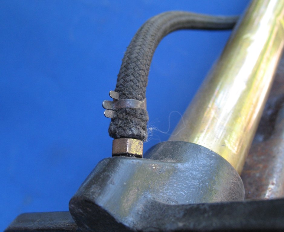

I was pleasantly surprised to find that the local Ace Hardware had the old style compression clamps you loosen with pliers to install.

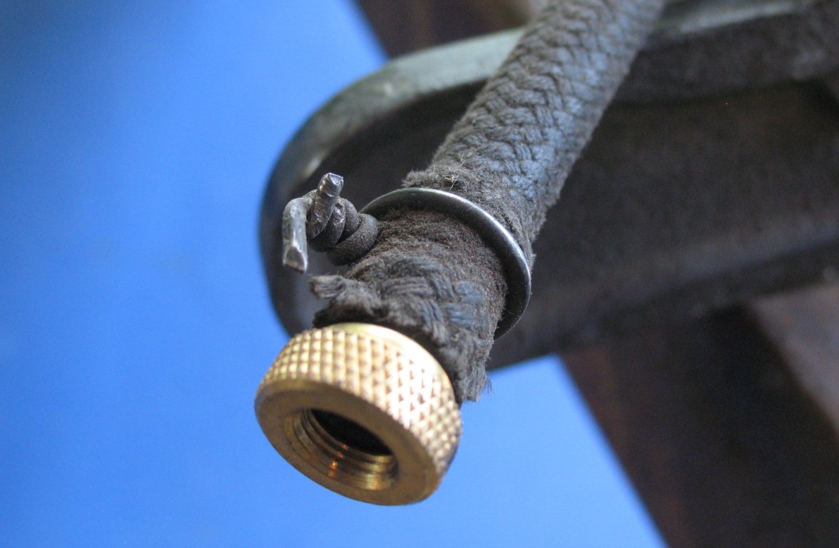

At the pump end of the hose is a clamp from the hardware store.
At the other end I have twisted baling wire. I'm not sure why. I probably broke the real clamp trying to install it.

When I removed my chuck to clean it, it was secured with wire as well.Steve Jelf wrote: ↑Tue Jul 04, 2023 4:24 pmIMG_0328 copy.JPG
William L Vanderburg
1922 Center Door Sedan
- Posts: 7411
Re: Tire pump
The standard Ford repair kit.
