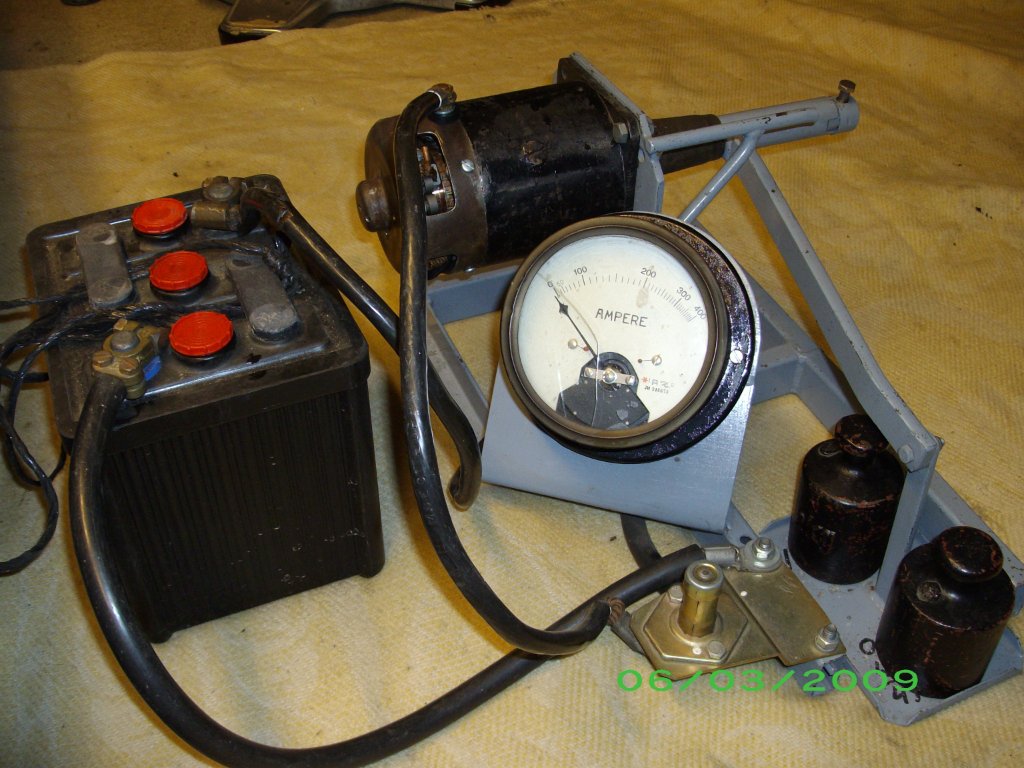

To know or your starter is working right ,
The best way is to test them . Toon
