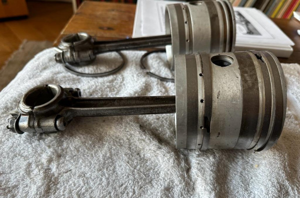

I had to work on the transmission of my car, and decided to check the engine.
I checked the pistons, and cleaned the rings, without removing them. I opened the holes in the piston skirt.
The cylinders were looking good, and I did a rapid honing with a 3 stone tool.
Since restart, the engine is smoking and consuming oil like hell !
All cylinders are concerned. The spark plug are all oily.
A friend of mine told me never to clean the piston grooves and rings, unless changing them.
The question now is how far should I redo the work ?
I removed the head (OHC Montier), and the lower crankcase cover, and remove the pistons.
I measured the diameters of the cylinders, ½”, 2” and 3½” from top, in axial and transverse directions.
The diameters are ranging from 3.371” to 3.374” all together, with differences from 1.2 to 2.7 thou within the cylinders.
It seems that the engine block is quite good, never machined.

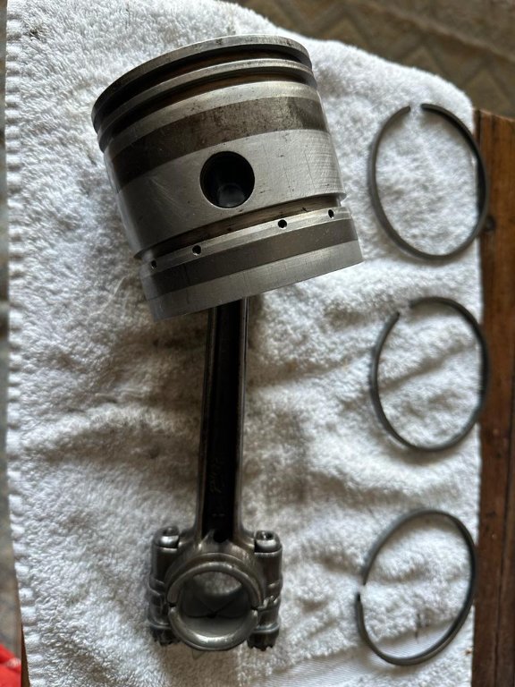

My pistons must be original Montier aluminum ones, with 2 steel frets.
Skirt diameter 3.740”, top diameter 3.724”.
The rings are metric size, 5mm high, 3mm thick.

Questions :
What made the engine consuming oil through all cylinders ? Just cleaning the rings ? The car was not smoking before (I drove 200 miles since I get the car).
Can I go with just changing rings ?
Should I keep the same simple rectangular shape for all rings ?
Should I machine the groove to be sure of the shape, and possibly add a shim ?
Or just put new pistons, less authentic !

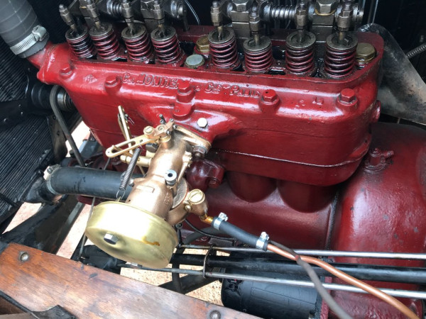

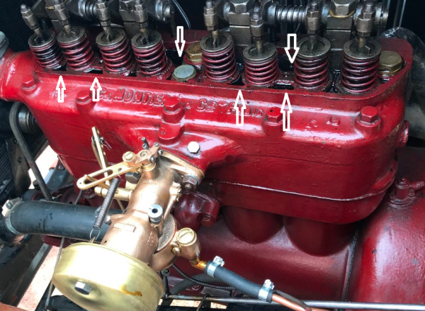

Another possibility is to much oil in the cam cover. You said there is a OHC Montier head. There must be a oil pump to lube the cam. Possibility there was a orifice in a line that fell out flooding the valve guides.
Show a picture of the head/ motor please.

There is no cam cover in this version.
And no oil pump.
