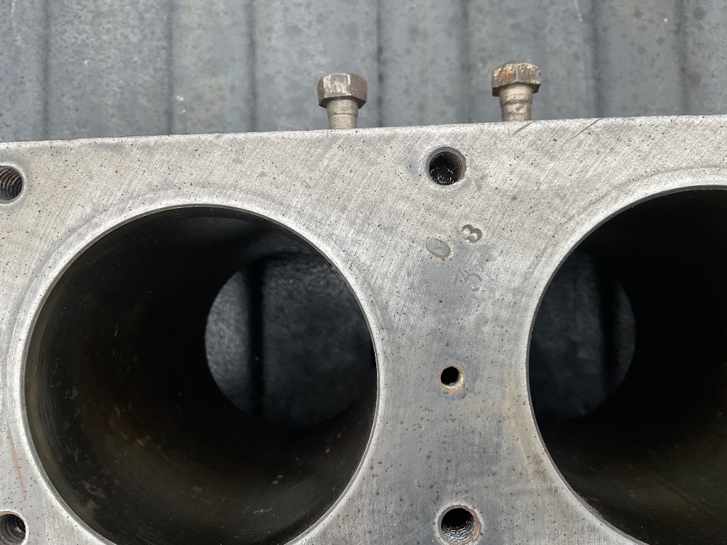

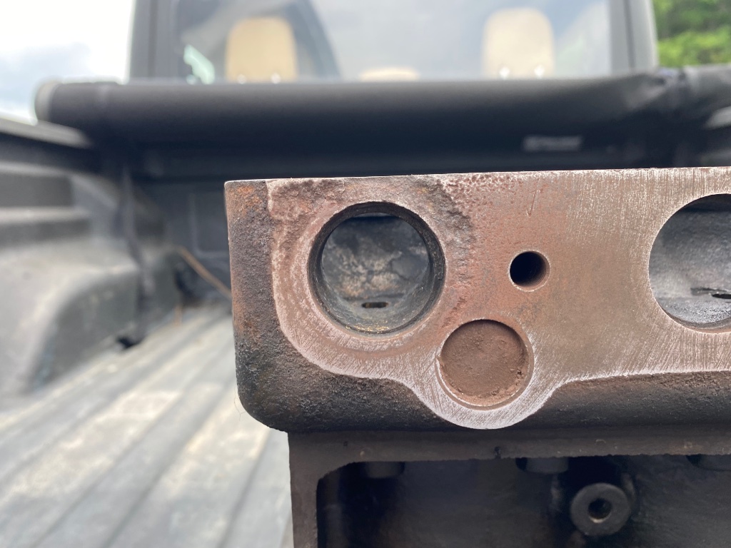

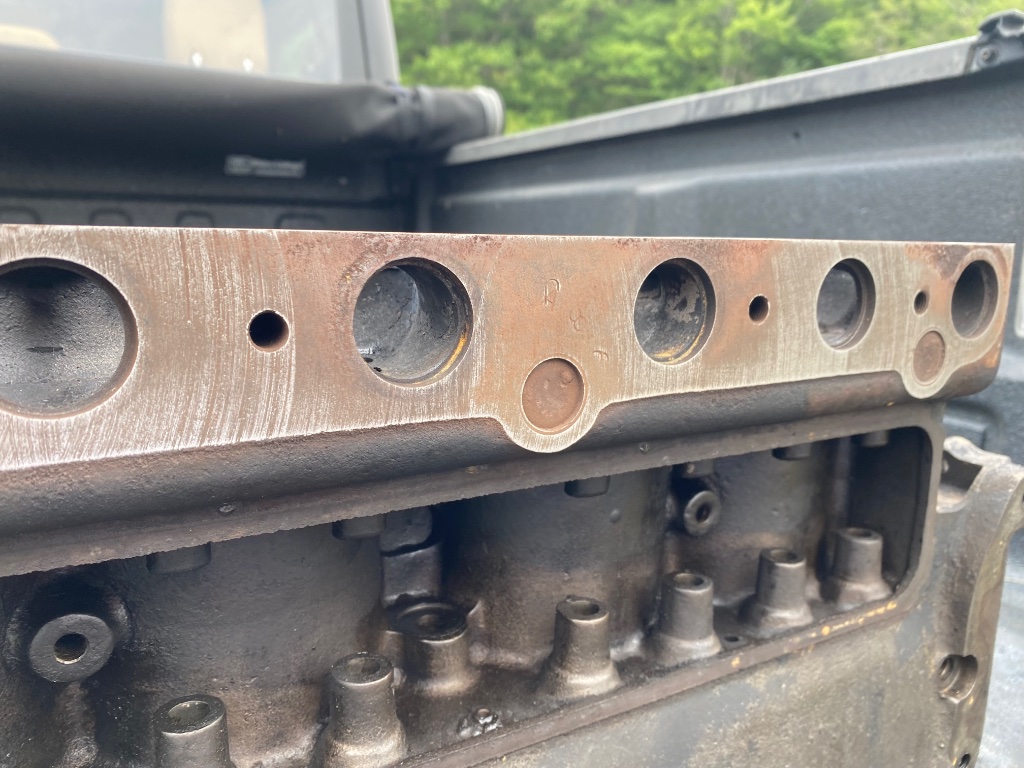

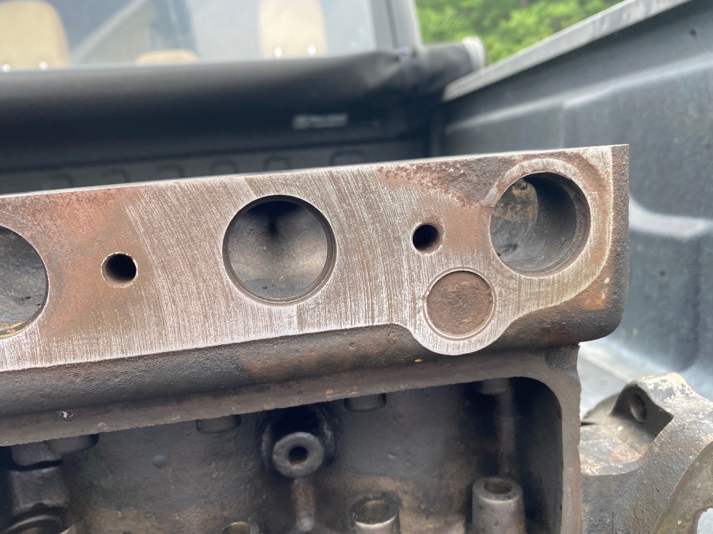

The engine is out of the 27 and the crankshaft has been removed….. it’s ready to be taken over to the machine shop to have the Babbitt removed and the engine block hot dipped…. Does anyone have a rough idea of how many thousands can safely be removed from the top of the block before you run into the danger of pistons slapping the head….. ditto for the intake, exhaust port area….. I’ve got a little bit of pitting by the number four exhaust port on the side of the block.

A great question Frank….who knows if it’s been decked!

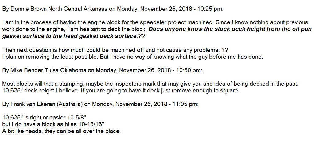

This discussion mentions a measurement from the pan up https://www.mtfca.com/discus/messages/8 ... 1543422653Flyingpiper59 wrote: ↑Sun Jul 09, 2023 12:27 pmA great question Frank….who knows if it’s been decked!

you had original "x" rods and tin can pistons as I recall, so your engine has a 99%+ chance of not having been refreshed much less rebuilt and decked.
I'd be surprised if it didn't clean up with .005" or so

To Scott’s point….stamping clearly visible…. it doesn’t look as though it’s
Been decked

Re: Engine decking
