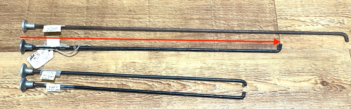

The measure is made OverAll. From top of knob to centerline of the rod. (At the bend where the rod engages the bell crank hole.)
Don't know much on repro parts, but most need some massaging to make 'em fit. ;)
Do know the #4588D factory measure is same as my measure of Overall. That is 13 1/16" overall. Right at the hole in the bend, where that is the center of the rod. Makes sense as that is the point of entry of the bend. And know that this rod fits '23-'25 open cars. (the 2 lower rods in the photo are for '23-'25 open cars.

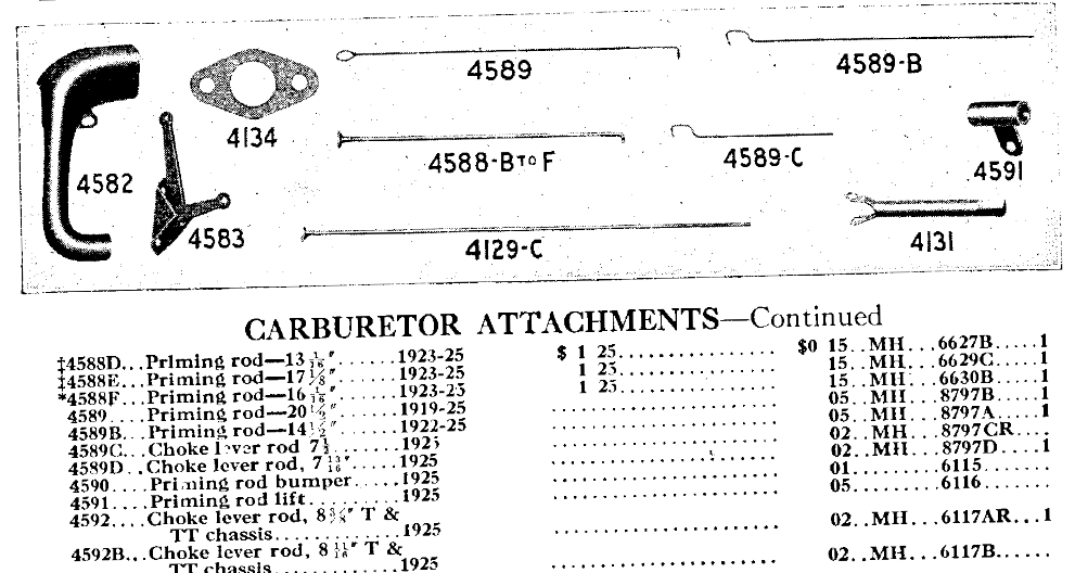

Would T-4588-E at 17-1/8" be the one? Could you remove the knob on the T-4588-B (or T-4587-B) and shorten that end and replace the knob I think the knob is only held in place with by a Split Spring Roll Dowel Pin
From the 1925 Wholesale Price List

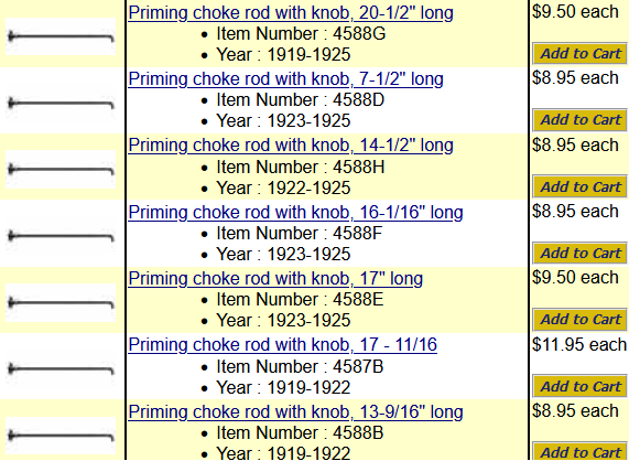

This is what Langs Lists
priming choke rod w knob.png (53.7 KiB) Viewed 1206 times

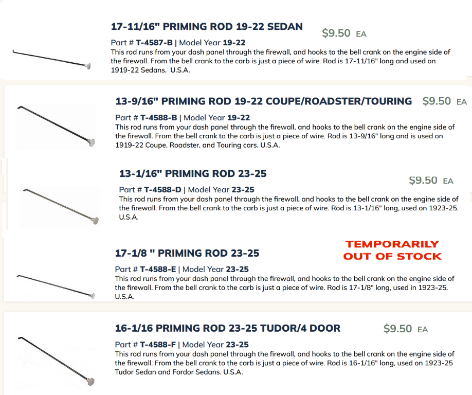

Snyder's relates to Model just same rods
