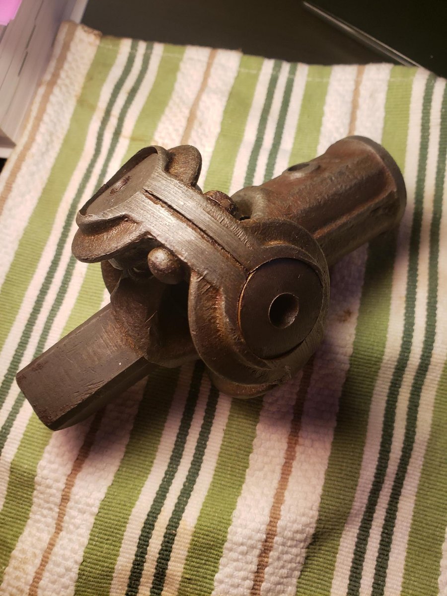

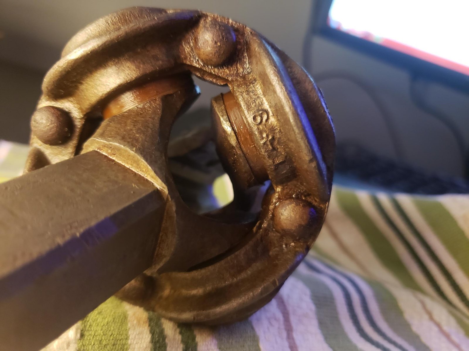

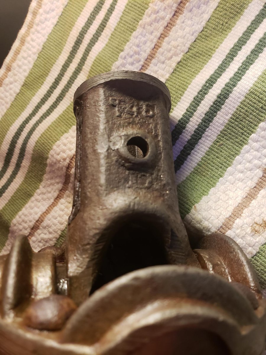

Hello, I recently found a universal joint at a flea market and bought it as a novelty to clean. After cleaning, I found a Ford marking, and did some googling which brought me here. Is it possible to tell the year or type of vehicle/engine this part was used in? It is marked on various parts "Ford" "T49"

Any insight appreciated.

The "T" number is most likely the Ford Factory number and that u-joint fits all years & models.

All years of the Ford Model T car and truck, 1908 to 1927.
