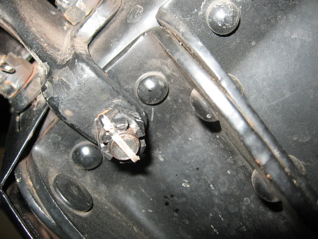

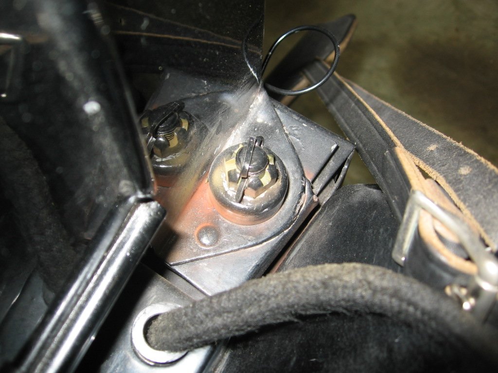

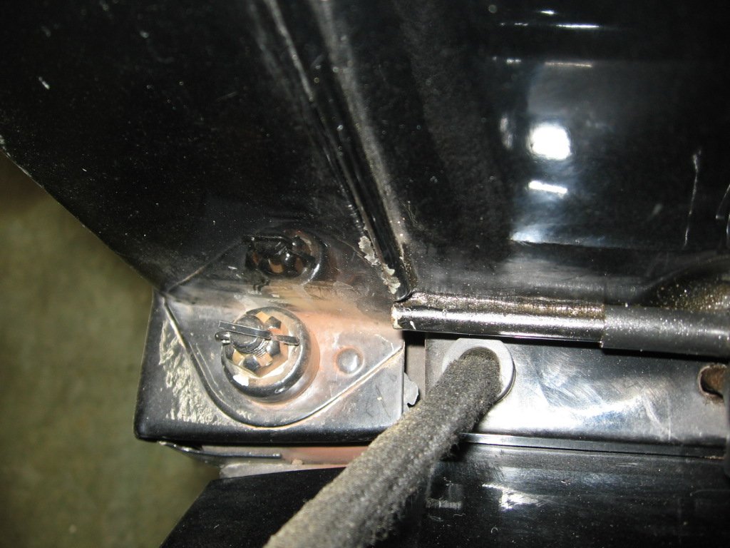

Here are some photos I just took of my 1924, are they of any help?

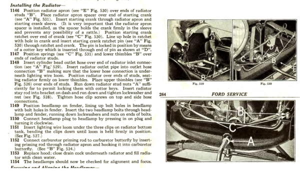

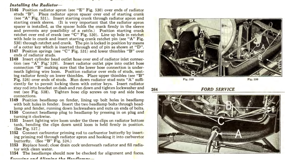

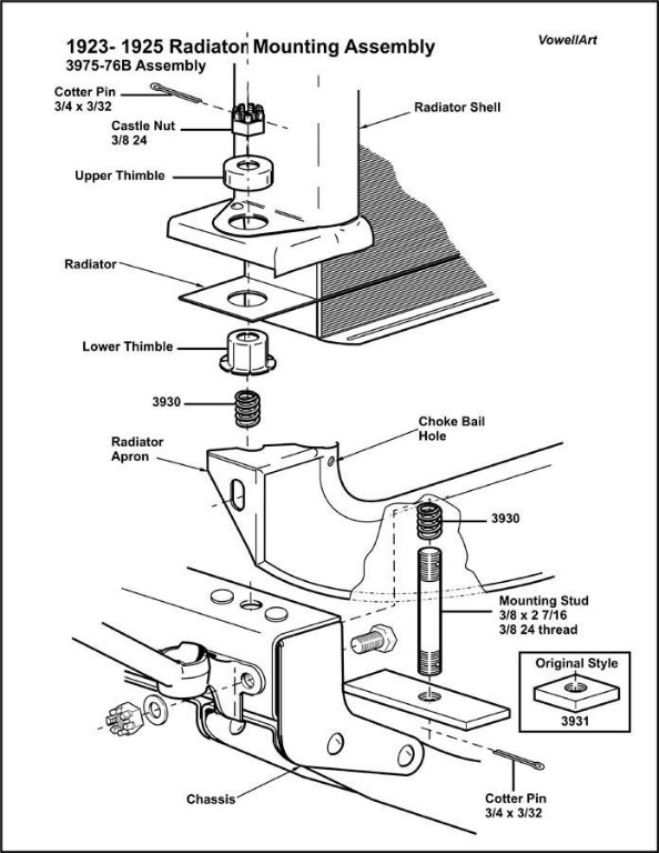

FORD Service Manual 1925 - what they don't mention can be assumed to be in place
https://www.cimorelli.com/mtdl/servicem ... mcolor.pdf
