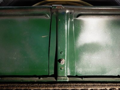

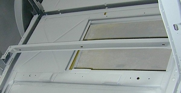

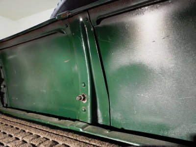

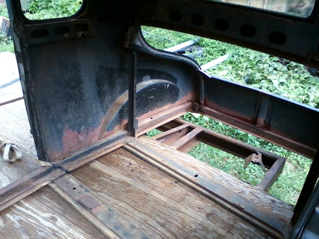

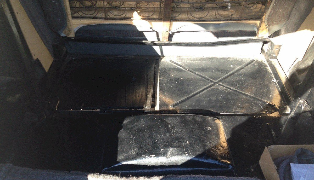

John,

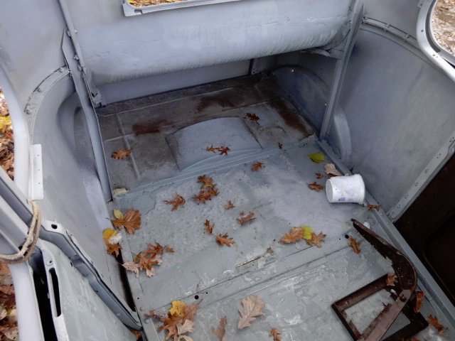

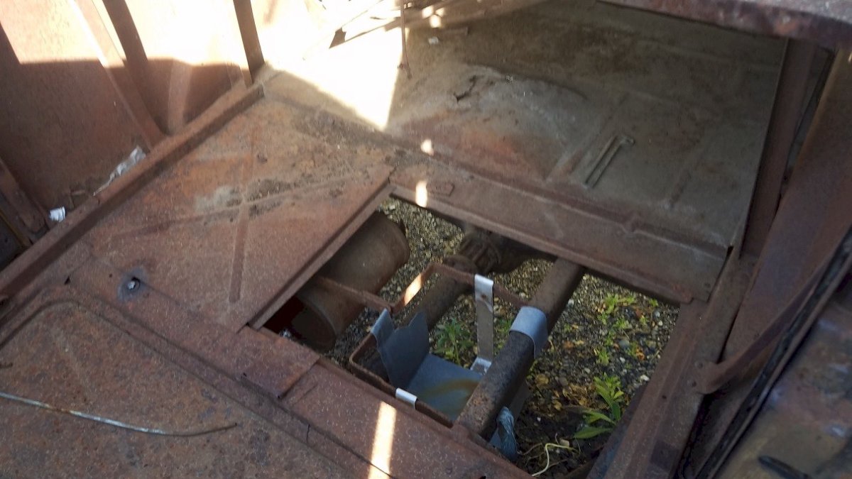

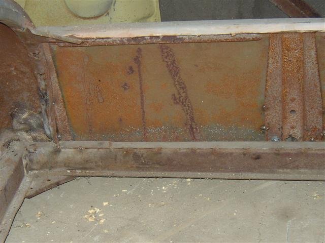

Here are some trunk area photos (don't remember the source):
trunk 786180.jpg (28.51 KiB) Viewed 1846 times
trunk 786181.jpg (31.47 KiB) Viewed 1846 times
trunk 786182.jpg (26.18 KiB) Viewed 1846 times
Vern (Vieux Carre)

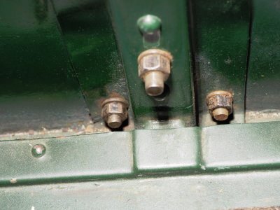

John,

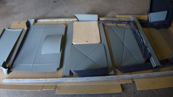

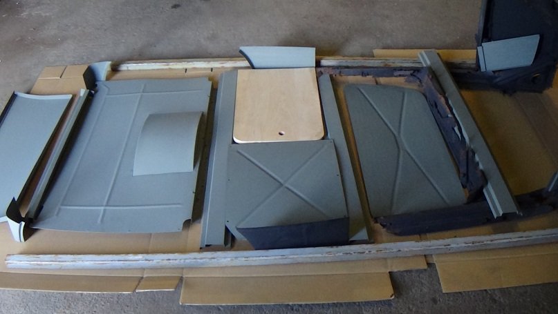

Here are some new parts mocked up:
Vern (Vieux Carre)

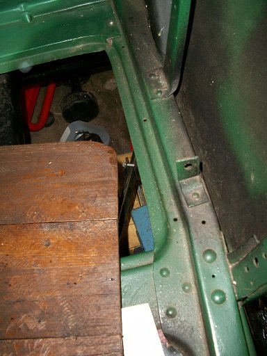

Post by varmint » Thu Aug 10, 2023 6:15 pm
I did not have a sub floor, as it had rotted away. So, I gathered all I could:
Vern (Vieux Carre)

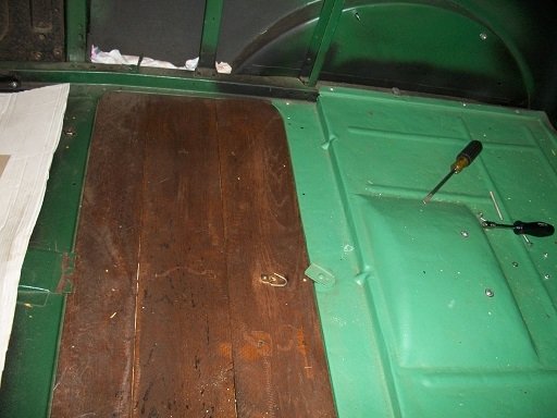

Post by varmint » Thu Aug 10, 2023 6:24 pm

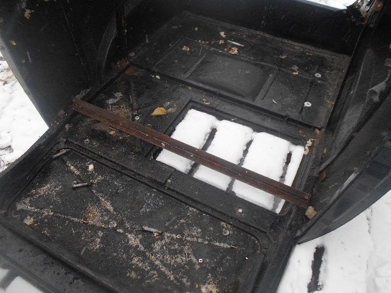

More pics, hope some will do you good:
Vern (Vieux Carre)
