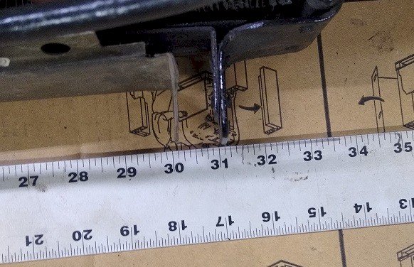

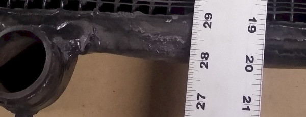

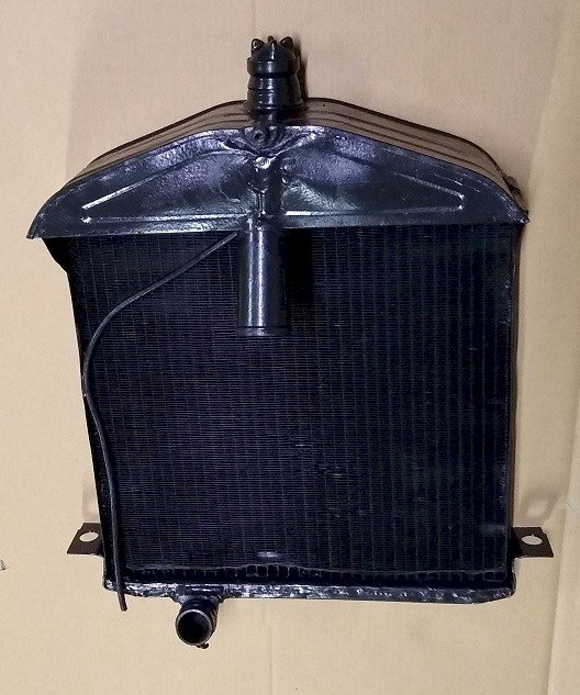

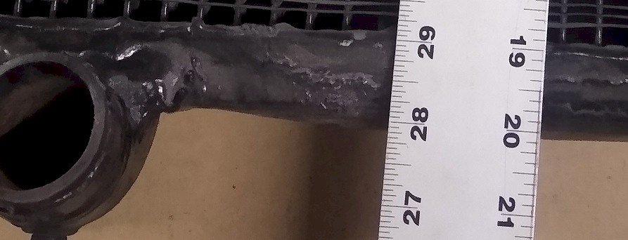

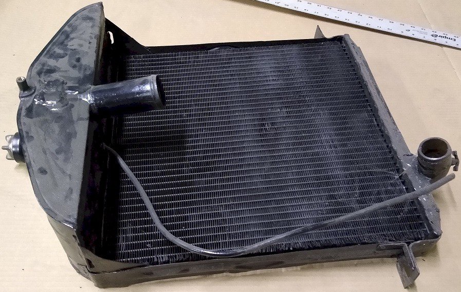

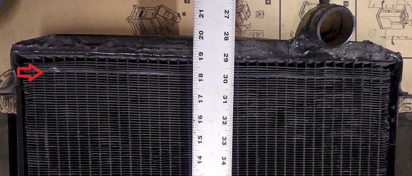

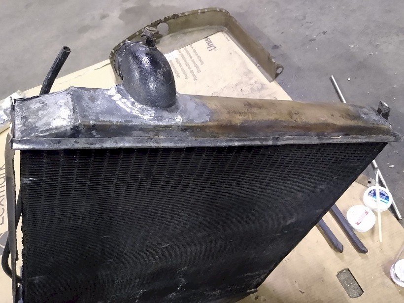

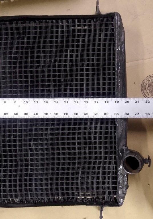

After double checking the radiator shell and convinced that it's OK and taking measurements of the radiator and sure that it's too tall, it's time to cut.
There are new radiators available, which would also require me to purchase a fan hub, then tax and shipping comes to about $980. So why not try and salvage what I've got first.
The gap is about 3/4". The radiator core should be 18-3/8" but is 18-7/8". So the core is about 1/2" too tall and the top tank is 1/4" too tall.
I don't see any reason to shorten the tank...just shorted the core by 3/4".

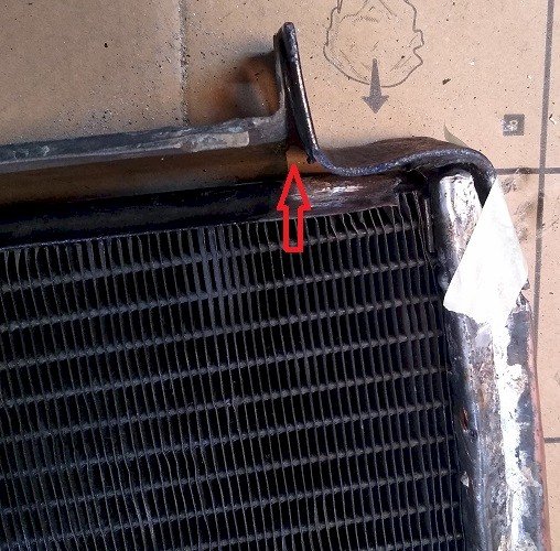

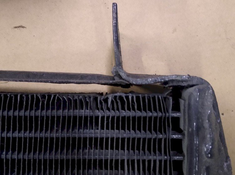

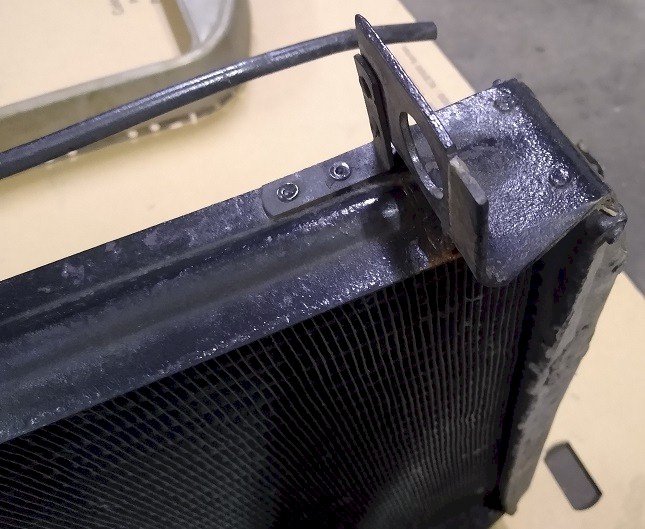

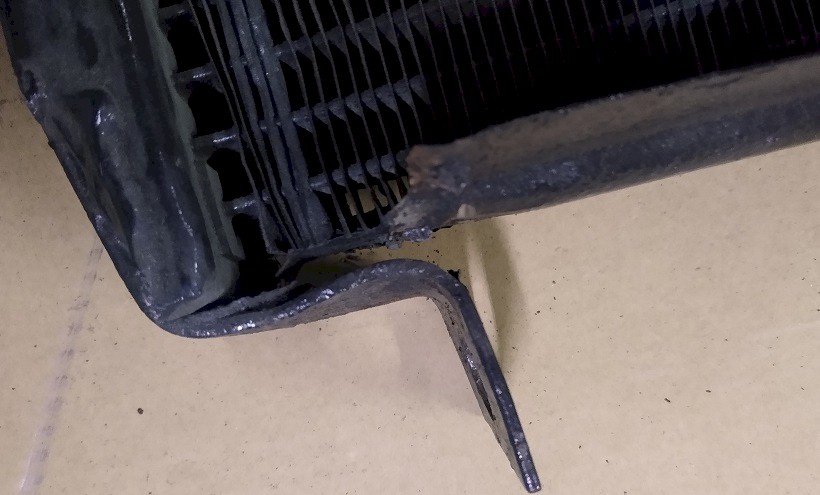

The side straps are two-piece steel which overlap, barely welded together, and a random bracket on one side.
It should be easy to cut the welds, overlap them 3/4" after the core is shortened.

Would it be possible to cut the steel brackets off the sides and simply move them up the radiators sides a bit? dropping it down in the frame?

Just a thought Vernon, why not just move the mounting tabs instead of cutting the core? You should have plenty of room based on your gap for the shift on the frame by allowing it to sit lower in the frame. If you’ll note the bottom tank is narrower at the edges and that should allow the radiator to sit lower in the frame. The bottom strap may need some material welded to it to match up the hole once moved but certainly an easier project vs your initial plan. On The upper tabs, Pop the rivets and move it the amount needed, then re rivet or bolt with grade 8 bolts & lock, nut once you are at the level you need to be, then you can add the additional material on the bottom tab & bend to meet the upper tabs, drill hole and your set.

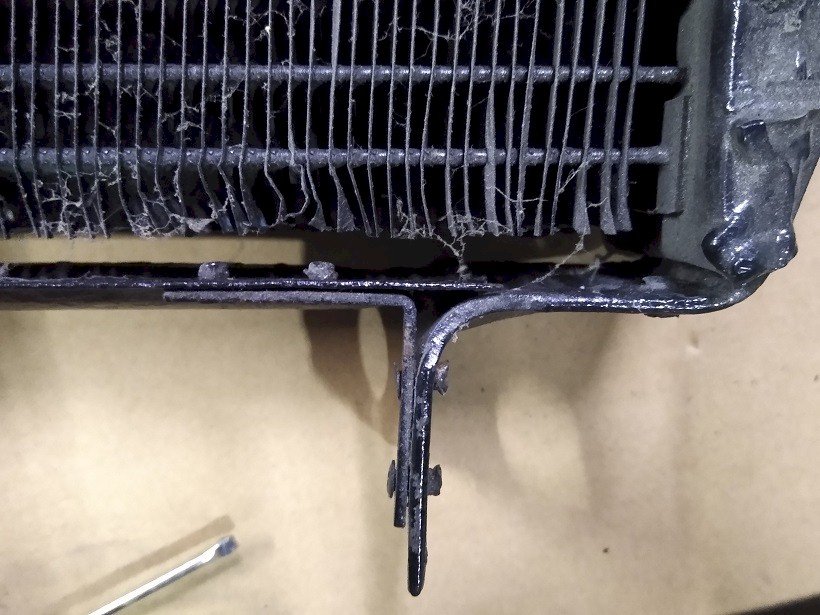

In one of the older posts, tried to raise the two side brackets but the hand crank is in the way. Cannot lower it.

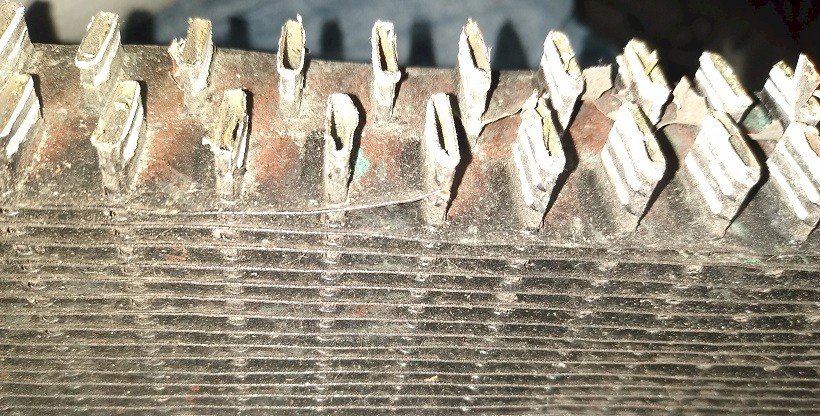

Bent the fins down all the way across to mark 3/4" that will have to get removed.
Cut the tiny welds on the steel side brackets.
I mean...even if this fails, don't you want to see what happens next?

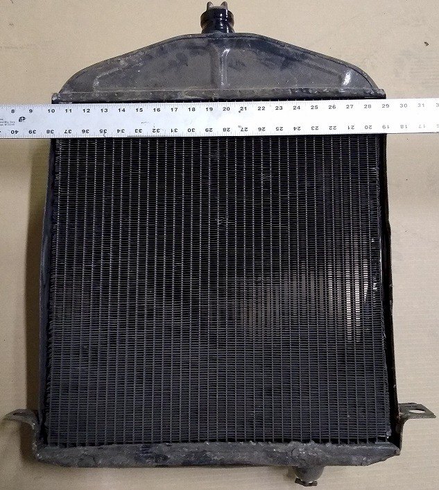

I am curious as to how a radiator got to be a "Odd" size anyway?
- Posts: 4689
Re: Radiator...time to cut it shorter.
The radiator looks like a flat tube. Ford made a flat tube for a while for the 26-27 T’s. If it’s not a T radiator it could be a aftermarket or recore that built up later. It can be made to fit with blocks or shims to fit with what you have. It won’t be perfect but would work.

There are flat tubes but does not say "Ford" anywhere on it. Maybe someone may want to try to identify what this really is (besides scrap).

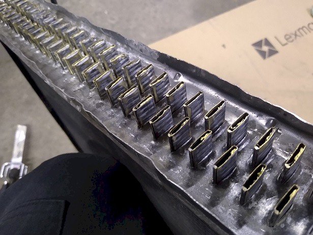

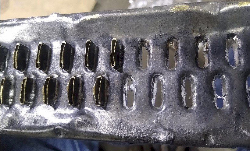

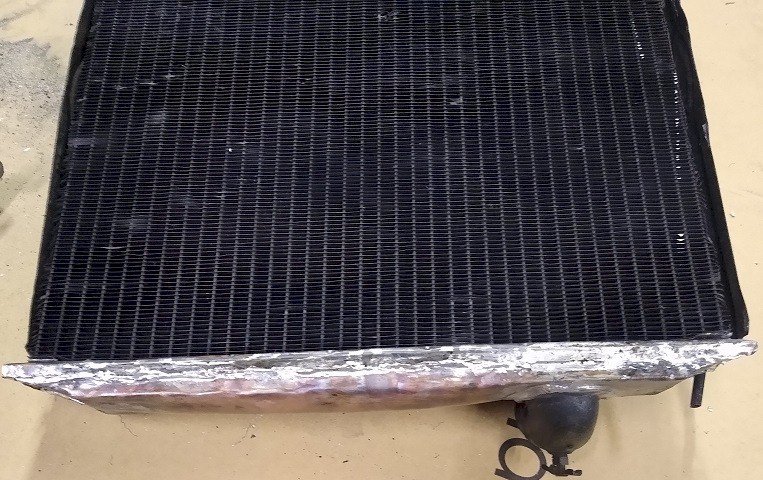

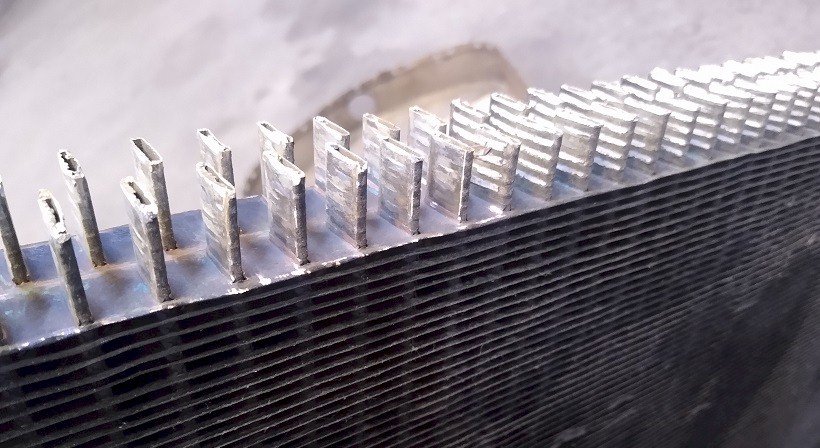

varmint
Topic author - Posts: 1042
- First Name: Vernon
- Last Name: Worley
- Location: New Orleans, LA

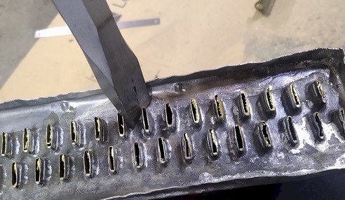

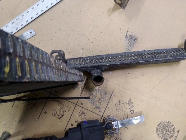

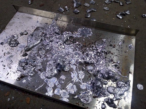

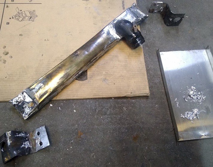

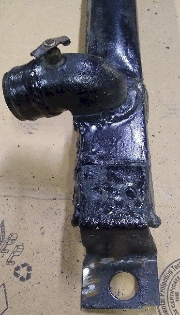

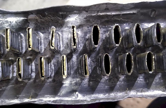

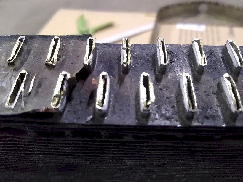

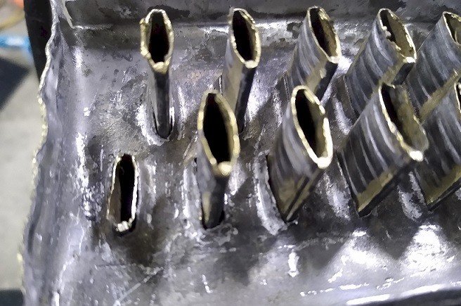

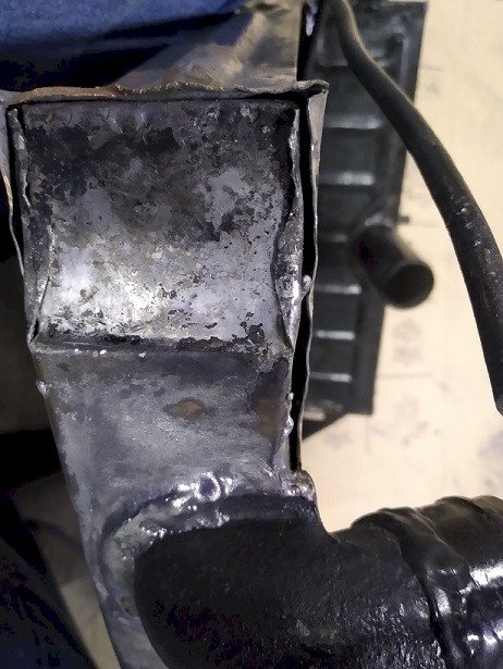

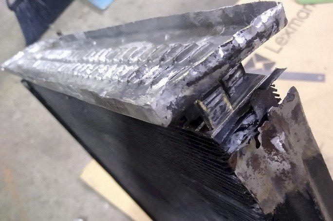

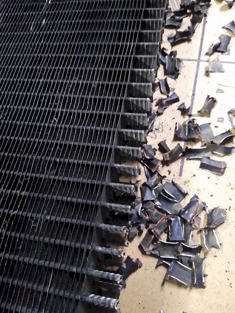

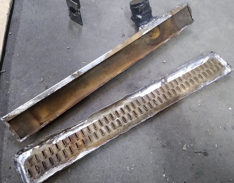

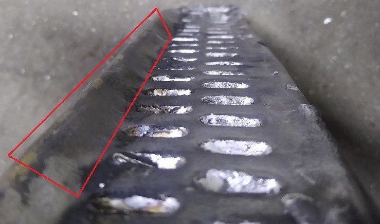

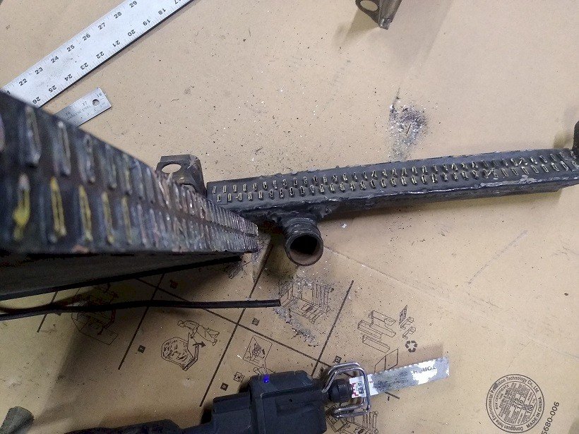

Cut!
Now, time to remove paint before sweating the parts off.

- Posts: 7292
Vernon, cutting the core at the bottom is a stroke of genius! It will be much easier to work with the bottom tank than the top one. This will mean trimming the steel side straps to length, an easy fix. It might have been easier to remove the bottom tank first, and then the base header from the full core. Now you have little to hold on to when working on the cut-off section. Good luck with tinning and re soddering the header to the core.
Obviously, there are two rows, saw that before I cut it.
Only removing the bottom tank to do all the work and leaving the top tank on untouched.
The two mounting brackets have a "left" and a "right" since the bolt hole shifts away from the inlet and outlet pipes.
It looks like somebody has worked on this tank before.
Pat,
With the tank directly on the frame, there was at least an inch gap.
Scott,
I imagine you with right now as a wobble head dash ornament, "shaking head".
John,
Yes, this T has the longer fan hub, the reason for even bothering with this economy radiator. If it fails to cool, then we replace the radiator and fan hub together.
Allan,
The separation between the side steel brackets is at the lower tank. No trimming of straps necessary. They will simply overlap better by 3/4".
Pealing away the layers. The flat tubes are brass and the fins are copper.

While you have the tank off, rod out the core.
You can cut aluminum strips 1/8" or so under width & of various thicknesses.
Gently push thru each tube to ensure there are no obstructions.

1) Filed the tubes on the left, right side is untouched.
2) Wire wheeled the paint off the tank. Sweated off the brackets (left and right are different).
Stainless pan to catch the drippings, for reuse or not.
3) Separated the tank.
4) These brass tube stubs need to all leave.
Vern (Vieux Carre)

Yes John,
Saw quite a few videos of workers running metal strips with teeth down a core.
That did not take long at all, just a torch and then shake off the little brass guys off.
Collecting more solder to maybe reuse, it's expensive but I got a fresh new roll just for this project.
The brass plate was warped on the left side before I started.

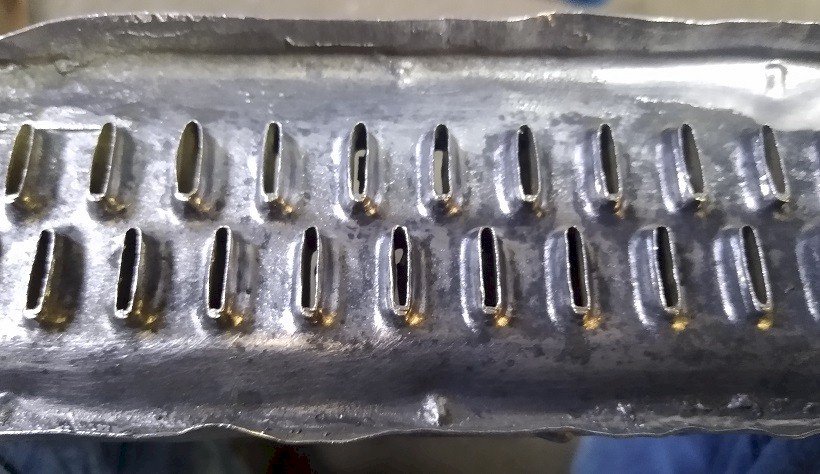

Straightened the plate.
Wire brushed the inside of the tank pieces.
Even - Odd number of tubes, can only go on one way.
Tapped down in place
Expanded the tubes for a tight solder fit.
Filed the burrs.
Need to cut the tubes shorter and file again but not as short as the broken tube on the end.
Filed the burrs.
Vern (Vieux Carre)
varmint
- Last Name: Worley
The gap between the radiator bracket and the shell is now zero.
Vern (Vieux Carre)
