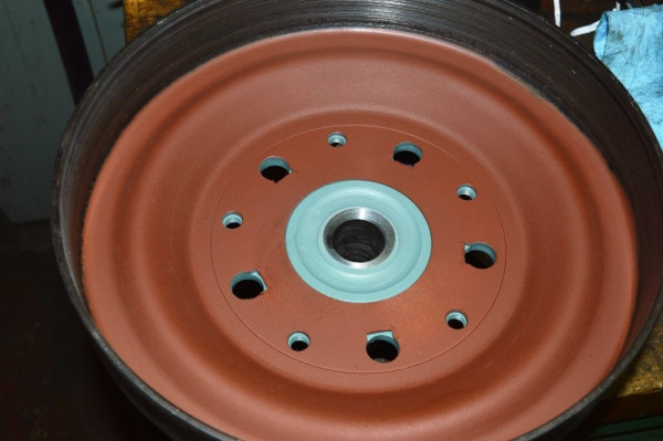

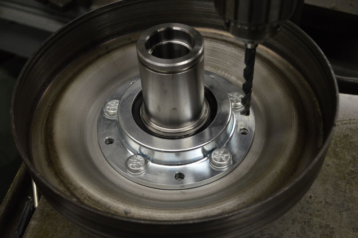

It's a really bad idea to use the 5 Ford wire wheel studs to attach a safety hub to the wheel hub/brake drum assembly. Same goes for using the 6 wheel bolts on a wood wheel to mount the safety hub flange. A safety hub flange needs to be bolted to the wheel hub with its own set of grade 8 bolts. This requires drilling and tapping threads into the hub flange between the wheel bolts or wire wheel studs. The goal is to transfer the car weight from the safety hub flange to the wheel hub without relying on the wheel bolts.

The flange breaking off of hubs is 99% of the time due to the outer plate not being a tight fit on the hub and the bolts not being tight. These two conditions allows the hub flange to flex while cornering, fatigue and ultimately fail. (Repeated Left and right turns create a fully reversed bending moment at the base of the hub flange.) My previous point was that you do NOT want the safety hub flange attaching bolts to be thru bolted on a wood wheel. As stated, the purpose of safety hubs is to guard guard against axle failure and subsequent wheel loss. They are not a universal solution to all potential wheel problems.

Thanks Jerry for the added commentary. Here are a few pictures- I was on another machine yesterday and had no pictures.
Regarding wood wheel installations- the 6 wood wheel bolts cannot ( in my experience) be torqued tight enough to provide a sufficient and reliable clamp force between the safety hub flange and the inside of the brake drum. This clamp force must now carry the weight of the car in addition to holding the spokes to the wheel hub. The wood is not stiff enough even if the wheel bolts could be torqued tight enough.
