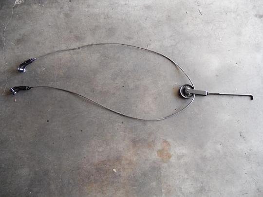

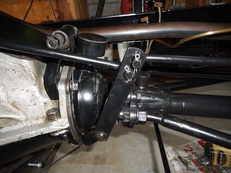

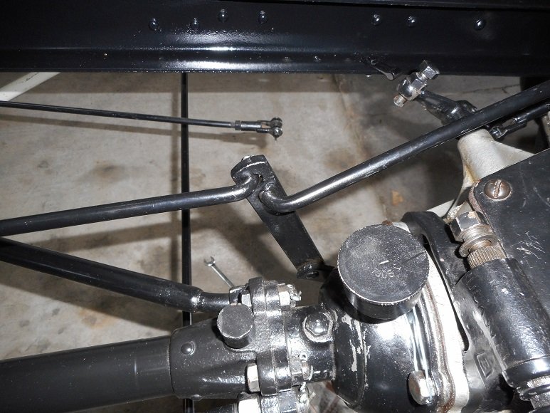

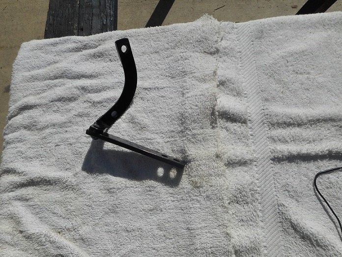

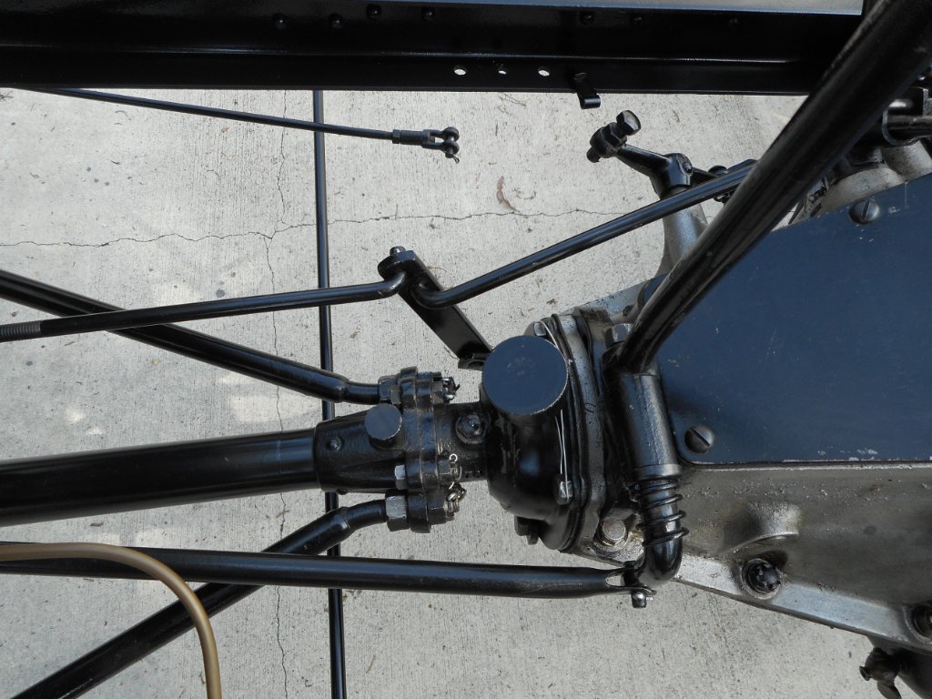

Post by Original Smith » Thu Aug 03, 2023 10:01 am
Here is some photos of original real Rocky Mountain Brake linkage for passenger cars. I can submit lots more pictures if needed.
Equalizer & Cable.JPG (37.1 KiB) Viewed 1903 times

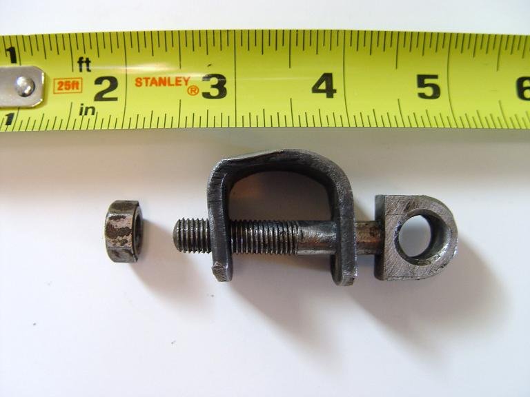

Post by Original Smith » Thu Aug 03, 2023 10:07 am
Here is the pedal clamp

Post by BUSHMIKE » Thu Aug 03, 2023 11:18 am
Thanx guys! Exactly what I was looking for. Being a TT, I know I will have to engineer some of linkage/ratio when the time comes.
