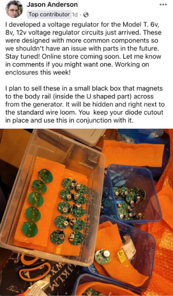

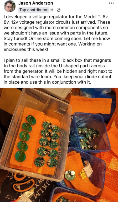

I was browsing on Facebook & saw that a young fellow,Jason Anderson, is going to be offering negative ground 6,8 & 12 volt regulators soon. In his post he states that if it fails it will automatically ground the starter. I’d rather not join the PT BARNUM society but I saw that several folks from the forum were interested in buying several. Does anyone have more detailed information on this? Best John

Not much info yet. He didn't participate in any of our design discussions and has had no contact with anyone from our group and there's no info on how he tested it. He's also very new to the T world, but appears to be learning quickly. Here's what I do know about it:
You'll need to already have a diode based cutout (it will not work with a standard cutout) like Nurex and some of the vendors offer and it's going to be mounted in a black magnetic case and will have to be wired into the battery and generator output. For the adventurous, he says it's small enough that you could tear the diode cutout open and try and mount it inside giving you that "stock"appearance.
That's about it. No details yet on what kind of design he's using or how he tested it. Time will tell. I sincerely wish him luck. He's more than welcome to join the discussion. I cancelled ALL my social media accounts so someone who still has FB should invite him to participate here.

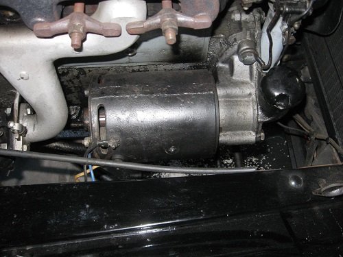

I will keep a check on this thread. Sadly it seems We lost the reliable regulators from John Regan.
I Still to this day wonder why the generator couldn't be converted internally somehow to make it a common 2 brush design so a regular off the shelf 6 or 12 volt regulator could be used.

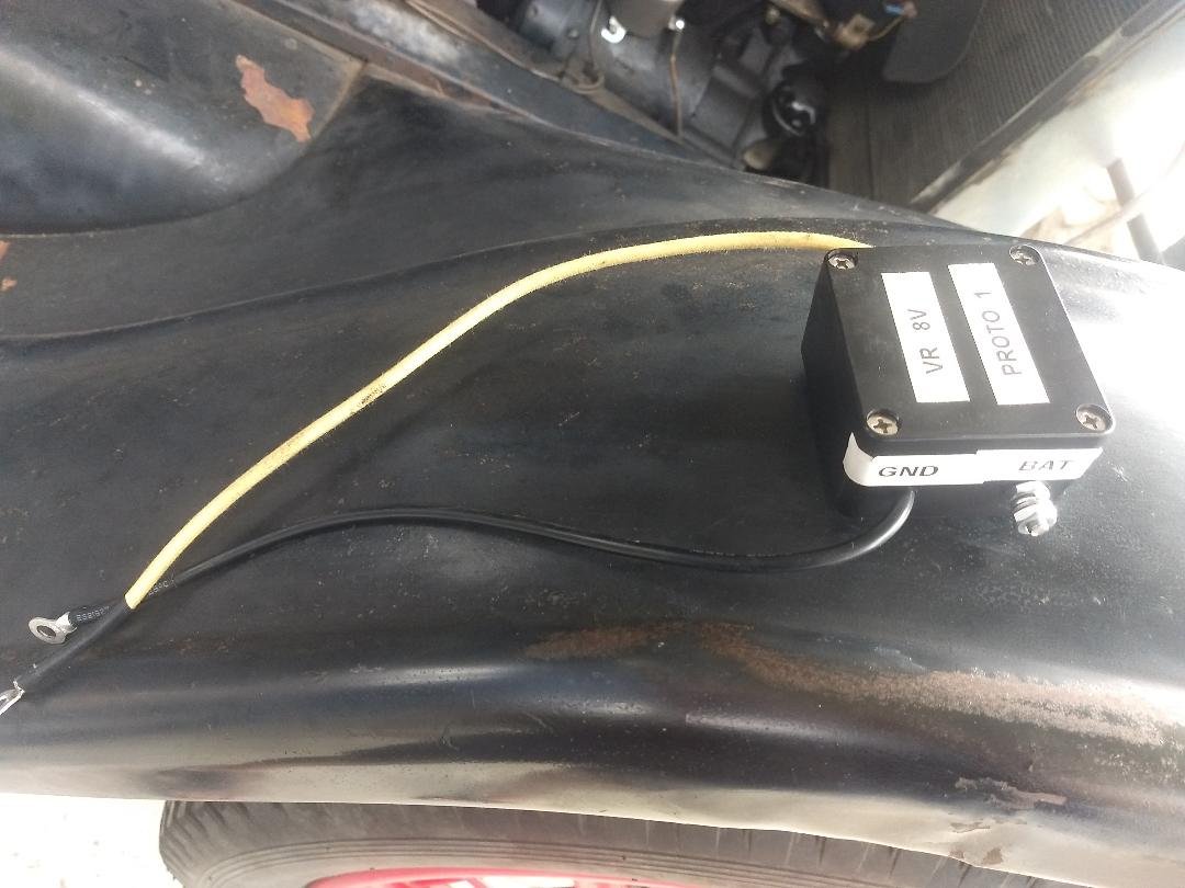

I did get 2 see the 3 voltage versions. Jason has some enclosures coming in a few days & wanted to mount it in before I take possession.
That will allow for a hidden or firewall mount. The circuit board is sized to fit in a mechanical cut out can.
So the unit (it does have a diode built in) can be used remote with an existing diode cutout with or without a by pass wire for visual original appearance. Having cutout cans made is requiring a large investment for the quantity. I suspect they will be offered for the buyer to use an existing can.
Ill update with pictures when I have it. You can see from the face book grab what they look like.

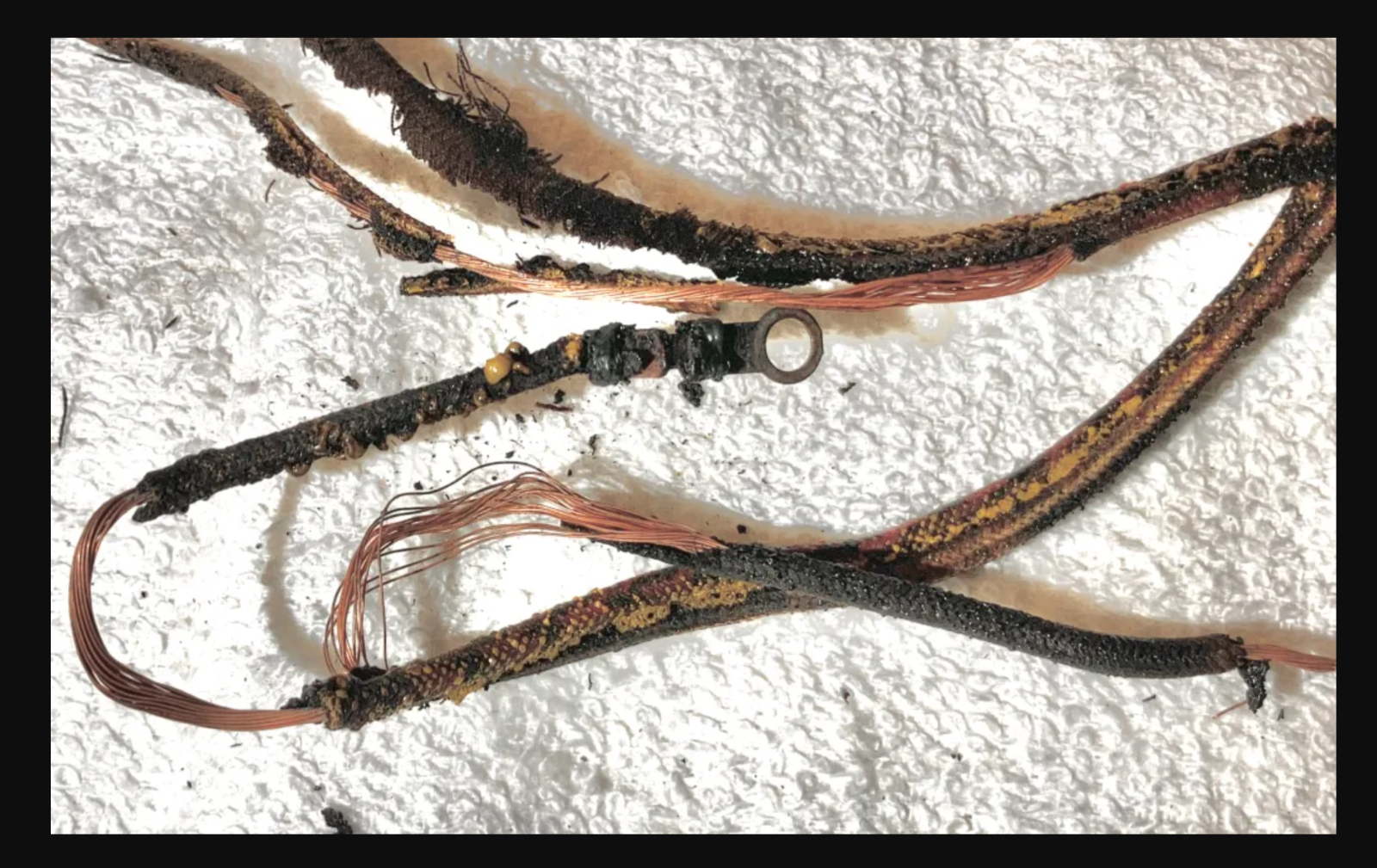

Remember to prioritize safety and reliability when dealing with automotive electronics, as they can have a significant impact on the functionality and safety of your vehicle.
Some will read this as being disingenuous, I can assure you it is anything but...

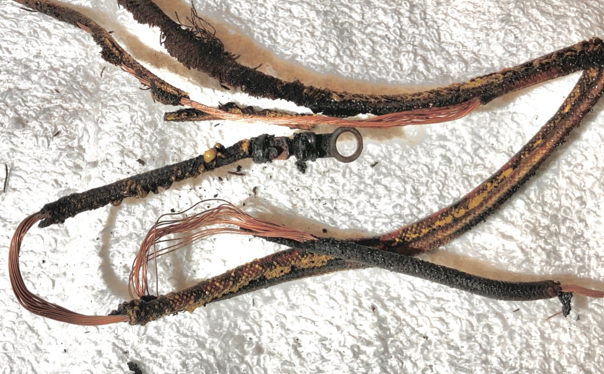

My Model T almost caught on fire after an early voltage regulator circuit design failed and had its way with my wiring. Circuit/physical modifications & recommendations were made to account for this. If our final design fails, your car simply won't charge...

There is no apparent heat sink for that diode that I can see in the pics he posts. The surest way to create a fire situation in a model T is to not have a heat sink on a cutout diode. If it shorts out, see the pics above for an idea of what happens then. I literally was just monitoring my regulator today with an Infrared Thermometer Gun and the heat sink on the diode I have is more than adequate, but it does get HOT, but well within design tolerances. With no heat sink, this would be absolutely catastrophic, and a sure way to create a potential fire situation. Again, see Pic above for more info...
It should be noted here that this can ALSO happen when your original cutout malfunctions and sticks in the on position. It depends entirely on the condition of the generator and battery but is another really good argument for putting a 20A inline fuse in the T charging system. A new generator is a LOT less expensive than replacing the entire car.
I strongly advise a good fire extinguisher be handy when testing unknown electrical components. I keep one of these in my toolbox at all times and I hope I never have to use it:

Late Autolite 12 volt generators used on Ford Falcon, Mustang, Fairlane, etc , can easily be adapted to bolt up to a Model T. I am presently running these on my two T's for over 30 years. I recently had to replace a bearing on one of them. They are no longer being sold but adapting looks easy.
At first glance they don't look out of place on a T like and alternator does.

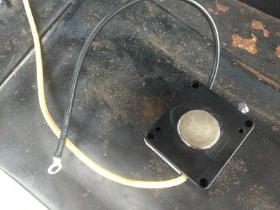

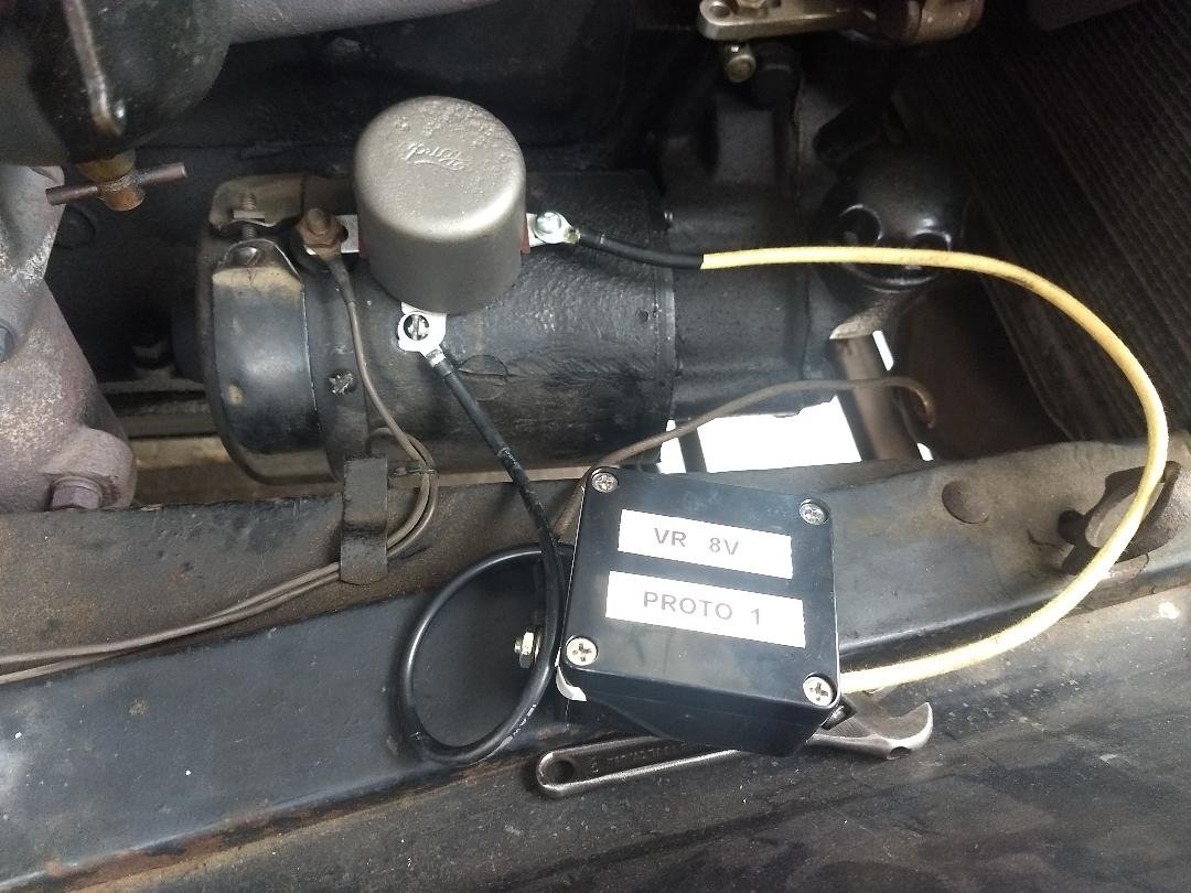

VR UPDATE:
I received the newest VR version from Jason. Magnetic base to stick inside the frame rail out of sight.
I left my diode modified cutout on, but not needed.
The unit (8V) Sends a charge until the battery recovers to 8.25 ish volts, then goes to ground. (shuts off the charging)
Turn on the lights, It starts charging again. Shut the lights off, a minute or so later back to ground to maintain 8.25 volts.
The ammeter needle doesnt have wild swings Test successful.
I will be passing the unit to another member for more testing time. This fellow drives his T truck daily.
He is also running an 8V battery.
I am told 6, 8 & 12 V versions are planned.
There is another version coming soon with a switch to set for any of the 3 voltage requirements.
