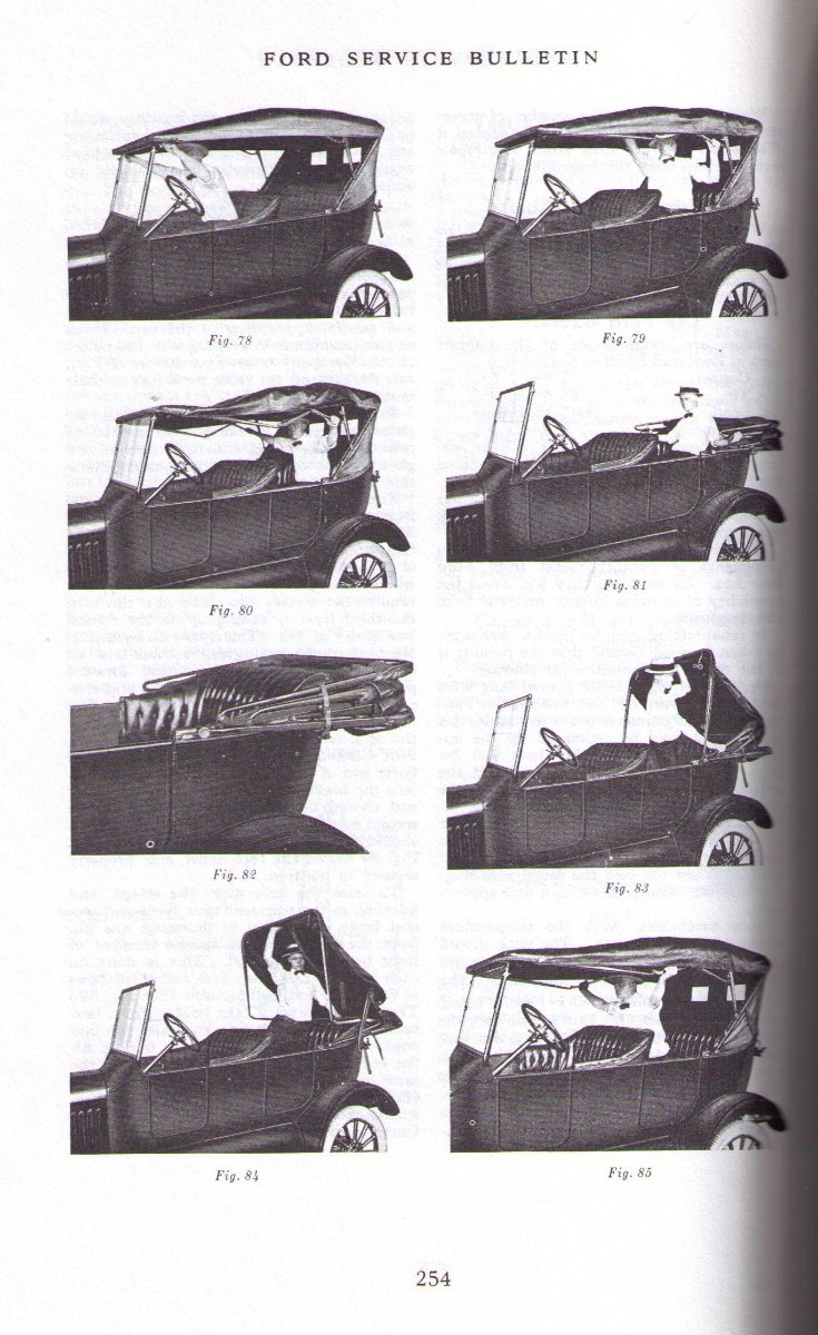

John,
You probably have already seen the "Old School" version with the photos and explanation. But just in case you have not, I have posted them below. They are form the Aug 1922 Service Bulletin.

Thanks Hap. Yes, I've seen this but I'd really like to view it in motion. No doubt over the years somebody has captured it on film in one format or another.
