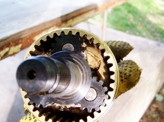

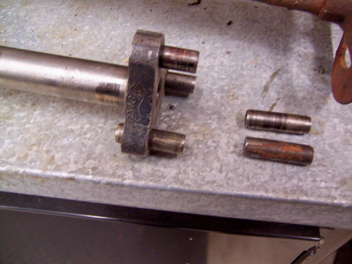

How are the 3 gear pins removed ? Are they press fit or have a thread and unscrew My truck is a 26 but think shafts and gears worn and would like to replace. I have a little bump steer and front end appears tight but will re inspect. Thanks for the help.
Posts: 4084
Re: Change of steering gears?
Post by DanTreace » Sun May 19, 2019 8:51 pm
Just bump the pinion pins out, no threads, press fit.
5 to 1 steering gears.jpg (63.56 KiB) Viewed 7579 times
5:1 planet gears and the 5:1 pinion drive gear must be used on the 5:1 shaft. Won't work with any 4:1 pieces.

I have posted this a few times in the past. I have changed over to the 5to1 gears twice, once on the TT that Dallas has now, and on the "beater'" '25 coupe that we have now. Both times with used gears and steering shaft, It all fit perfectly with no problem, most likely because everything was a bit used. I did use drill rod for the pins that was a bit larger than the original ones, maybe .001 or .002, I don't recall just what size it was, but they fit perfectly in the shaft holes with bit of a press fit. The gears fit very well on the pins and took up the slight wear in the gear bores. Worked great for me along with an aftermarket 17" wood rimmed steering wheel. JMHO Dave
