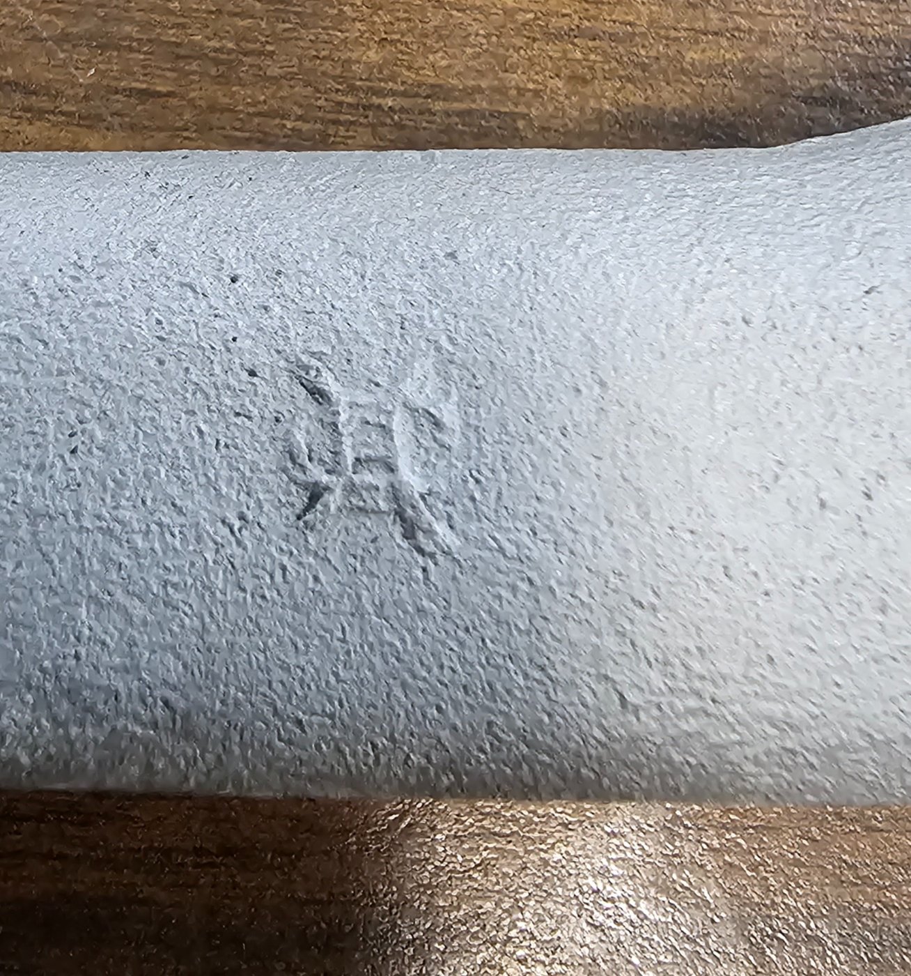

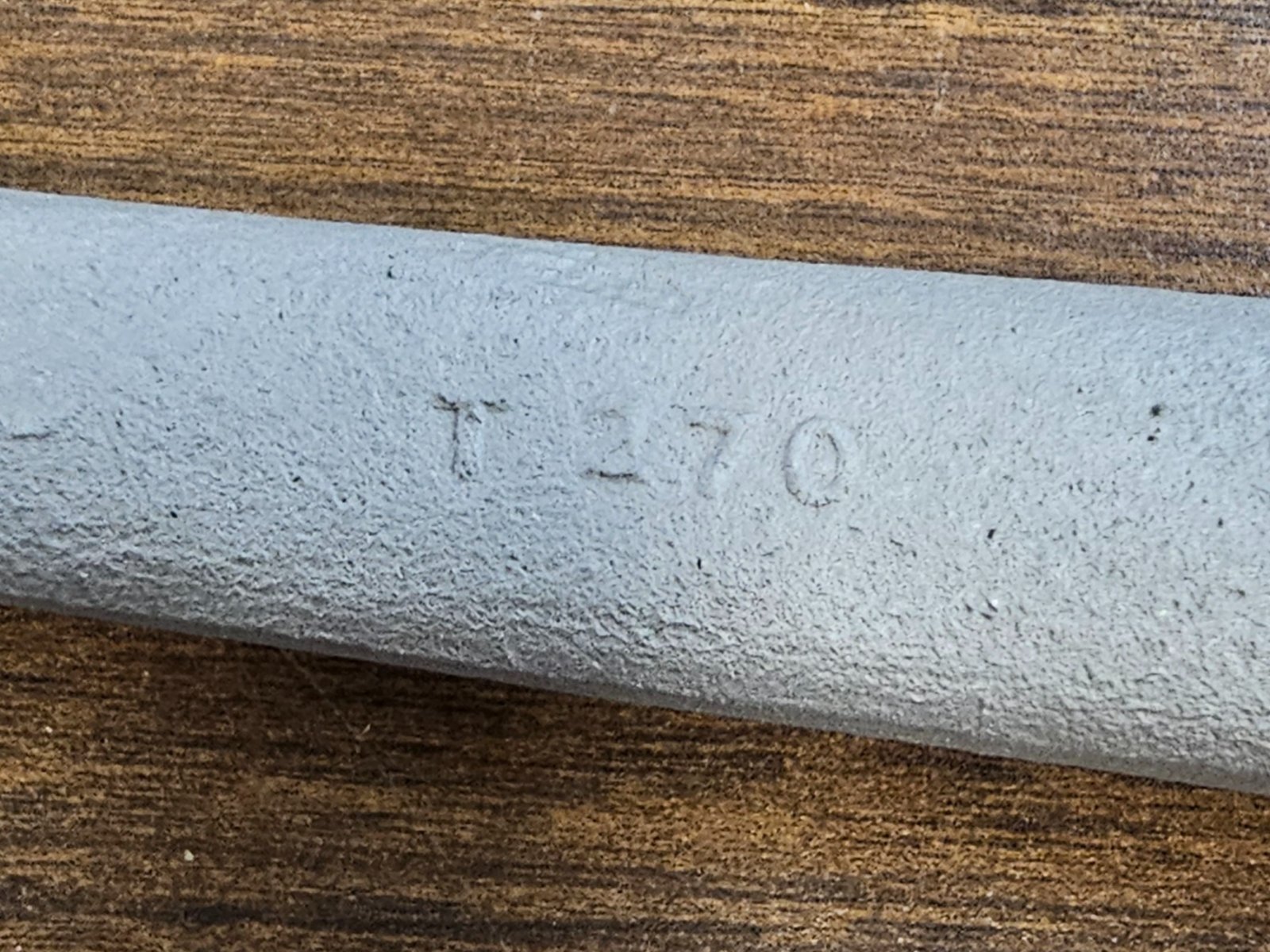

The right side is correct and has the hole for speedo. The left side has the wrong spindle and spindle arm.
Here is a picture of the arm. Car was built mid Oct. Just try to get it close to correct since I have 2 parts to choose from.

Tim, the C over H mark was common on the forgings on my Canadian sourced 1915 model T. It was suggested it was forged by Cleveland hardware. The TW mark is likely earlier, a Transue Williams forging. As far as I know, they are interchangeable, so unless you are anal about such details, there should be no problem in using either, and swapping it out at a later date.
