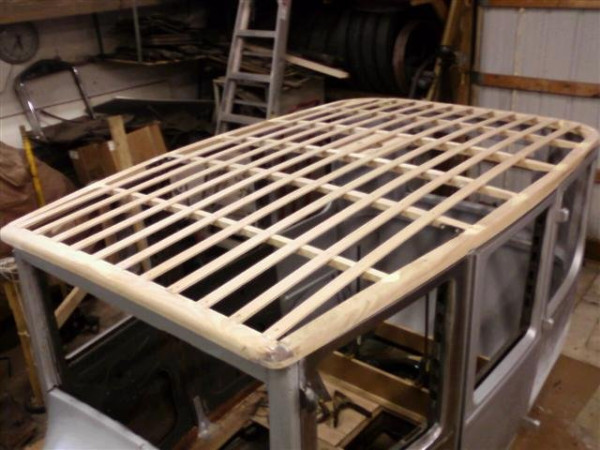

Some pic's....

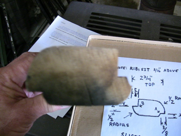

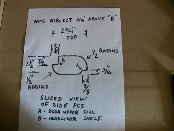

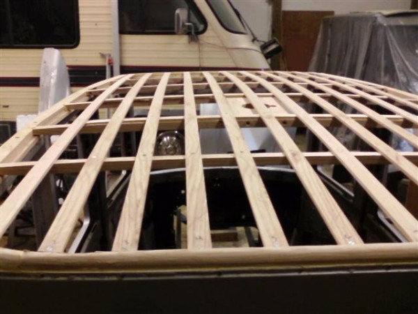

Some more...

Thanks . That is quite helpful

The roof profile that you sent is different from my car in that yours is 1.5” thick and what I have is just 1” . Also yours has a rounded relief edge on the outside bottom where the body panels would tack on . Mine does not have that detail. Does having that detail allow for better rain protection? I am about to tackle the roof and wanting to do it correctly. My car is a 1926 fordoor.
Any advice is appreciated
