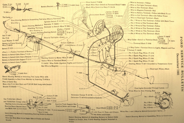

Does anyone have a wiring diagram for where the wires are supposed to be on a 24 coupe? I'd like to restore their placement properly. I have a great wiring diagram for which wires go to which part etc, but am sturggling to find a diagram of where they go on the vehicle itself.

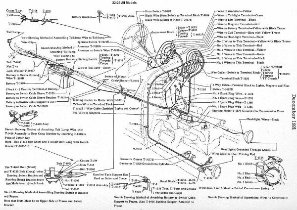

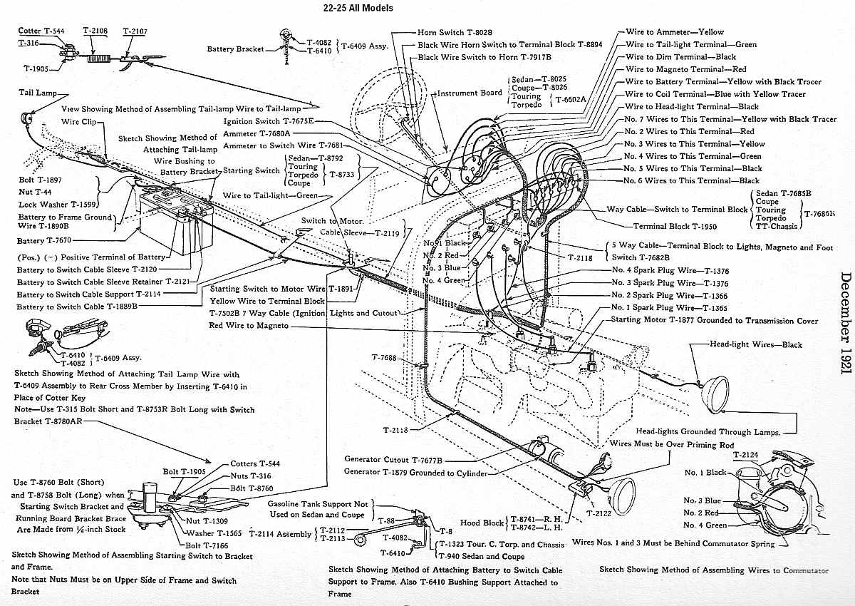

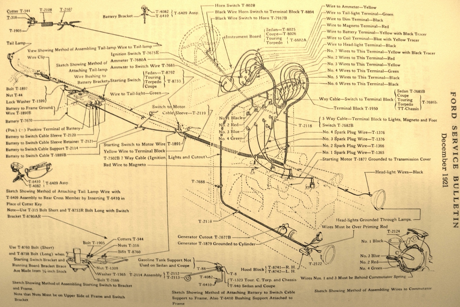

This is the one for '21-'25 chassis with starter, generator and storage battery. Only difference is the high cowl wiring loom to the terminal block on the firewall has the switch loom hole above the terminal block.
Click on image to enlarge.

Thank you so much!jiminbartow wrote: ↑Sat Oct 21, 2023 5:05 pmHere is a bigger copy. Easier to read:
www.mtfca.com/discus/messages/411944/41 ... 1390100844
