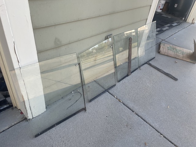

Where they got stuck is getting the windows to close. Two windows are missing and the other 4 are mixed up. The curves on top do not match the roof profile. I have to remove the installed ones and measure everything. The glass specs book will tell me if the existing glass is even cut correctly.

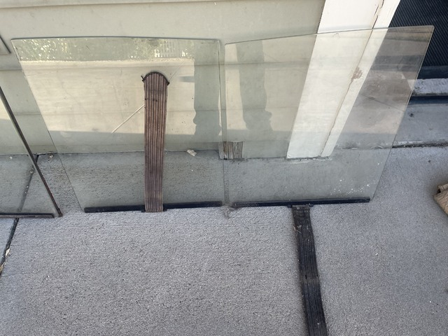

But, When I bought a Touring car it came with some extra parts. See below. I have two windows, with glass, that I think are for the rear center door windows. Still have the original straps. If interested, let me know.

Nobody reproduces the original felt glass channels. That takes a specific industrial sewing machine.
You’ll need to use the available metal/felt channels. I was going to see if I could re-use my originals but I can’t because the thread is rotten.
The metal channels at the bottom of the glass will need to come from glass from another car as they aren’t reproduced either.

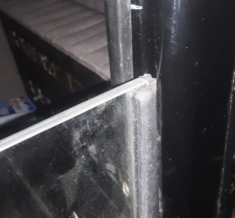

The replacement window side seals that someone installed is glued to the glass with a soft seal with a tough outer shell so that it does not wear out sliding up and down the wood channels. It is not like any of the normal window felts I have ever seen. Looking at Snyders (and others) nothing strikes me and says it will work. Do you have a suggestion to which one might work?
I have an industrial sewing machine but not sure if what I have is a good sample or not.

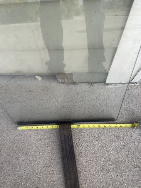

The window glass bottom channel is length matched to the size of the window. On mine the front, door and back are different sizes.
The 2 that I am missing are somewhere about 17 1/4" long.
Rich - What size are the ones you have?
I am pretty sure my extra windows are rears. See below, channel is about 18 3/4 inches. Don't think they are what you are looking for.

This is the stitch that the original felts used. I’m not exactly sure the technical name for the stitch. The stitch itself causes the felt to be sewn at a 90 degree angle. It appears to be one piece that has had two 45 degree pie pieces cut and then the machine folds it and stitches to make a channel. AFAIK there is no machine on the market today that does this.

That original seal is very interesting, How and where is it supposed to be fastened?
The glass goes up and down plus in and out during normal operation. Quite different from normal car windows.
It is nothing like what is on the other windows of the car.
And I can not find a match to what the other windows used, not that they fit properly anyway.
One answer leads to lots more questions.
I have more research to do and maybe someone will chime in with a "This Works Good"
The original seals look they were done on a serger or hemming machine machine, which I do not have.

It definitely appears to be a overlock stitch.
The felt seal I showed goes down each side of the pillars for the glass to ride in. It was attached with a large nail top and bottom. There was nothing remaining in my window headers for sealing.
