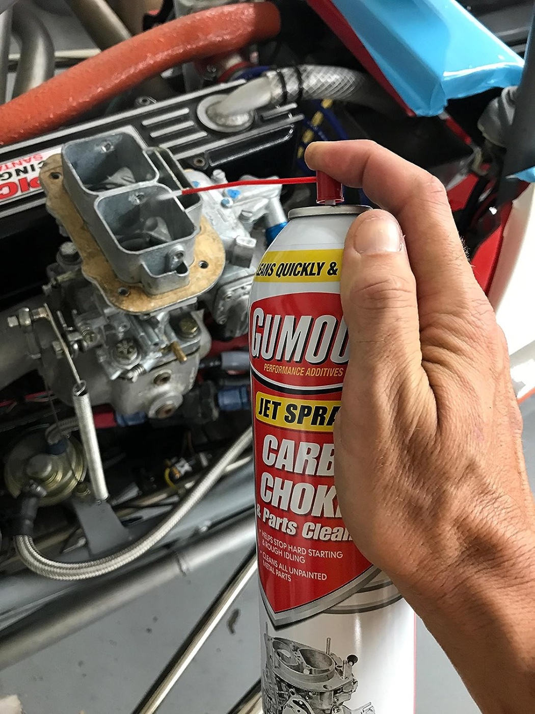

I have always had good luck with the spray type, Xylene based aerosol cleaners with the red small tube that allows for high pressure spraying into the passageways. “Gumout” is a good example but there are all types of brands which work equally well. Jim Patrick

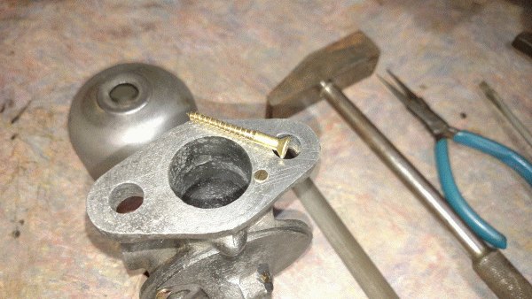

AndyClary wrote:
Wed Nov 01, 2023 9:18 am
You can plug the passages back up with soft brass like brazing rod.
Andy
I did not have brazing rod but my hardware store had brass screws. I cut pieces from the screw shank.
