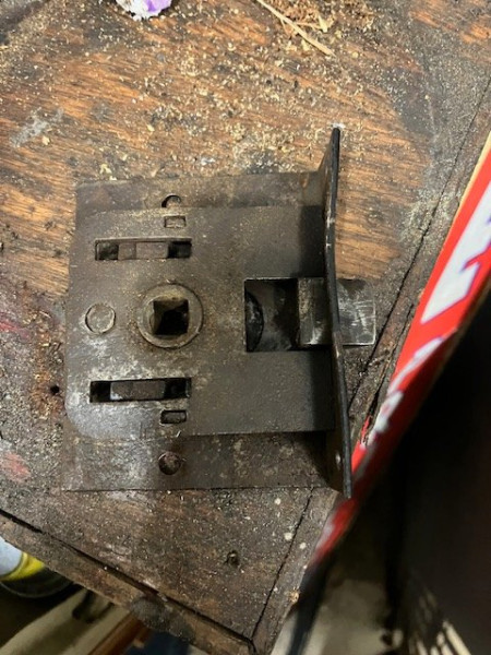

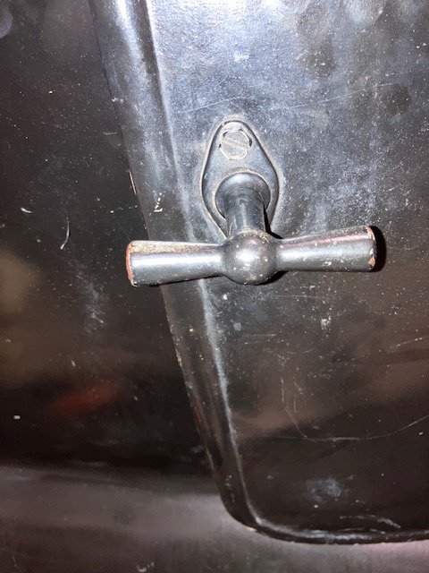

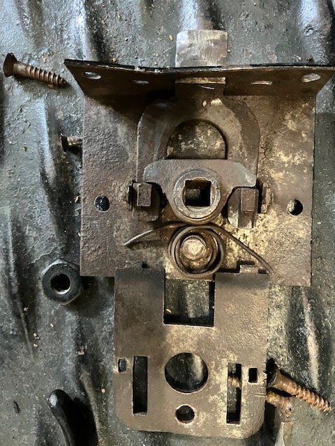

Hello all, my 1922 touring rear door latch recoil spring broke. Now the latch will not recoil so it does not work. This is I think a period but non-Ford 3rd party latch because it has a handle on both sides. Unfortunately, the post that holds the spring is peened onto the latch. Any suggestions for salvaging this? The two other latches are the same as this one so it was probably changed at some time in the cars history. I can make out ...Mersick co, Newhaven, Conn. It is probably The English & Mersick Co. New Haven, Conn? No patent number that I can see. So far, I cannot find a similar example anywhere online. They did make carriage latches and have latch patents. I would be obliged if anyone could help me to salvage this lock. You can see the loose broken spring in the picture of the mechanism as it looks removed from the door. Other than the spring the latch is in good used condition.

Ignacio - what does the other side if the riveted post look like ?
Looks like the riveting is upset into a counter-sink in the plate (?)
Depending upon how the post is attached to the other side of the lock plate, it may be best to pare down the riveting with an end mill then build the post back by welding and re-rivet.

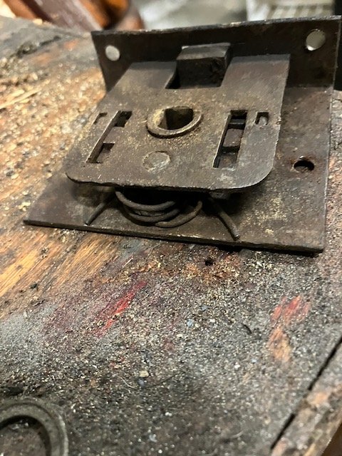

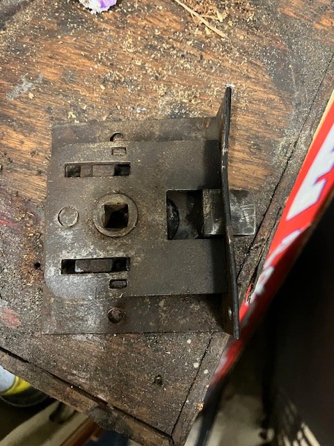

Thanks, I just hammered it with a punch and it came off. See picture. Yes, probably just put the rivet back through and spot weld. The spring will be in the mail tomorrow. So cool this thing is probably 100 years old and apparently very unique to my car. Many thanks!

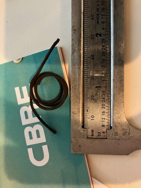

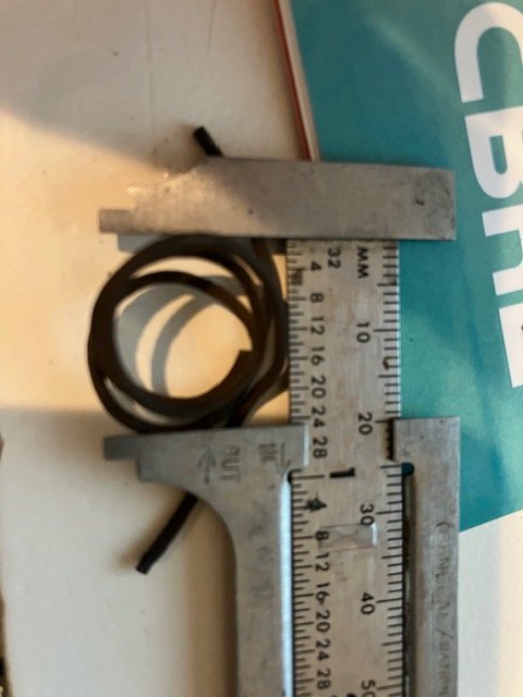

I measured it and it is a 3 coils, wire thickness is 0.06575, 2 inch total distance, 0.8125 coil OD. See pictures. I was contacted privately and guided on how to measure these, then shown this website
Lee Spring:
LTMR150X05
put that into "search" and you'll get 2 springs that are darn near exactly what you need
here: https://www.leespring.com/torsion-sprin ... LTMR150X05

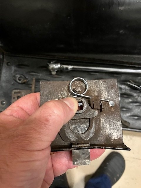

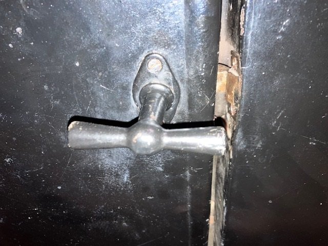

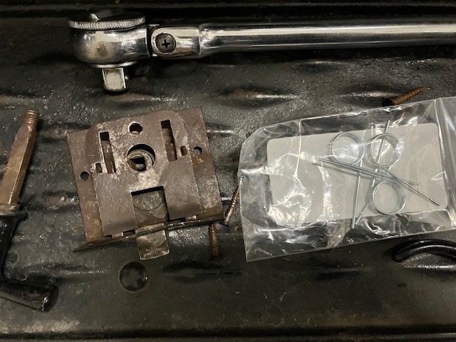

We are back in business. See pictures. The springs arrived from Lee's and are perfect. I cut them to size and installed them. Held it together manually then spot welded the rivet back on and re-installed it. It is very stiff now and is not going to fly open anymore. I have extras if the other 2 latches fail. Cool to be able to salvage unique probably 100 year old latches. I can take it to church again today. Thanks to all who helped.
