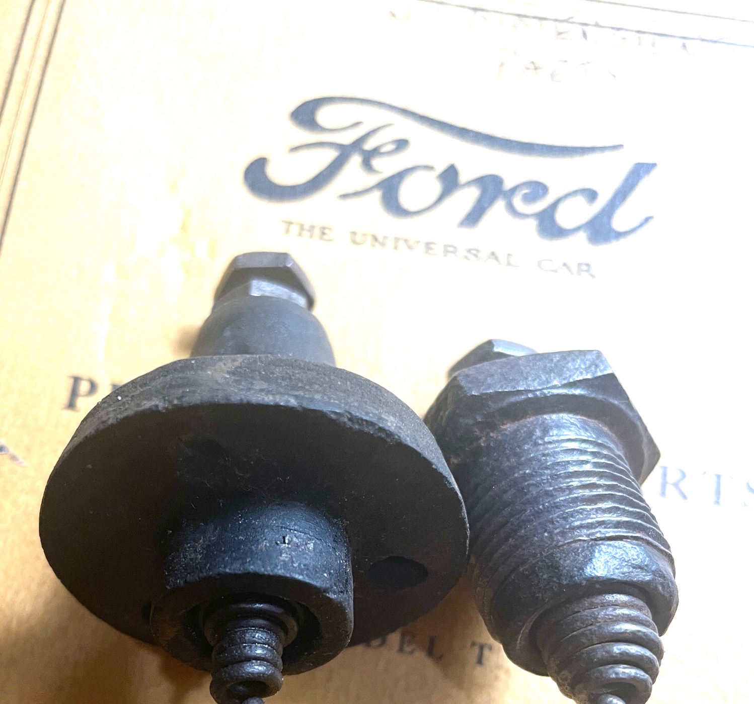

Generally about the same, approx. a .740" opening, in the hogshead, the early mag post insulator is about the same o.d. as the threaded Improved Car mag post.

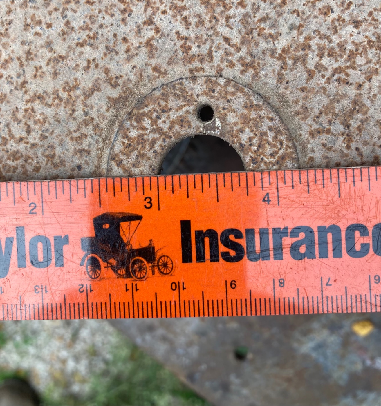

The question made me wonder too.
So here’s a pic of a 19-25 transmission cover from my T parts stash. It’s really close to 3/4” .
If I could find the 26-27 mag post I have it would interesting to know if it would go directly in the older cover even though it’s threaded. Was it a change for the better because it was threaded or??

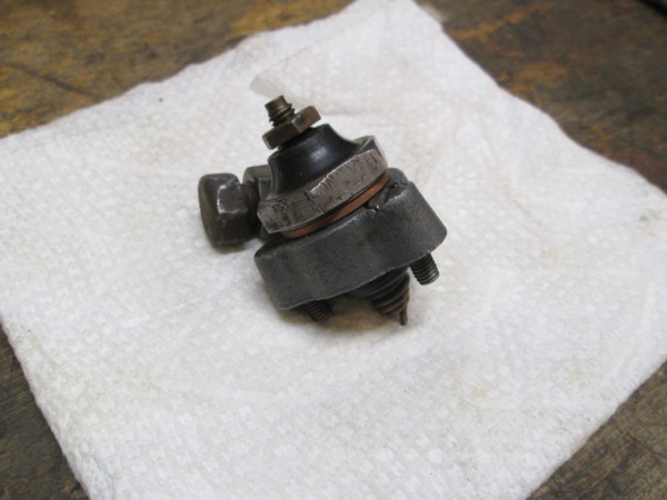

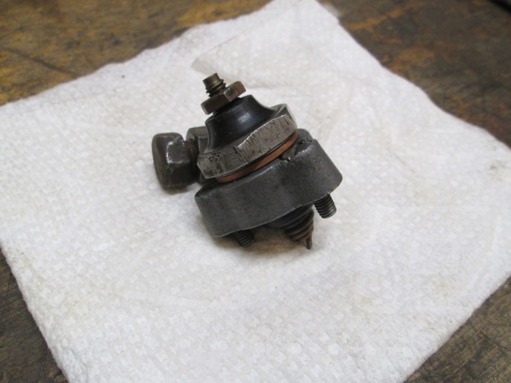

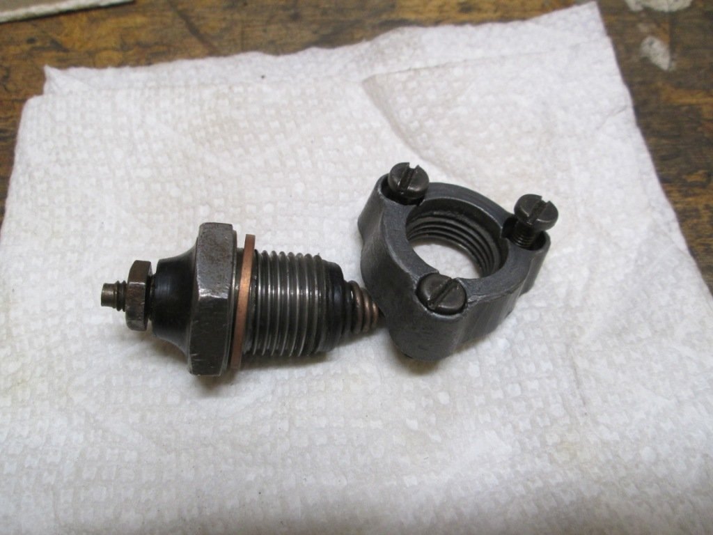

There was an adapter available back in the day to use the threaded mag. plug onto an earlier trans. cover - I'll get a photo later.
Posts: 5489
Re: Size of hogshead magneto post opening '09-'25
Post by RajoRacer » Mon Nov 13, 2023 7:47 pm
I believe this might be a Ford part - I'd have to scout out the later price list of parts. I also have a NOS in the box "Easy2Kleen" accessory magneto contact similar to the one in the photos - I didn't get it out of the showcase ! This type of contact was way easier to remove & clean !
