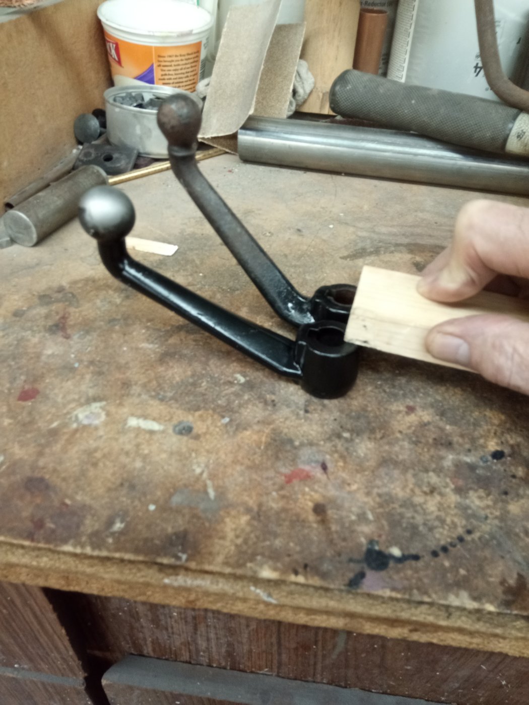

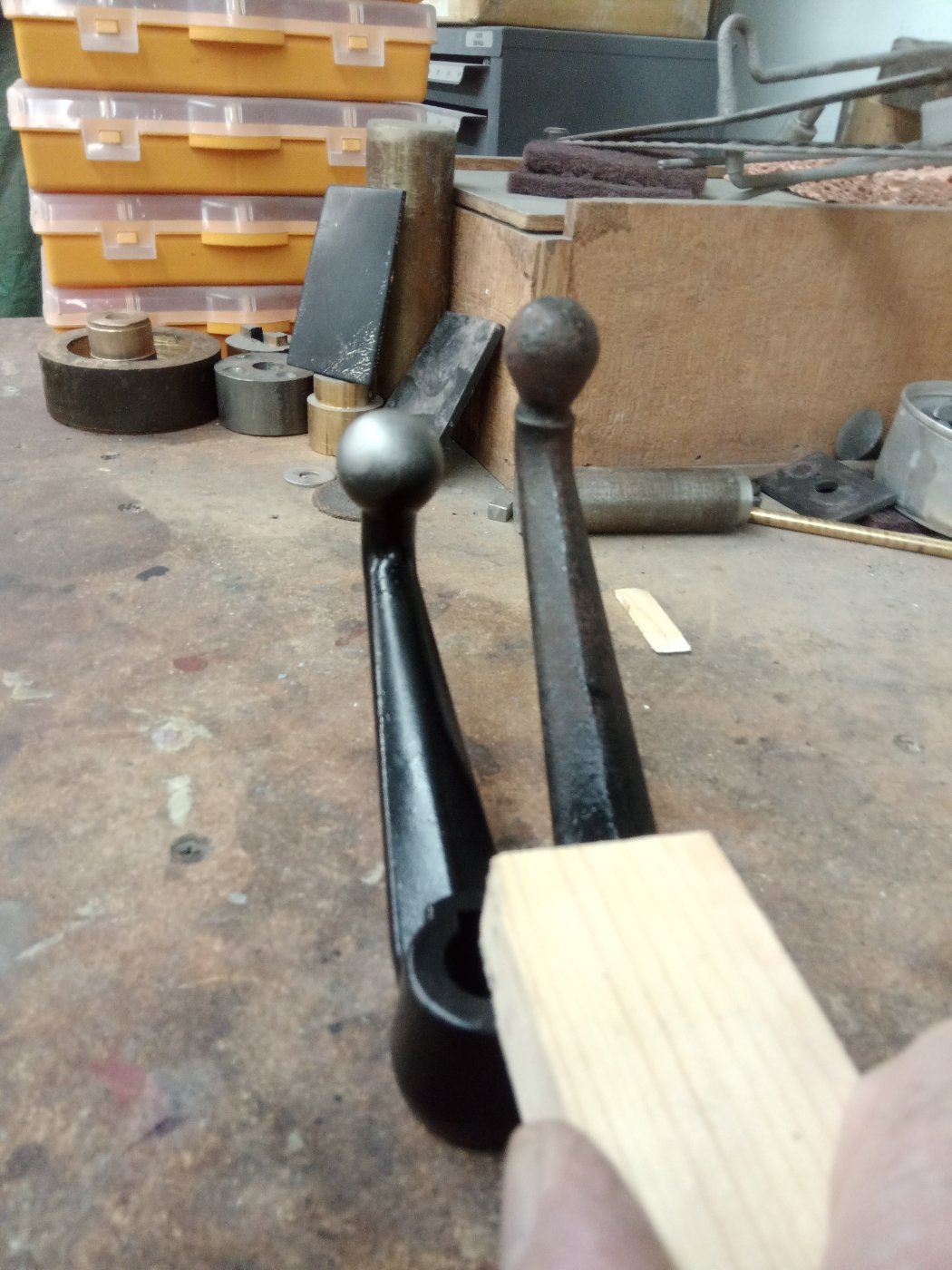

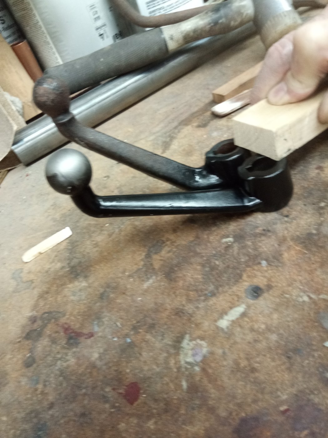

The pictures are of 2 pitman arms I have. The short on is a repro and a very good looking one at that. The long one came off my 1914 steering column. The short one is the same as the one I have on my 1915. I checked the parts books and the same part number is used from 13 through 26 and appears to be the short one. Does anyone know what I have here and even if the long one is even a model T Ford? The ball on the short on is 1” and the ball on the short one appears to be 7/8”
Thank you, Craig

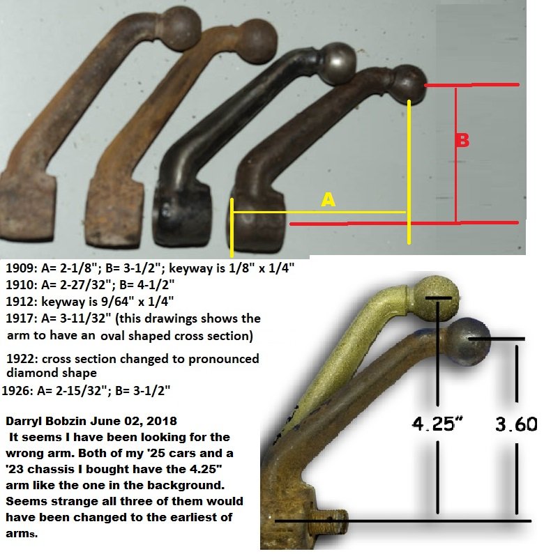

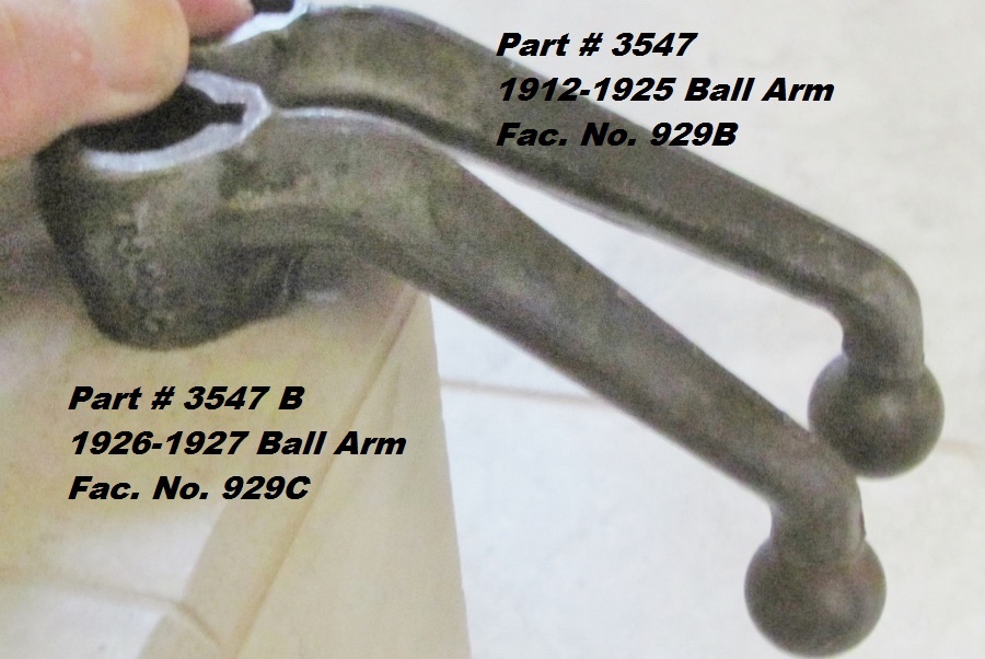

Post by DanTreace » Tue Nov 14, 2023 10:35 pm
This comparison may help, the ball on your used one is rather worn to egg shape.

Re: Looking for Pitman arm information
Post by Craig E. Luton » Wed Nov 15, 2023 10:39 pm
Looks like I have a 26/27 pitman arm on a 13/14 steering column, interesting.
thank you for your reply. Craig

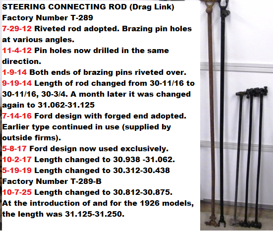

From the Forum
Drag link.png (162.23 KiB) Viewed 825 times
