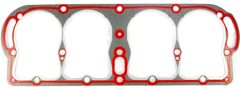

"Premium silicone head gasket. This head gasket has a solid steel core inside heavy-duty high density gasket material coated with silicone and high temperature silicone around all water passages. Install with NO additional sealants. This will not work with "Z" high compression heads part 3001H-14 or 3001HCH."

It has to do with where the fire ring crimp is on the head side of the head gasket.., it may prematurely fail.

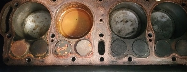

I have one hanging on a nail in the barn to show where the seal let loose.

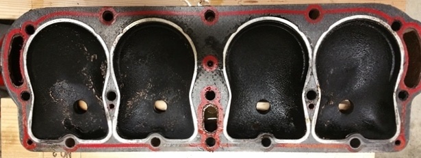

The failures on Z heads may be due to the inconsistent shape of the combustion chambers. Some gaskets fit well, others reveal work needed to match the chambers to the gasket. Prus heads seem to be far more precisely cast.

".Joe you said you have one hanging on a nail to remind you. Was that with a Z head? do you have picks? In my infancy with model
T's I used them and don't remember ever having trouble with them other than they are a pain to clean off when you remove the head for other
repairs."
Craig.
These pics came off the forum a time ago. IMO the tiny bead of silicone can't really be relied upon for combustion sealing and water port sealing, there is only a very small thin narrow bead of silicone. And IMO, but never used one, think this modern silicone bead gasket is stiff and can't compress like the sandwich copper clad gaskets. The squish of a gasket when torqued, and with a good sealant on both sides the copper clad gasket insures best safety and long use. Of course proper sequences to compress from the center of the head and out to sides and ends helps to reduce failure between the cylinders where gap is tiny.
Seems failure in this example is with the water ports, where seal of tiny ring of silicone was imperfect, and water invaded a cylinder. Z- type head, but think this is more like the Ricardo head, with that compression chamber ridge.
