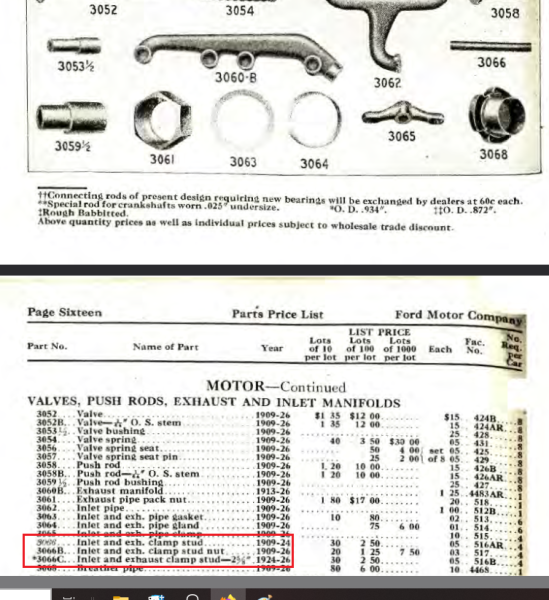

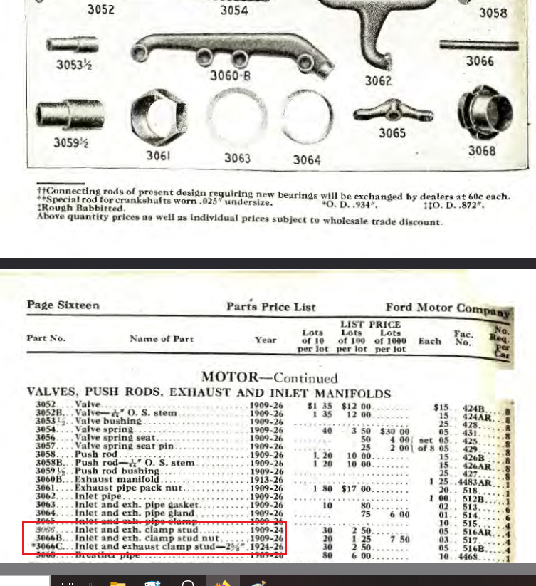

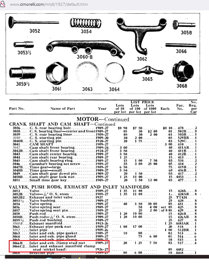

Post by TRDxB2 » Wed Dec 27, 2023 3:53 pm
Parts books suggest 1926 were studs & 1927 were nickle head bolts. BUT 1926 could be/were replaced with the later version
