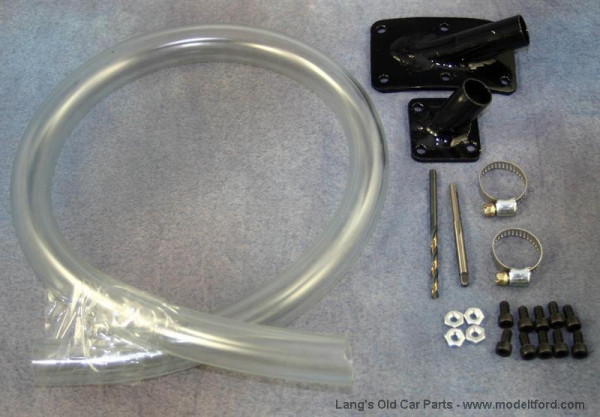

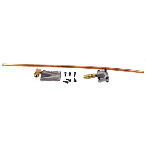

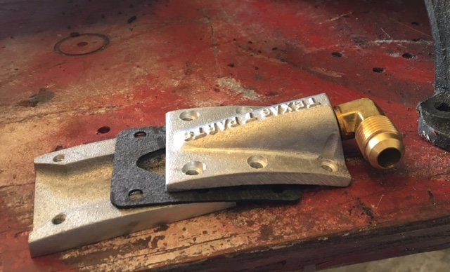

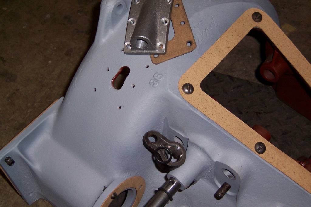

You can get the entire unit from Snyder’s for $83.00 and from Lang’s for $107.00. The first picture, with the copper tube is from Snyder’s. The second photo with the clear tube is from Lang’s. Jim Patrick

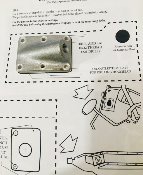

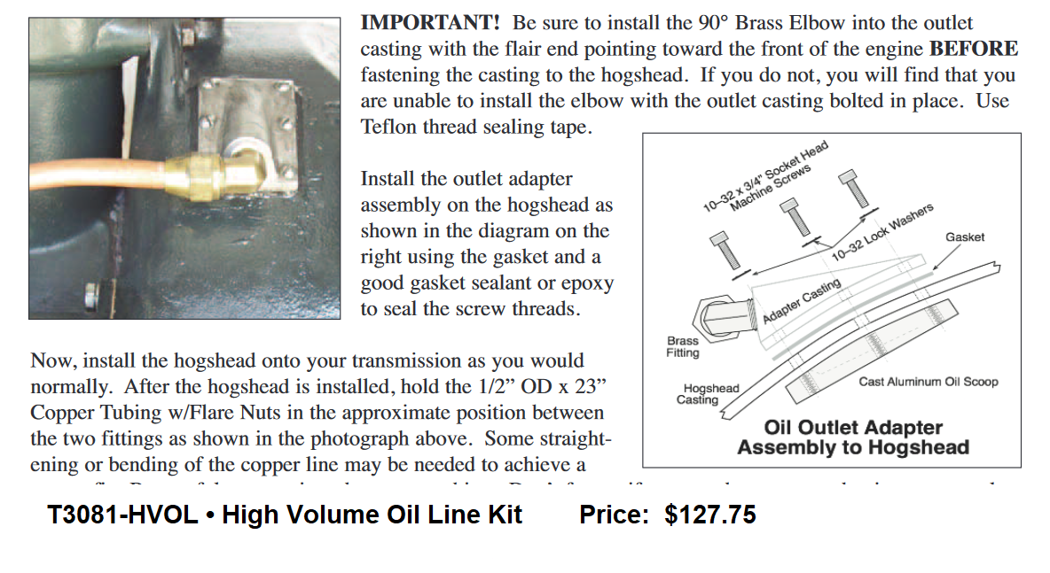

There may be two versions og the high volume outside oiler. I know that he made the castings for these and many other popular accessories (sold all inventory to Snyder's except the molds) - was still making vintage (rat rod) speedsters this past summer
So Lang's & Snyder's may be selling his versions/.
Texas T's version shows both the adapter casting & underside scoop.
https://www.mtfca.com/discus/messages/7 ... 1488771789
T3081-HVOL.pdf
(599.04 KiB) Downloaded 86 times

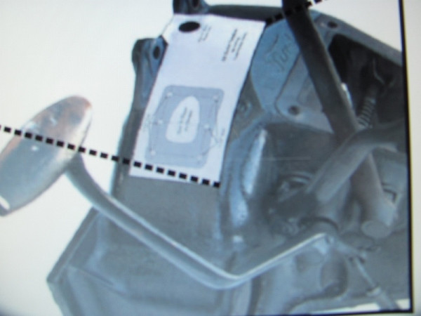

Bryant... Weren't there detailed installation instructions with your purchase?.... Instructions will outline placement of the hogshead pickup bracket... Be sure to use the 3/8 diameter steel line with the neck style connectors to help save oil burning in number one cylinder.

I see now it may have been missing. I was thinking maybe there was a template. Any ideas where to get one?

Here is the link to Texas T Parts Hi Flow, the template is on the last pages.
PDF file:
http://www.texastparts.com/mm5/manuals/T3081-HVOL.pdf

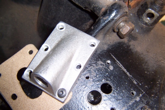

Here's where I placed mine on a '26 hogshead.
100_0441 (550x367).jpg (113.6 KiB) Viewed 3702 times
No defector under, so no nuts for loose parts either. Tapped the hogshead and used machine screws to fasten, made a gasket to fit too, along with gasket cement.

Snyder's usually includes the instructions for download when looking at the product details. Texas T does also
Here are the instructions for Snyders' version --
I also include Texas T instructions above, here they are again
T3081-HVOL.pdf
(599.04 KiB) Downloaded 83 times

Thanks! After a few try’s with the print size I believe I have a match for a good template
