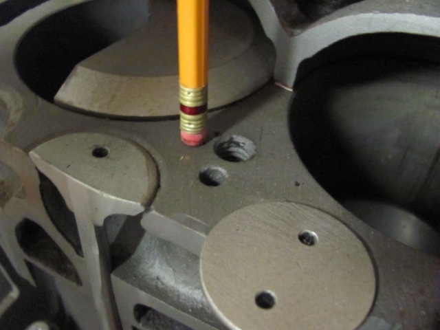

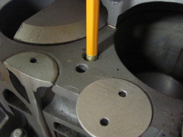

The stainless steel washers on the alum heads,(to prevent galling of the cylinder head by tightening the head bolts), have to be very thin, so don't use a thick one for sure.
And the bolt holes in the block can vary in depth and be sure to clean to the bottom of the hole, compressed air and a pick tool helps.
The new steel head high bolts will work, the short ones are the dome head late '26-27 reproductions, one or two of the block threads may be compromised and the shorter may spin out.
The Ford head bolts only reach a short way, never to the bottom of the hole, therefore only a small amount of threads on the bolt are secured. For that reason, with old bolt threads, don't apply too much torque. Only 35-40 to 45 ft/lbs can do the job of squishing the new gasket and providing the strength to keep the head tight to prevent gasket leaks. The sequence for tightening from the center line of bolts then random out is more important.

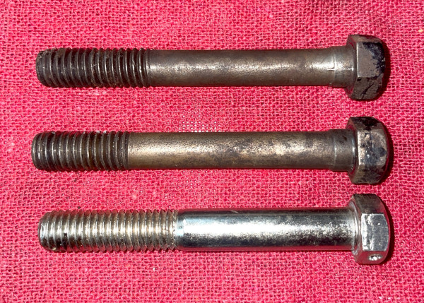

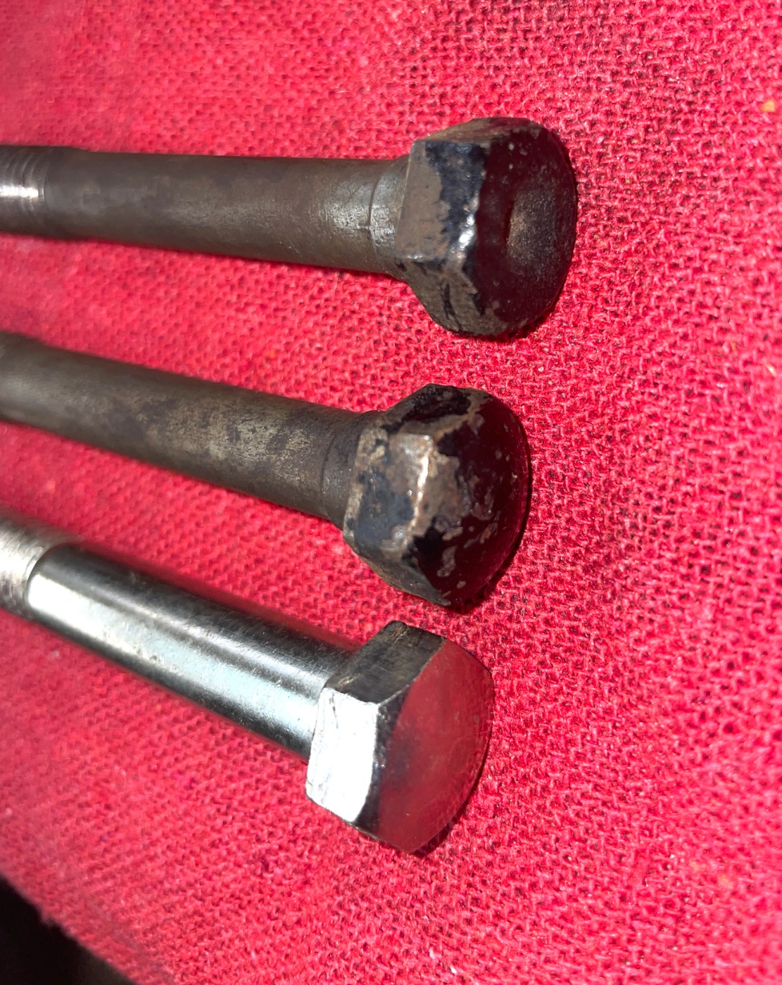

Some more factory data from B. McCalley CD Encyl.:
T-483C2 Cylinder Head Bolt (7/16-14 x 3-9/32”) High Head bolt
12-19-19Adopted
3-29-21 Changed material from CD OH BB heading steel type E to CD CH wire type E.
11-4-21 Limits have been specified on the pitch diameter of threads bringing them up to date with the Bureau of Standards.
6-25-24 Removed pocket from head.
8-4-26 Changed length of threads from 1-1/8 to 3/4”.
8-23-26 Added 3/32 crown to top of head changing overall length from 3-9/16 to 3-21/32,” and specified the head to be polished, copper plated, nickel plated (400 amperes min. per sq. ft.) and color suffed. (sic, probably should be “buffed”). Specified polished surface to withstand 15 hours in 20% salt spray without rusting and removed weight per 1,000 pieces. Also specified for 1927.
From top, early '24 to '19; center 1926-27 crown head, note thread length; bottom repro nickel (s.s) crown (dome) bolt.

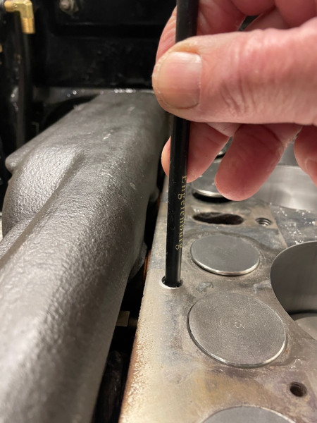

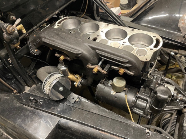

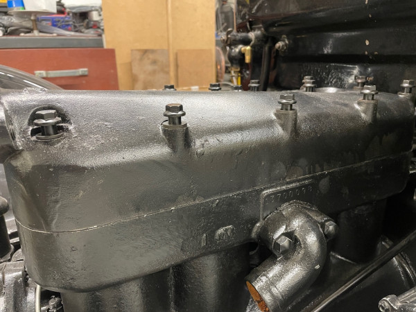

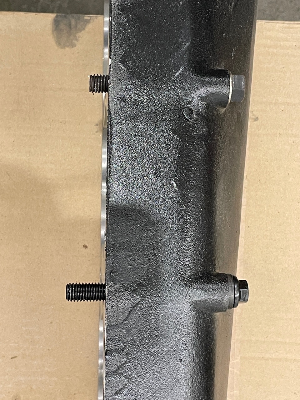

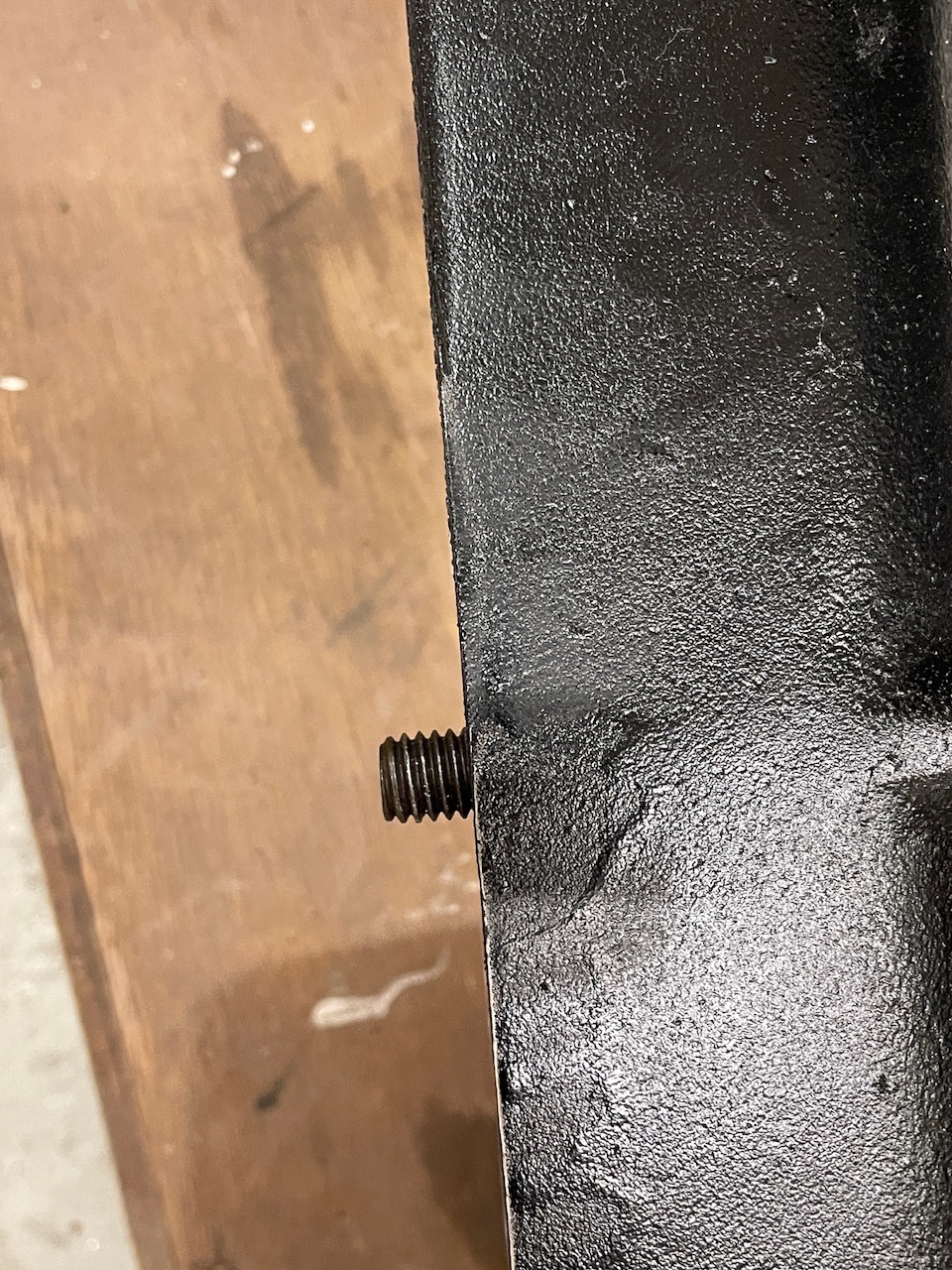

Some pictures.
The one with the protruding thread is without washer, head gasket and coilbox. It will never be more then that.

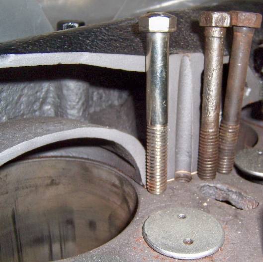

I just received the longer bolts. I would qualify them with “very strong (grade 8+), perfect body, ugly head”. So technically its OK, the looks neef improvement. I think of making a cap in 5/8.
- Posts: 4090
Re: Head bolts
Lex
A longer length in a harder bolt may be ok to use, original Ford were most likely grade 2 and old ones used over and over have been known to break off if stuck.
However….do check each block hole depth…..as they are not all drilled the same depth. They will vary in depth.
You might find such long bolt bottoms out on a less deep block hole, that wrecks the threads in the hole or won’t squeeze and seal the gasket and head completely.

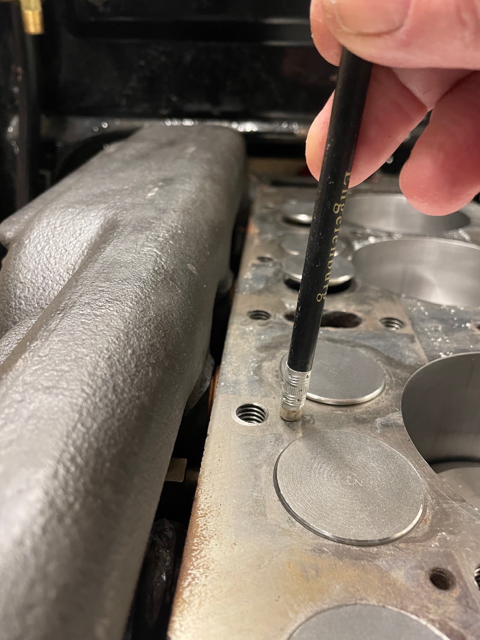

Re: Head bolts
Just what I did. They all go in 5/8 by hand till they bottom out. I shorten the bolts so they just don’t bottom out without the head gasket.
